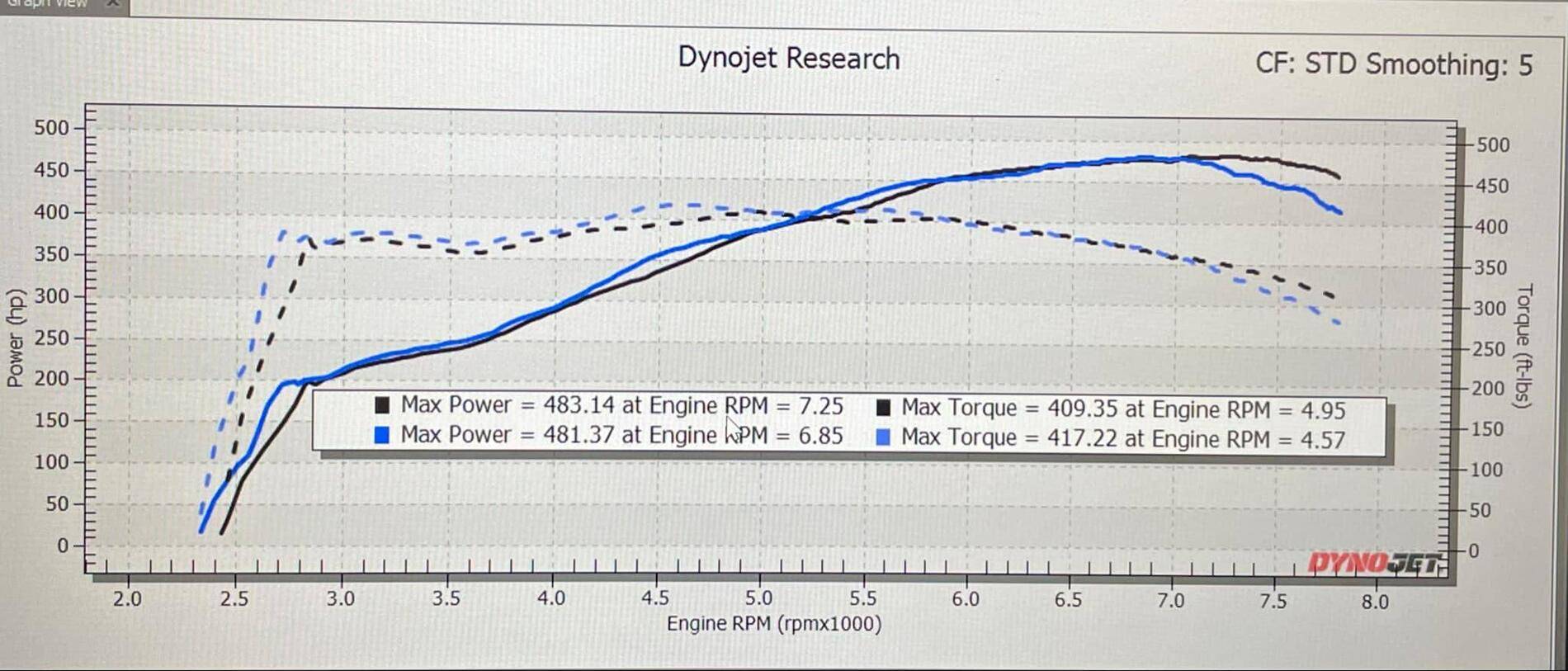

Based on the 650 intake testing Wengerd did on the S550, the S650 intake looks to have a power curve similar to the GT350 intake, so no reason to swap.
These S650 will easily run 10's NA with some Corn Fed RPM's ...

I'll keep the S650 intake and give up a few hundred rpm and save the $2,000+ that CJ setup costs for something else.
Wengerd dyno .... I'd surmise tuning could get power to carry out to 8000.
S650 Mustang Any news on tuning? 1743360056946-ui
