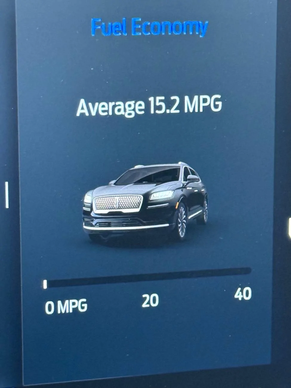

@roket @GrabThatBlue hey. Not sure if it happend to you guys, but when I put the GTD splash screen, it actually changed the fuel economy vehicle to a Lincoln lol. Any way to fix that?
You probably changed a wrong value, there are indeed lines which say (brand) and Lincoln vehicles are mentioned. Make sure you hit the right numbers.
Whatever roket said. 2D and 3E or something. Everything else is a GTD but that.

Yeah. Not sure. If you guys ever find out please let me know
Are you sure you changed the right line?
If you changed this line below with 23 or 2D it will give you a Lincoln.
7D0-02-01 **xx xxxx xx--
Nope. Only the lines roket said. Weird
there are definitely some strange side effects, like the digital owner's manual not working as well. the solution is to just ignore it
Does the asbuilt of your production GTD do the same or does it have different values?
both of them have these values:
7D0-03-0155532D0D09C6
7D0-03-023E0009060029
Since I shared the whole list of the GTD I compared it with. You might compare the lines from the BCM with the one I had changed it to.
726-21-01
726-27-02
726-38-01
726-40-02
If there are differences in these lines, than that might be it. Or the GTD is not programmed to have orange DRL as standard and they just programmed it during some car shows. Just like you said, the one on the nurburgring was driving with the white DRL.
