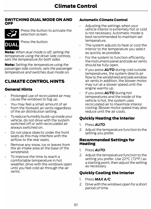

The climate control settings dont save over night. Its not a glitch, that's just not how the car works. Try setting the climate settings to auto when using remote start, it will run the AC or heat depending on ambient temperature. Once in the car use the auto feature for climate after its started. Its pretty easy.

Use the 'auto' setting and it will sort itself out when it needs to. I pressed 'auto' on day 1, set the temperature and have never touched the HVAC system controls since.
Note: The AC will NOT come on below an external temperature of 4C whatever you do, to avoid damage to the system.
