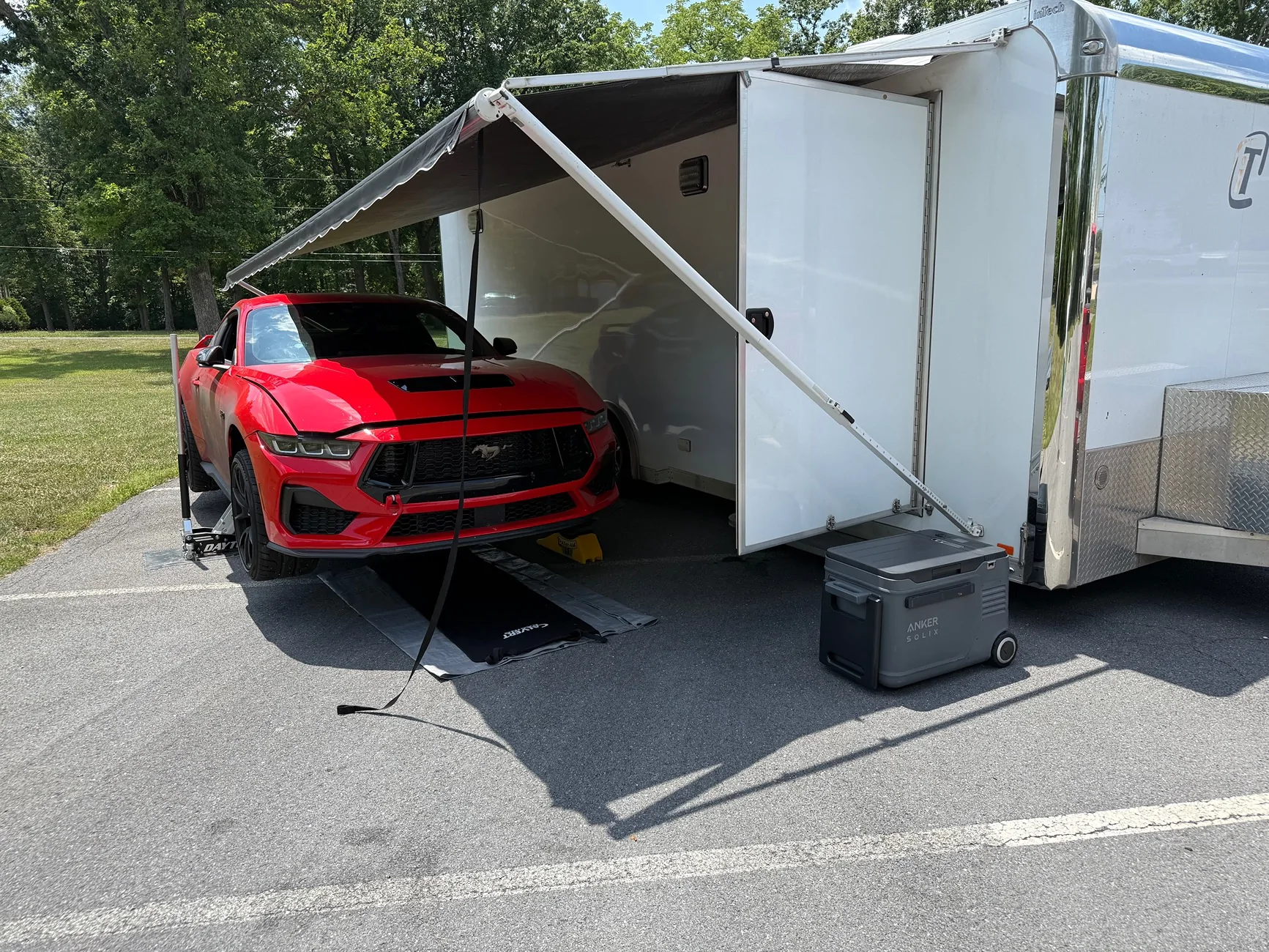

Breakdown - Upon further inspection, I was able to determine that the nipple on the transmission heat exchanger was leaking. It wasn't coming from the hose or any fitting; rather it appeared to be coming directly out of the aluminum, so I assumed there was a tiny crack. After many calls to dealerships around the country, I sourced a heat exchanger in stock at an Alabama dealer, and had them overnight me the part to our next track location. $70 part plus $220 overnight shipping.
Unfortunately, I lost my second scheduled track day at Watkins Glen because I didn’t want to risk having the heat exchanger spring an even bigger leak and dump coolant on the track or damage the car. We packed up and headed down to Summit Point, WV. The part arrived right at noon the following day, and I was able to get permission to use a church’s parking lot to do the replacement. Of course this was probably the hottest day of the year. The temperature hit 99 degrees while I’m laying on the asphalt doing the replacement, which also involves filling and checking the transmission fluid. It was not a fun experience, but a little over seven hours later I finished and confirmed I had no leaks.

You are correct on the heat exchanger. It has two separate passages; one for the engine coolant and one for the transmission fluid. Mine was leaking from the coolant nipple. The coolant heats up a lot more quickly since it is running through the engine, so when the transmission is still cold the coolant warms up the transmission fluid. Once the transmission fluid is hotter than the coolant, the coolant then pulls the heat from the transmission fluid by running through the exchanger. So it is both a cooler and a warmer depending on the temperature of each fluid.
All Mustang automatic transmissions have the heat exchanger. On ones without a separate cooler, the transmission fluid just cycles through the heat exchanger then back into the transmission. The Dark Horse and GT Performance Package have a separate transmission cooler mounted behind the radiator. For these cars the fluid cycles through the heat exchanger, then up to the cooler via a thermal bypass valve which opens once the transmission fluid reaches a certain temperature. So the transmission cooler only receives the fluid once the transmission heats up, but it constantly cycles through the heat exchanger.
