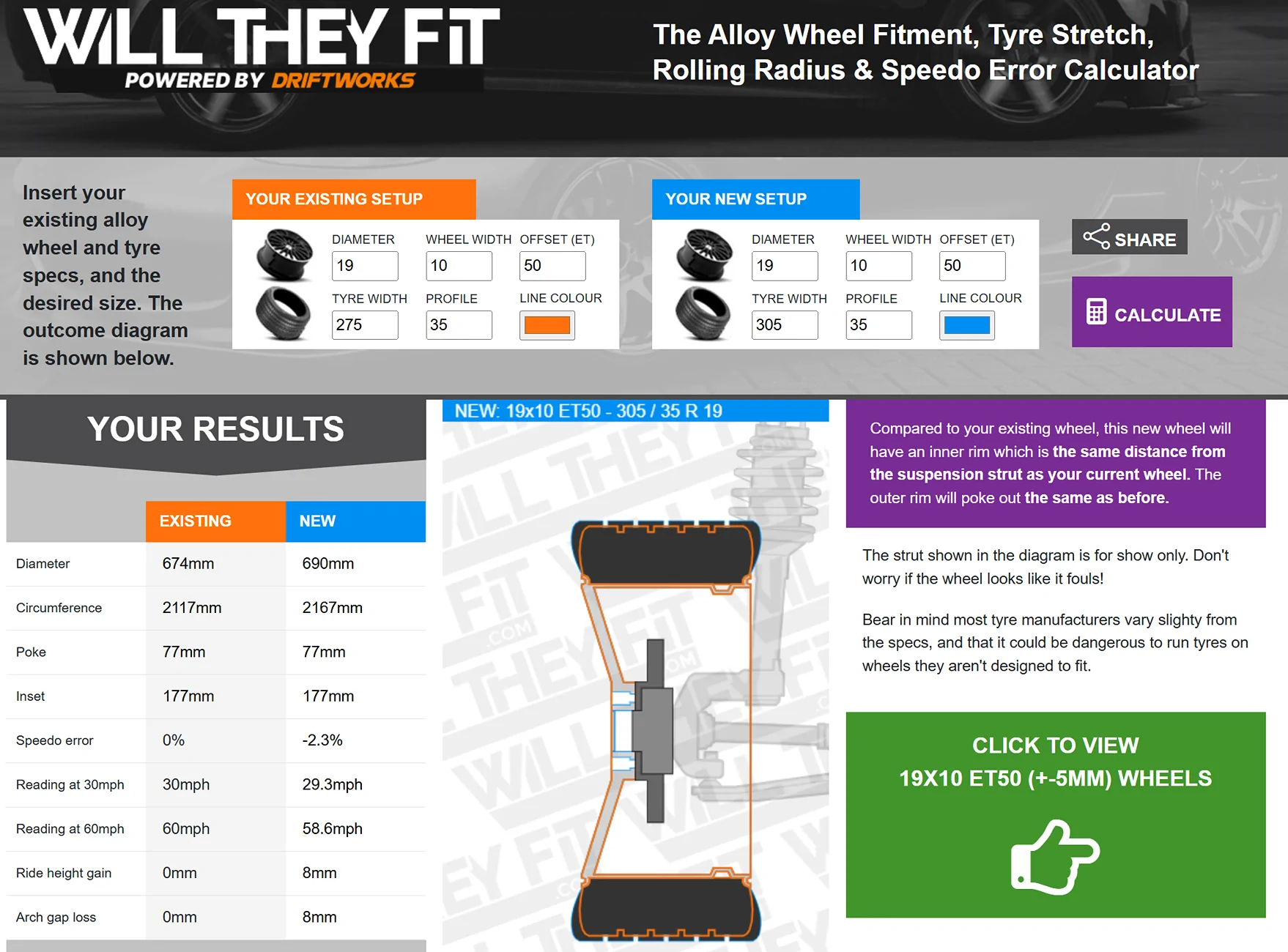

I have 275s on my 10" wheels. I would say that set up is clean and handles well. A 305 would likely require you to push pressures to keep them both on the wheel and prevent feeling squishy in the corners. Between 275 and 305 is ~1.17", which may not seem like much, but adding ~0.59" per side of the wheel (- a bit since height also increasing), is significant.
Per willtheyfit:
S650 Mustang 305/35R19 on a 10” wide wheel? 1772197635139-bg

Height of the 275/40 is 27.7 and the 305/35 is 27.4 so actually less sidewall

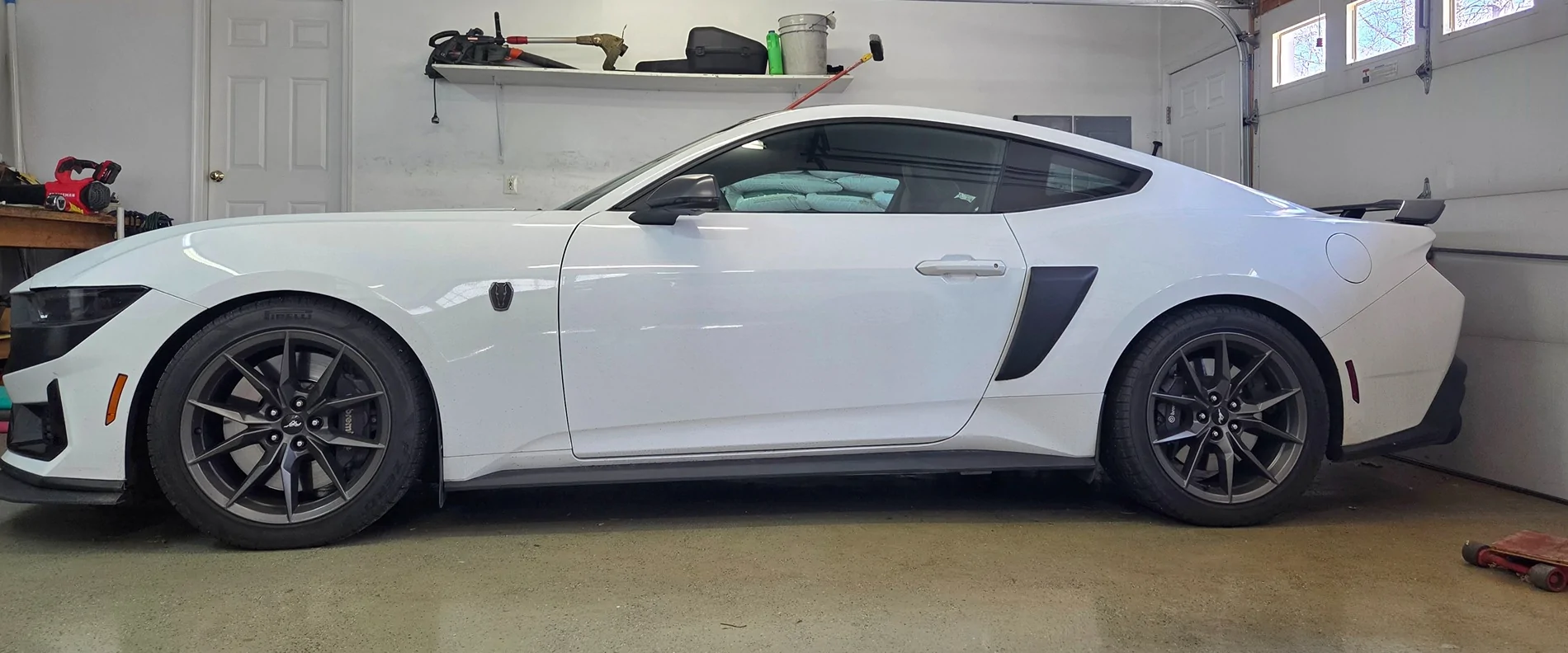

I live in a rural area and drive very aggressive, but no track time yet. I love twisties. Diameter is only twisting.
S650 Mustang 305/35R19 on a 10” wide wheel? 20260227_115855

Looks good, I wonder how it would look if I leave the 255's up front with 305 in rear, to much of a width difference
