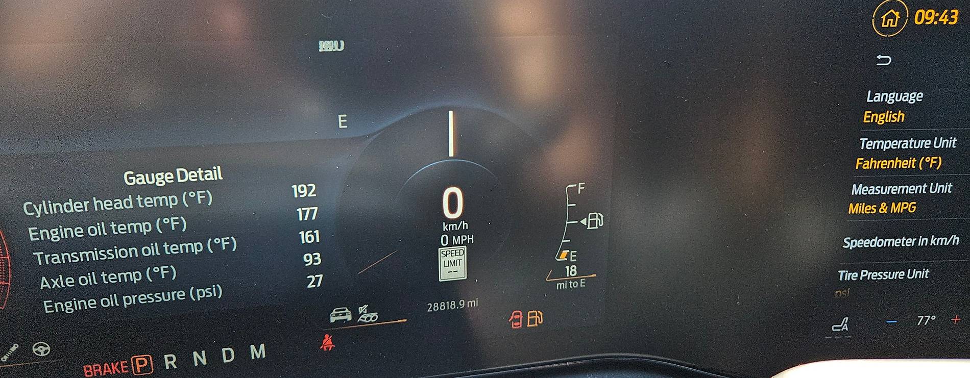

for anyone who was looking to make their Mustang have the 220 MPH/360 km/h speedometer from the GTD/GT500, this thread is going to track that. as of posting this thread (May 1st, 2025), i have tested a 2024 Job 1, 2024 Job 2, 2025 Job 1, and 2025 Job 2. all of which have had the same result; the speedometer's looks change to 220, but it acts like 140. i have seen a video where someone got a 220 speedometer in their Mustang (same guy who supposedly got amber DRLs working), and its probably legit, because it was in km/h and went to 360. if you try this right now on your Mustang, you will see that when you switch it to km/h all the numbers disappear and the needle stays in the center. at this time, it looks like the only way to get it working is to upload the GTD software to your modules.
if you wish to test this yourself, you will need to go into the IPC easy mode menu, search for "style", and change "Virtual Speedometer Style" to the fourth one
Style 1 is 140MPH
Style 2 is 160MPH
Style 3 is 180MPH
Style 4 is 220MPH

a good idea, but no dice
interestingly, the actual property of the 100-220 section filling slower than the rest does work fine. i wonder why the actual speedometer function broke, because it seems like literally every other property from the formatting to the needle movement works perfectly

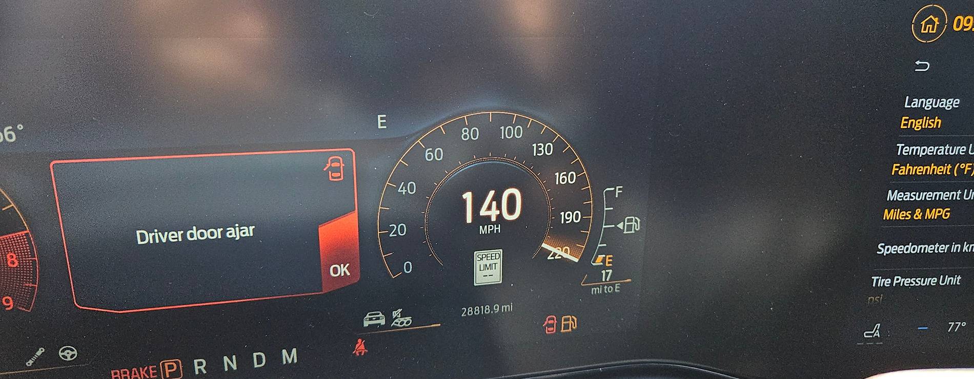

If I'm reading this picture correctly, your door is open, you only have 17 miles of gas left, and you are going 140mph! I must say that is impressive!
And without a seatbelt, while the transmission is put in Park.
This guy is really testing the limits.
