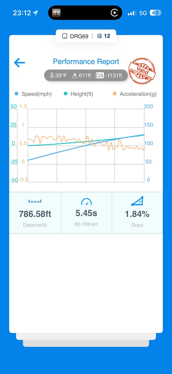

Ran a 5.45 60-130 while data logging. Not bad for going uphill and not the final revision. Also was on Nitto NT05’s. We also pulled the Soler Performance TB’s due to some kind of issue with them. Not sure what the deal is so keeping the factory TB’s installed for the foreseeable future. Anyone know what Soler Performance is willing to do for me? I bought them 4 months ago. They have 400 miles on them.

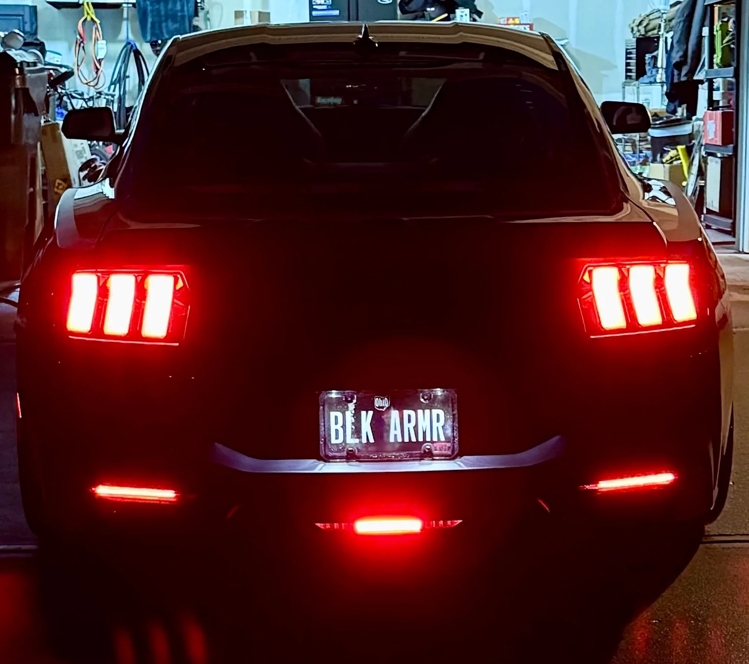

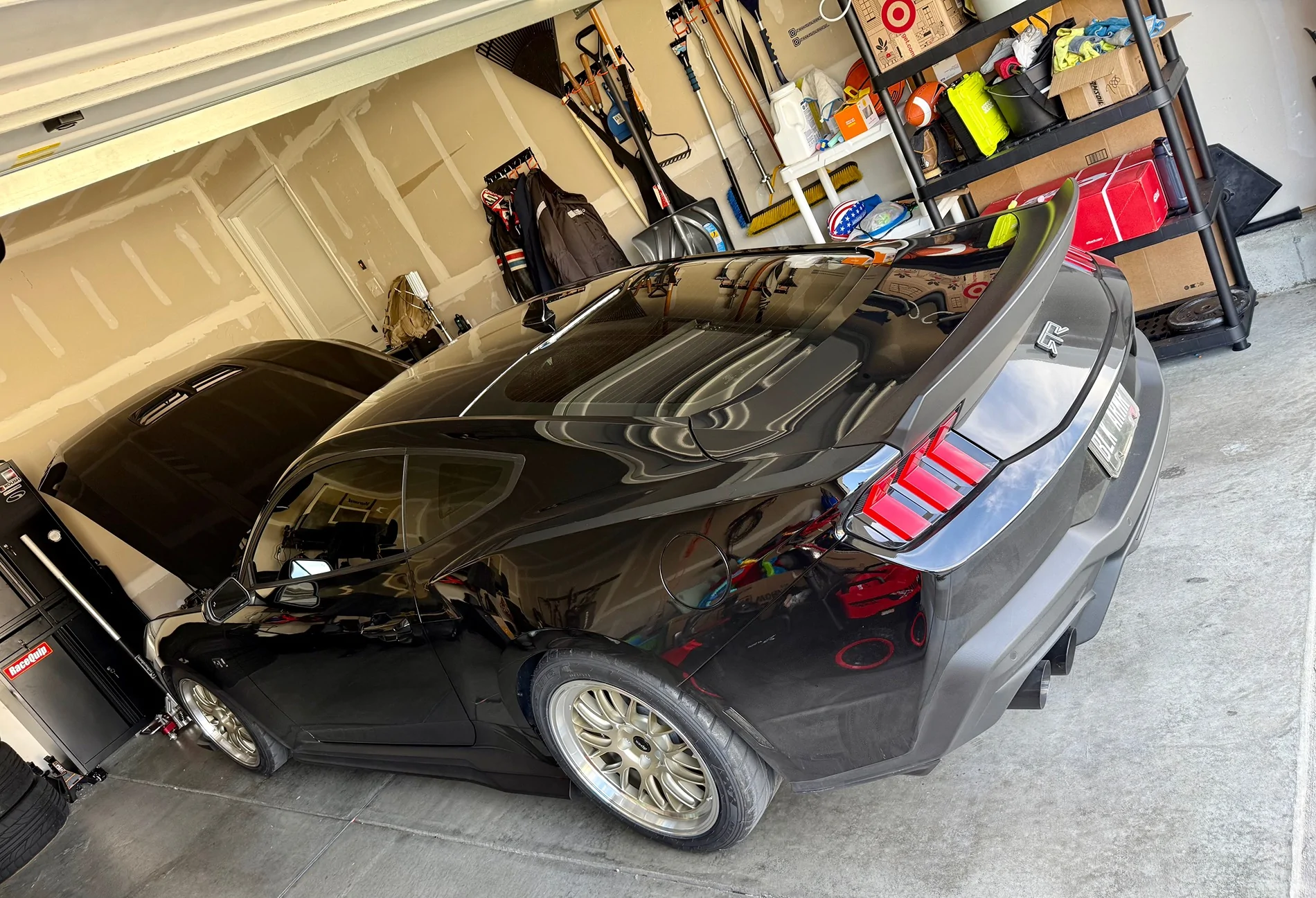

Not sure how I feel about the wheels. Giving me Bandit Trans-Am vibes.
Special shout out to Redline Val on FB for the RTR intake lights blackouts.
It went 60-130 in 786 feet while on a 1.84% grade uphill? Or am I not reading the "distance" part correctly?
