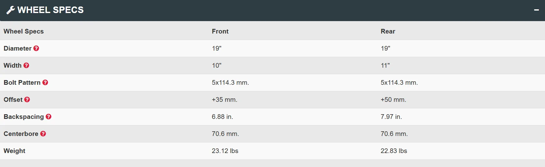

The sizes you listed are THE popular sizes for the Mustang. You will need a 10" wide (about +35 offset) in front and 11" in back (about +50 offset). Any tires in those sizes should fit without rubbing as long as keeping close to those offsets. If you prefer all season tires, 20" gives a better selection for tires.

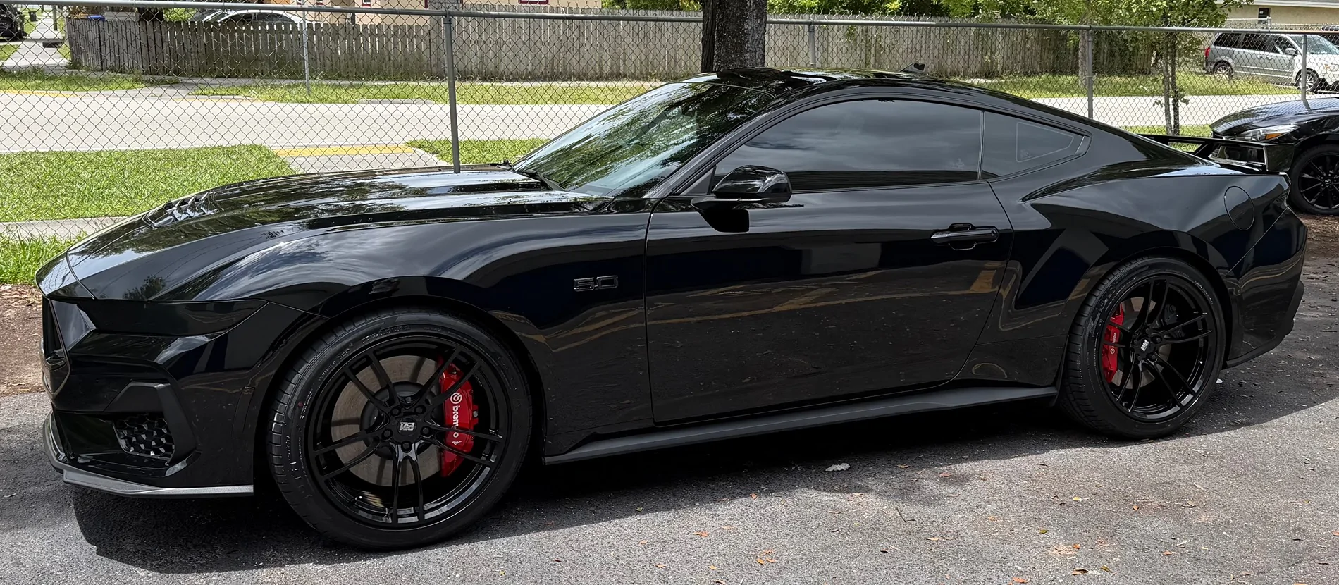

It’s not to everyone’s liking but I always end up doing 10/11 - -> 275/40/20-315/35/20
I’ve had that staggered on Camaros and mustangs for a while. I like the beefy sidewall and 20” tires are a bargain compared to 19.
Also subsequent to this pic I have the RTR chin splitter on now and thankfully the 20” rim makes it so it clears parking bumpers
perhaps not the most performance minded but it’s a daily

Attached are some sizing and offset references that might be of help.
S650 Mustang 2024 Mustang GT, wheel setup 7G wheel offset
