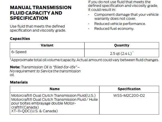

Motorcraft DCT fluid eh? I see that Redline is an addative and doesn't require a direct flush? The Dark Horse manual says you can put DCTF so maybe ask Steeda if they know which adative would be best for the Tremec?

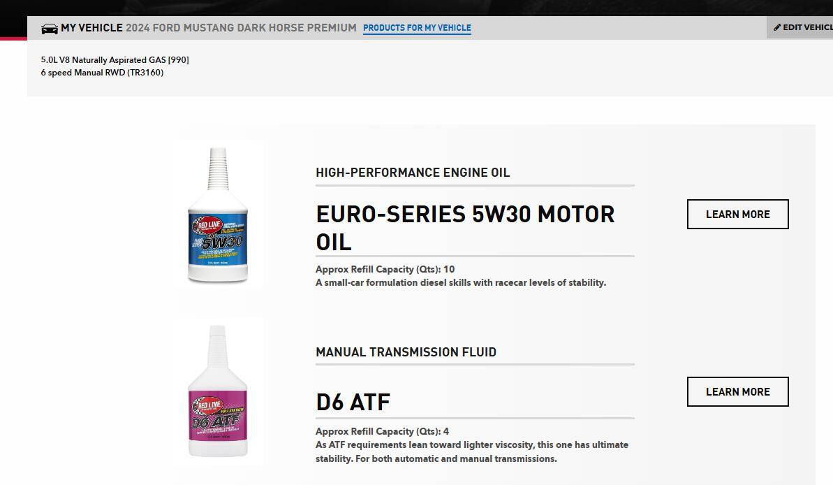

REDLINE has a handy little thing on their site. This is what they recommended.
S650 Mustang 2024 Dark Horse - Slight, intermittent, synchro grind shifting from 2 to 3 at city speeds 1727110374751-v

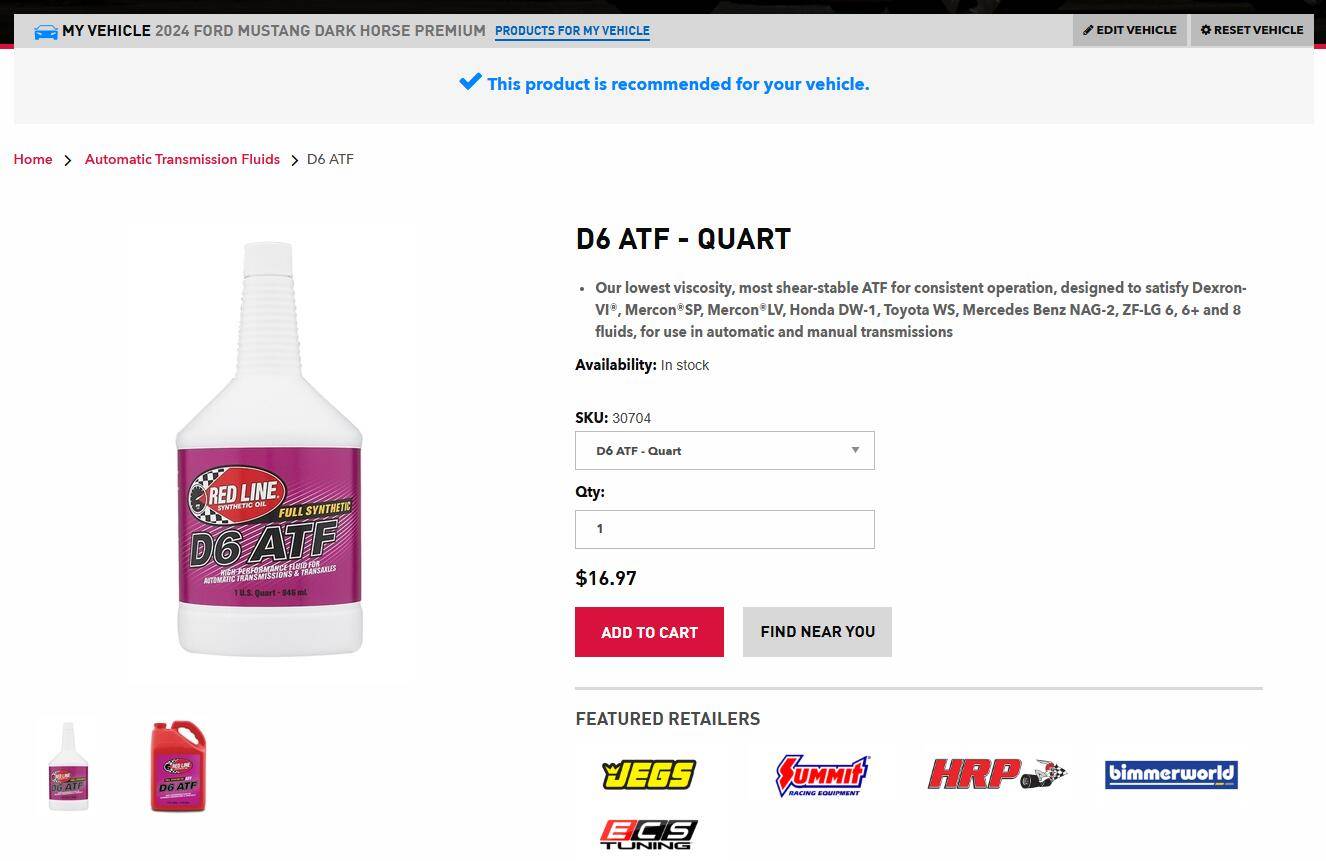

Yes, I did specify that I have a manual LOL
S650 Mustang 2024 Dark Horse - Slight, intermittent, synchro grind shifting from 2 to 3 at city speeds 1727110581989-ek

If you change the fluid, don't go with chart above for fluid quantity. It doesn't take in account the fluid that is in the cooler. Your going to need about 3.5 qts. If you go with the Redline D6 they sell it by the gallon. Got mine from Amazon. I can't emphasize enough what a vast improvement in shifting.
