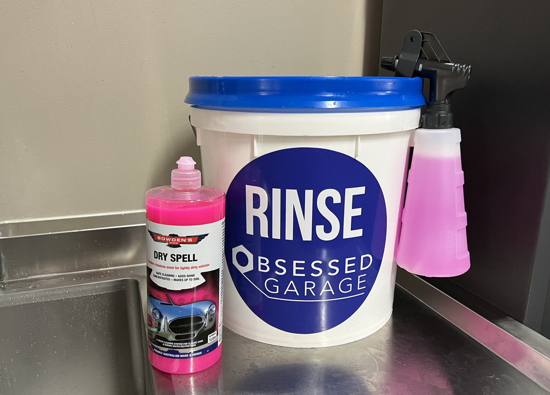

Bowden’s Dry Spell – This is a surfactant-based rinse-less wash, basically the only one you can guy in a bricks and mortar store in Australia.
As a rinse-less wash, its ok but nothing special. The same plays out on glass. Actually, Dry Spell was the only major disappointment of the bunch. The first wipes basically push the liquid around, it then requires considerably more wiping to deliver a dry/clear surface. It’s also one of the more expensive per 500ml. Not a product I can recommend in any application.
Type – Surfactant-based
Protection – Nil
Suggested Dilution Ratio – Not Stated
Tested Dilution Ratio – 150:1
Flash Factor – Minimal
DFB Score – 1/5

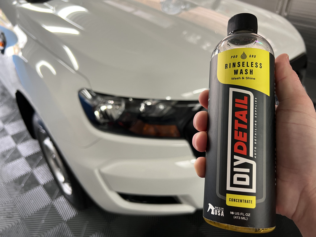

DIY Detail Rinse-less Wash – Despite my dislike of the brands antics, I’ve always liked this product. Out of the others here, DIY aligns with other surfactant-based products such as N-914 and Dry Spell. According to DIY, you can also foam this product, which is permitted by its surfactant base. But who is going to foam a rinse-less wash, you may as well just use soap. If you do want to try it like this, compared to the usual 30ml to 7.5-litres of water in a bucket, you need 120ml-150ml for foaming, which is ridiculous from a cost point of view.
So, how does DIY stack up as a glass cleaner? Being one of the last to try, I was expecting DIY to perform like the other surfactant-based products on test (N-914 and Dry Spell). And yet, it was the complete opposite. For this test, I opted for 128:1 dilution ratio. Where the other two need more wiping to achieve streak free results, DIY seems to flash off very nicely. The only mark against DIY is the lack of slickness when compared directly to the likes of ECH20 or Eco Wash, but then those tend to overachieve on that metric.
Overall, DIY used for glass cleaning exceeded my expectations. A very impressive and surprising result.
NOTE – For this test I used v1 and not the updated v2 formula.
Type – Surfactant
Protection – Nil
Suggested Dilution Ratio – Not stated
Tested Dilution Ratio – 128:1
Flash Factor – 5/5
DFB Score – 5/5

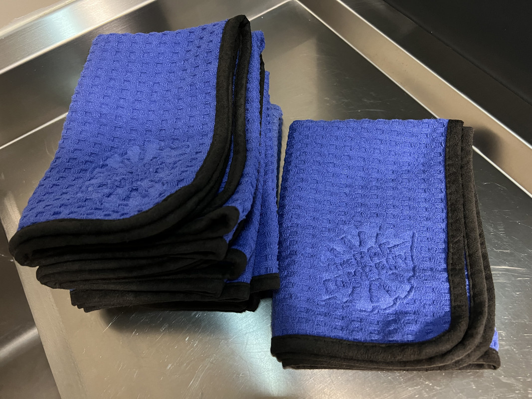

What glass cleaning towels and spray bottle do you use and do you have a link to them. Thanks Koch is great stuff.
DFB5.0
DFB5.0
Mar 15, 2017
1,510
2,123
Australia
Mustang GT Fastback
I've tried many different towels, but my favourite is the TRC Dry Me A River in 16x24 size. I find these to be far less grabby than special dedicated glass towels, and extremely durable as well. The key for any glass towel is a low and dense pile, this limits linting and improves the finish. The 16x24 size is the sweet spot.
Dry Me A River | The Rag Company
THE RAG COMPANY Dry Me A River Professional Korean 70/30 Microfiber Waffle-Weave Drying & Detailing Towels 16x24 White : Amazon.com.au: Automotive

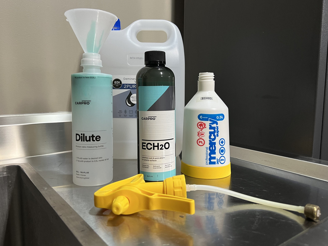

I've found spray bottles to be subjective. My favourite are the Kwazar Mercury 360, which are a very durable and ergonomic double action sprayer. If you want something cheaper, the Carpro Dilute are nice because they have a dilution calculator on the side, the actual spray head isn't all that flash though. Stick with the 500ml of either, they are much easier to work with than the 1-litre sizes.
Kwazar 9120067361415 Spray Bottle Mercury Super 360 Pro Plus 0.5 L, White/Red, 8.9 x 8.9 x 29 cm : Amazon.com.au: Garden
Kwazar Mercury Pro Plus 360 Spray Bottle

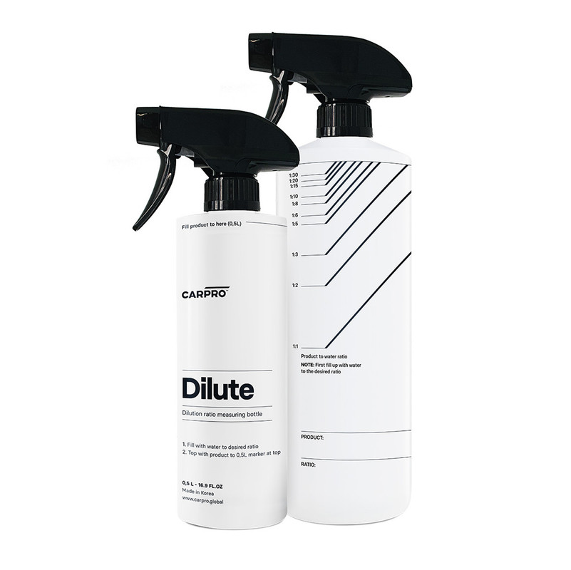

CARPRO Dilute Bottle | Pre-Printed - Autogeek.net
