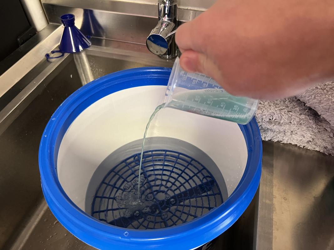

1/ Mix up your wash solution in a bucket.

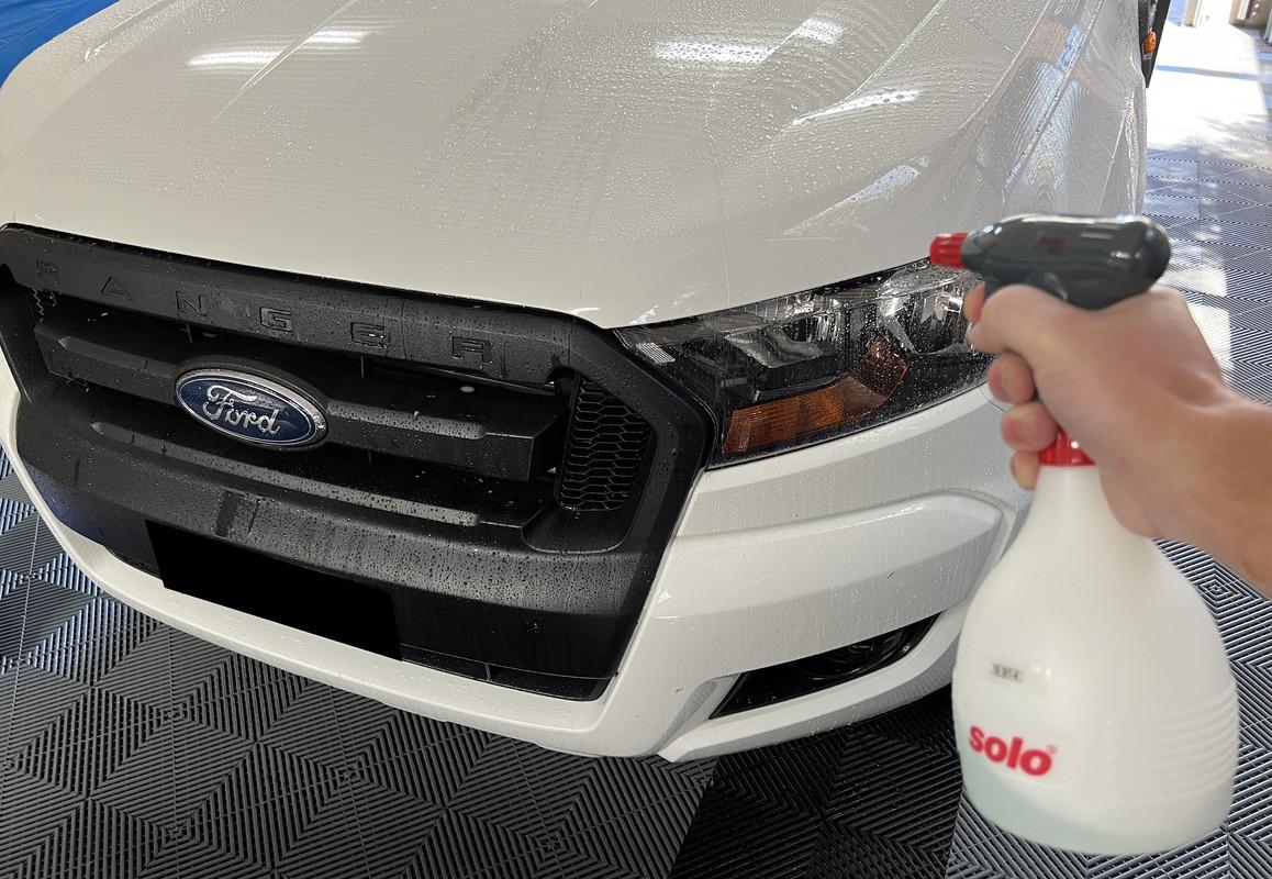

2/ Fill a sprayer for the pre-soak, by either pinching some from the bucket or by mixing up a separate dilution. (Some products have separate dilutions for pre-soak and wash solutions, some use the same for both)

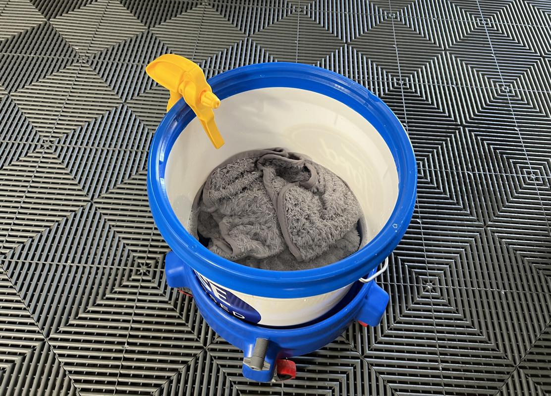

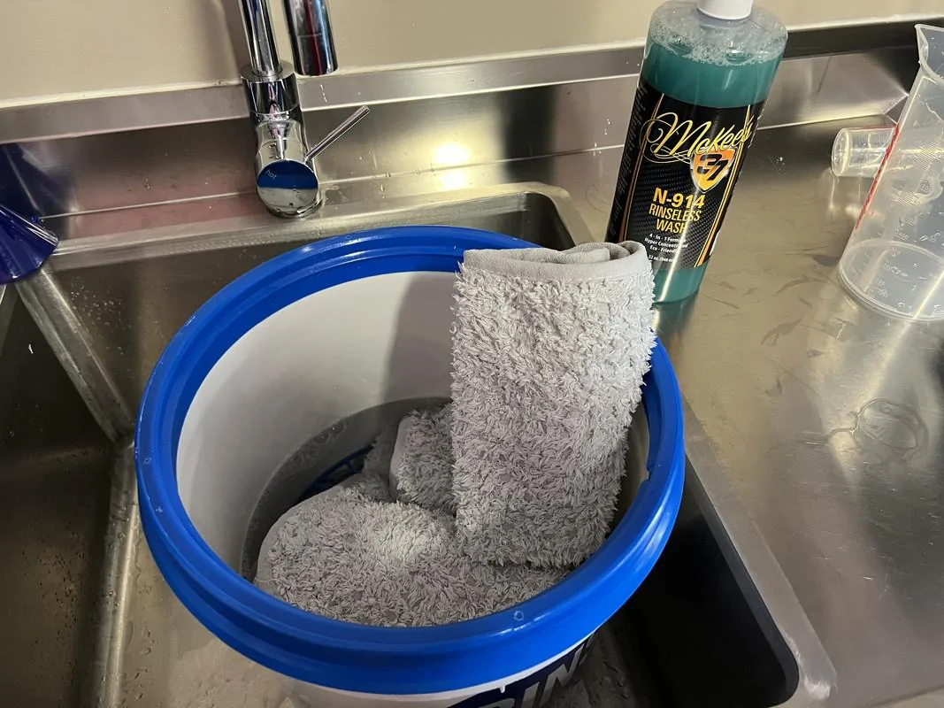

3/ Add your towels to the bucket to soak. How many you use will depend on the size of the car, for a Mustang you would need about 6 towels, a Falcon perhaps 8 towels, a single cab Ranger needs only about 4 towels. (More on towel choice later on)

4/Working in sections or the whole car, apply the pre-soak using your sprayer. Be generous, being sure to thoroughly soak any bug, bird or tree deposits.

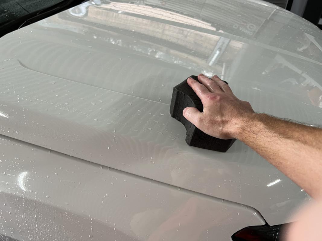

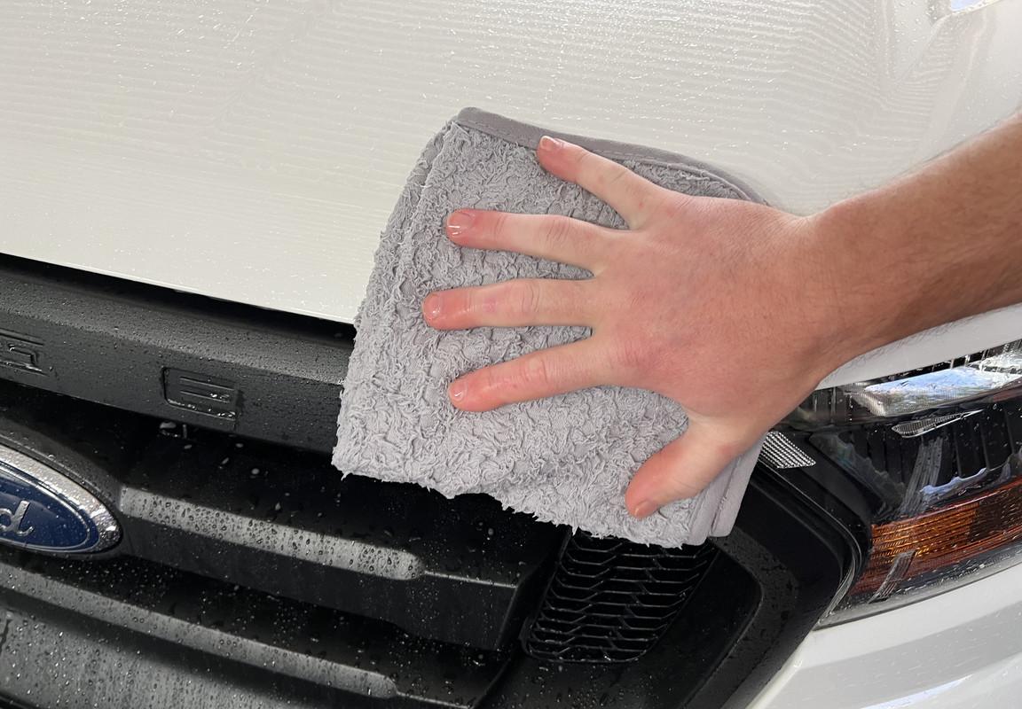

5/Remove a towel from the bucket and squeeze until just dripping. Fold the towel in half, then in half again to effectively create eight different sides.
S650 Mustang Rinse-less and Waterless Washing IMG-6198

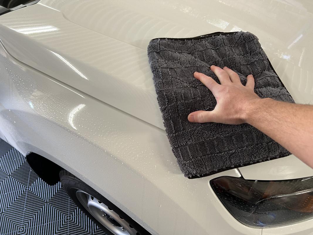

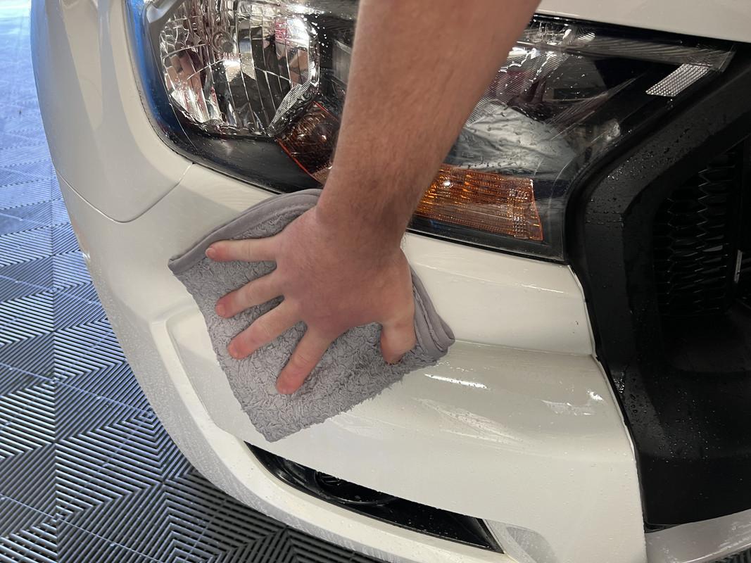

6/Working in straight lines, gently wipe across the panel. Inspect the towel and flip to a fresh side of the towel as needed. Once each side of the towel has been used, put it aside and grab another from the bucket.
You can do the above panel by panel, drying each panel as you finish. Otherwise, wash each section and then dry the whole car afterwards.
