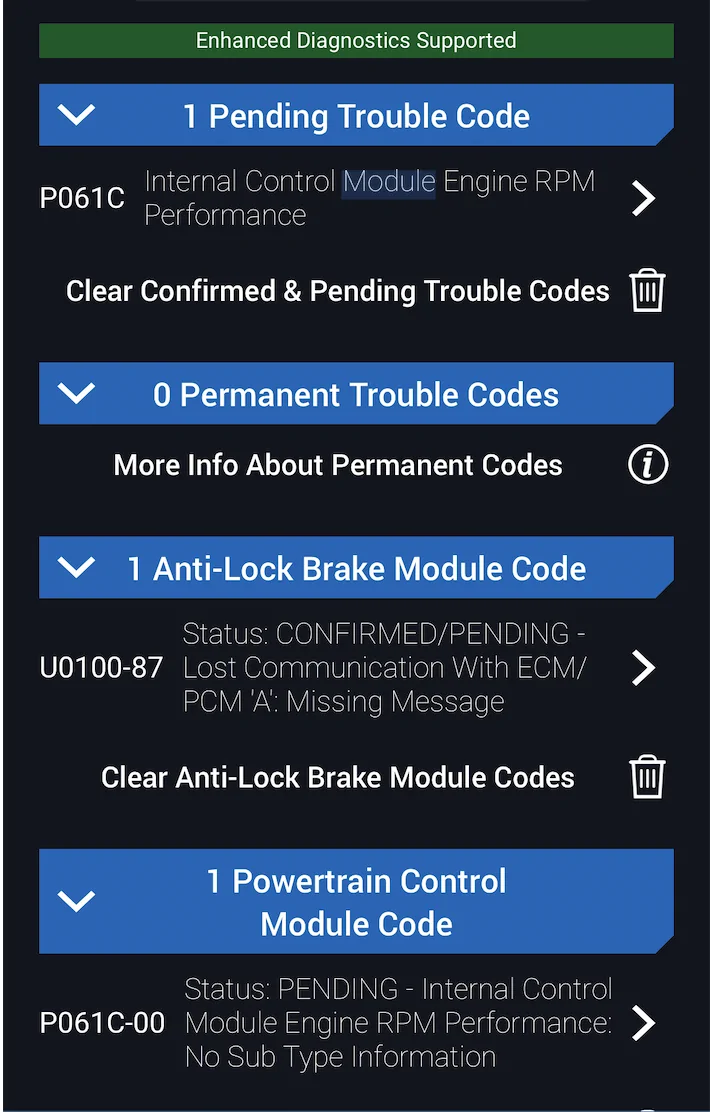

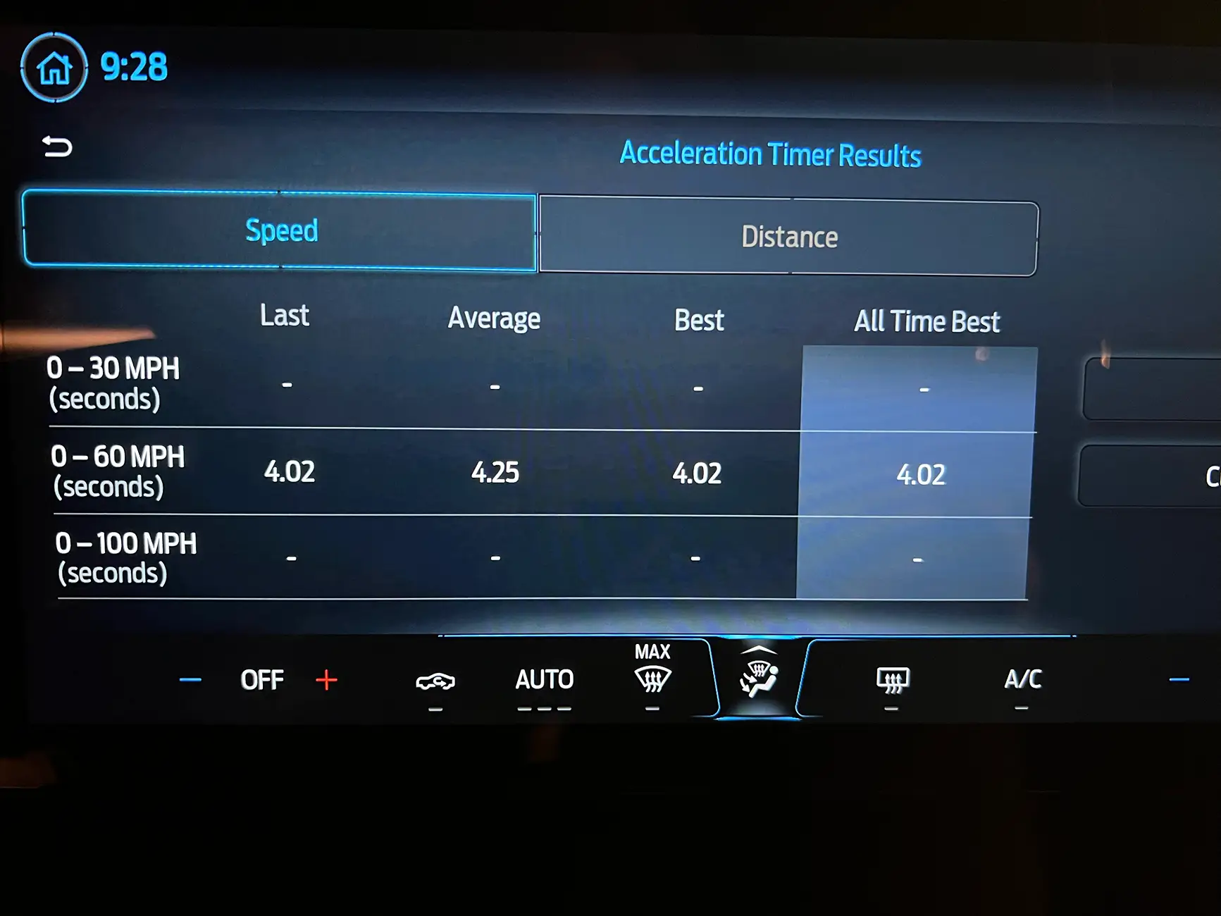

A nice cruise with friends and a small pull. at the end of the pull car decide to cut power and throw few codes. After restarting the engine it run fine. 10speedAuto

Sorry to destroy the fun. But to inform you, the timer is just a gimmick. People had 2.6 second times with this thing. It's just a toy that Ford impelemented on the car to make the people believe the times when they see a great time. But yeah, 4 seconds is possible in the best conditions.

Depending on the configuration (rear axle ratio, auto, manual, etc) the 0 to 60 looks more like a tuned Eco-Boost than a GT.
While I agree with the above comment, the timer in my Eco-Boost is within a tenth or two of my Draggy and associated app. Doesn't matter really as we shouldn't be 'testing' on the street.

Use draggy. The best I’ve turned on the street with drag radials and 850 WHP is 4.3 seconds. On a prepped track it’s 2.9 starting in 2nd with the 10r80 and 3.55 gear.
I had a similar thing happen on my '25 GT when it was relatively new. I did a small pull to like 30mph, did a downshift on the 10R80, suddenly loud POP and the engine went into some kind of limp mode--with throttle it would just make a light burbling noise and car wouldn't go. Like 5 dash error messages. I could only cruise on residual momentum to the nearest parking spot. Reset the car and never had it again ~14K miles until I sold the thing. I posted it here and nobody replied, and I have no clue what caused it.
The burple noise is because the car was in limo mode and high gear. I have experienced another similar situation where I had a faulty cylinder head temp sensor, car lost all the power and I stuck in the 8th gear
