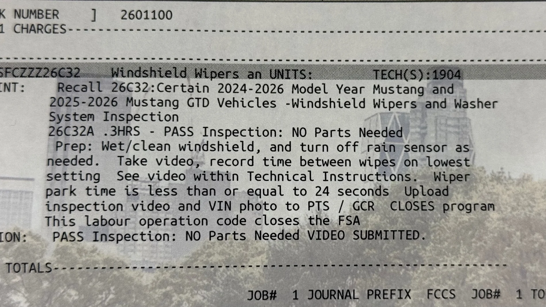

I got a call from my dealership to schedule an inspection for the wiper recall. It was performed by one of their mobile mechanics in my driveway. Before he started, I told him that it failed the 24 second delay test. He seemed surprised that I knew about this (thanks, jmatero), but he had to test and video the results. It failed. Now they order the motor. The mechanic said they had not been given full details on the repair and did not know if it could be done in the driveway or required a lift and/or special tools. I'm not in any rush as the car will never see freezing weather.

Im still awaiting delivery of my my26 dark horse that needs to be checked.
I have however been told that ill get the car in august.
The last day in august is this sunday so here's hoping.
The dealer hasn't been told what needs to happen for this to be able to be delivered to me so far?
S650 Mustang Windshield Wipers Recall Campaign Be Aware Screenshot_20260824_092603_AOL
