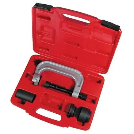

I’ve replaced the rear studs once and the front twice. The rear replacement requires removing the hubs, but the front can be done with the hubs mounted to the car. The actual stud removal and install is not bad if you have the proper tools.
This is what I used for the install as the stud manufacturer said to press the studs in rather than using the type where it is pulled on using a lug nut.
https://www.spcalignment.com/product/40920
S650 Mustang Wheel studs replacement experience IMG_6181
