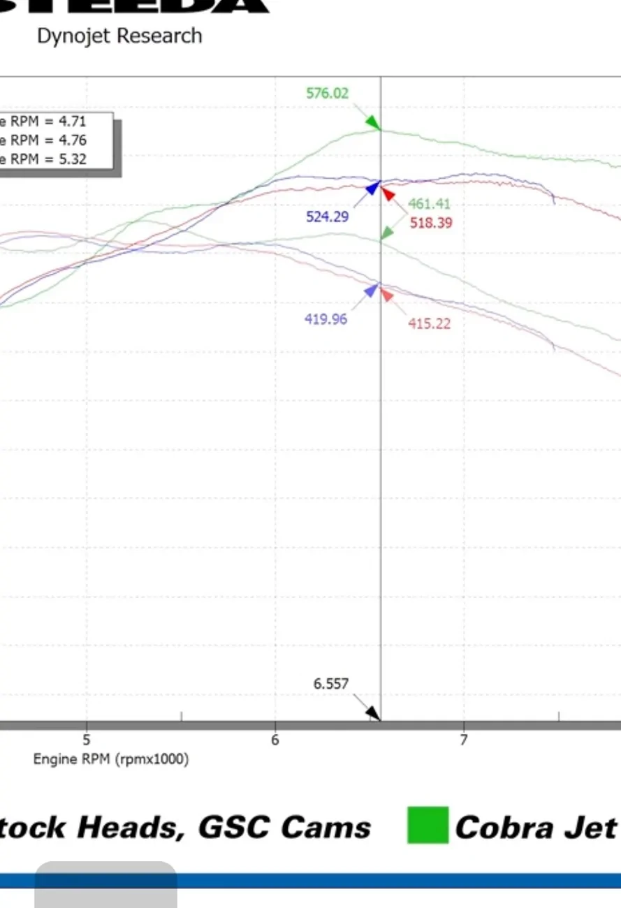

Steeda's just talking about adding the Cobra Jet, dual TB adapter, and GSC camshafts
Also, they are talking HP at the wheels, where a stock GT will make 400-430 depending on how happy the dyno is.
Since I have the A10, I went out on a very empty roadway and went full throttle for several gear changes just to watch how little the rpm dropped with each gear change. My car is not tuned. It is stock as Ford designed it.
The engine never dropped below 6000 rpm that I could tell.
What this means is that the the rpm chart you posted shows all that additional power from the Cobra Jet manifold would be in the rpm band that the A10 cars are using at full throttle. In other words, this is not just "peak" horsepower, but the usable rpm range when full throttle, with the selector in D.

The GT comes with 480-486 (with active valve exhaust) stock, so 576 is 90-96 more. More than 50, not more than 100.
Not to throw water on the fire (the results are impressive) but most of that came from the fact that the car is running E85 vs 91/93 pump gas. E85 is over 100 octane and burns very cold. That allows for lots of ignition timing and aggressive cam timing (on a turbo... which this is not... you can run A LOT more boost).
I would like to see what the car could do on pump gas (for us regular folks).
Junkyard Dog
Jun 3, 2025
2,964
2,465
And one is at the engine (480-486).
At the wheels that is 390-420 depending upon which dyno and air temperature and how hot the car is and correction factor, especially STD v. SAE.
The other, 576, is not at the engine. It is at the wheels. So you need to compare the 576 to the 390-420. Let's just take the high end, 420.
576
-420
156
So it is 156, not 90-96.

How long would this combo stay together at the track if you're running around 7k?
Should be all day? I run higher at the track now, as it is shifting up around 7500 and never drops below 6000 rpm for the most part if I just leave it in drive. Pretty much any of the full throttle stretches (including one almost a mile long) and it is running up there.
