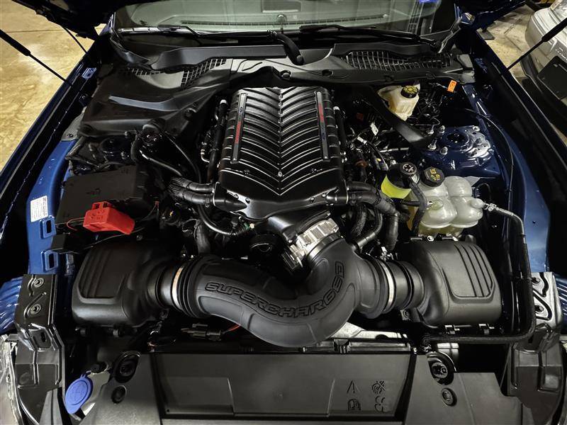

2024 Dark Horse Supercharger Install at a Ford Dealer
We chose the Ford Performance Whipple Supercharger not just for the performance gains, but also for the peace of mind that came with having it installed at a Ford dealership by ASE-certified technicians. Plus, this route secured a 3-year, 36,000-mile warranty, making it a no-brainer.
Conveniently, Bird Kultgen Ford, a dealership we’ve trusted for years, was right down the road and more than capable of handling the install. When it comes to major upgrades like this, having an experienced dealership handle the work ensures everything is done right the first time.
S650 Mustang We Added A Ford Performance Supercharger To Our Dark Horse + DYNO 1740143129253-of
If you’re considering a supercharger for your Mustang—whether at the time of purchase or after racking up some miles—Ford dealerships with certified technicians can take care of the install. Just be sure to confirm the warranty paperwork process with the dealer before moving forward.

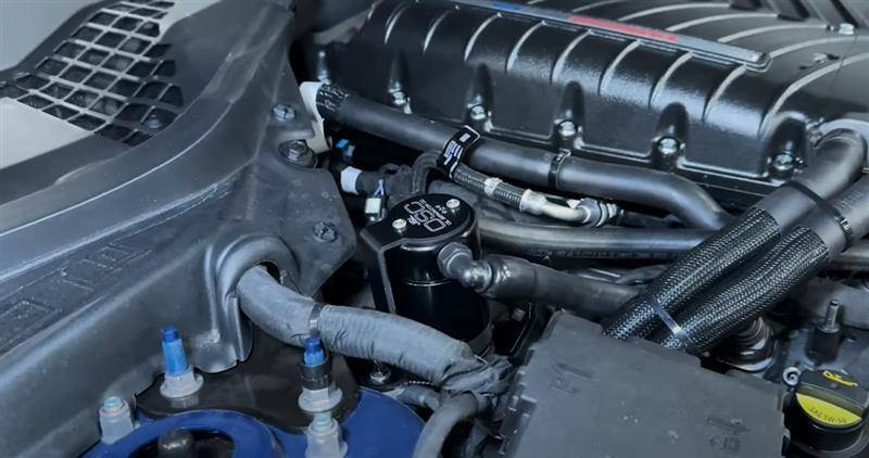

Preventative Maintenance: Installing an Oil Separator
Once the Dark Horse was back in our hands, we took an extra step to protect the engine and supercharger by installing a J&L oil separator. This simple upgrade ensures the system stays clean and efficient for years to come.
S650 Mustang We Added A Ford Performance Supercharger To Our Dark Horse + DYNO 1740143277487-1h
An oil separator (catch can) works by filtering out excess oil vapor before it circulates through the intake system. Without it, oil blow-by can lead to carbon buildup on valves, gunked-up intake components, and reduced fuel efficiency. By capturing the oil mist, an oil separator helps maintain optimal engine performance and keeps things running smoothly.

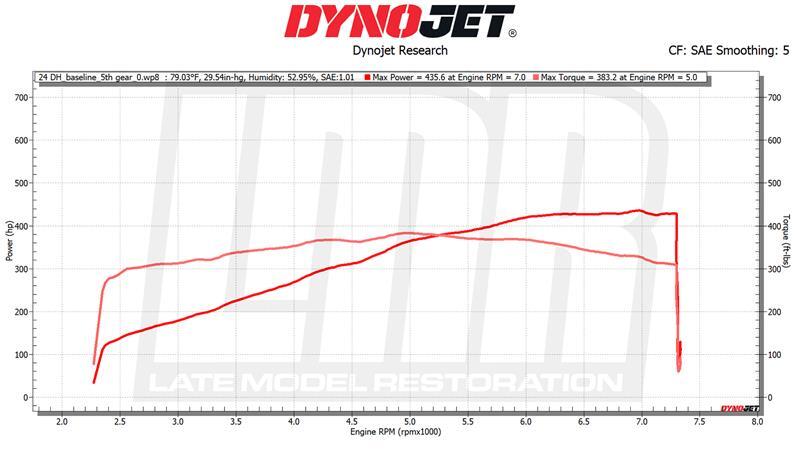

While the seat-of-the-pants dyno had us convinced, we needed some real-world numbers to back it up. Before installing the Whipple, we strapped the Dark Horse onto the dyno to establish a baseline.
Stock 2024 Dark Horse Dyno Results:
(SAE Corrected)
  • 435.6 HP
  • 383.2 lb-ft Torque
S650 Mustang We Added A Ford Performance Supercharger To Our Dark Horse + DYNO 1740143321502-u2

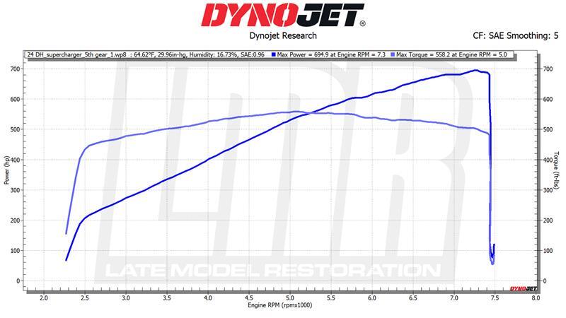

Whipple Supercharged 2024 Dark Horse Dyno Results:
(SAE Corrected)
  • 694.9 HP
  • 558.2 lb-ft Torque
S650 Mustang We Added A Ford Performance Supercharger To Our Dark Horse + DYNO 1740143326560-ac

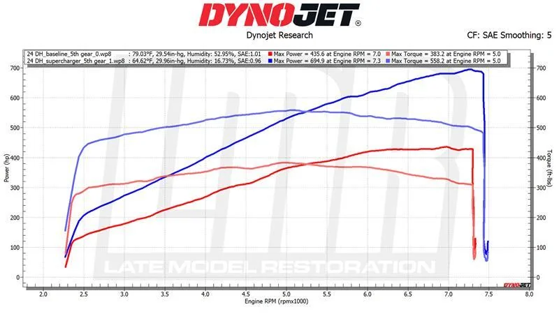

Total Gains:
  • +259 HP
  • +195 lb-ft Torque
S650 Mustang We Added A Ford Performance Supercharger To Our Dark Horse + DYNO 1740143332041-al
Needless to say, the supercharger completely transformed the Dark Horse. It now delivers the kind of power that makes the price tag feel justified.
