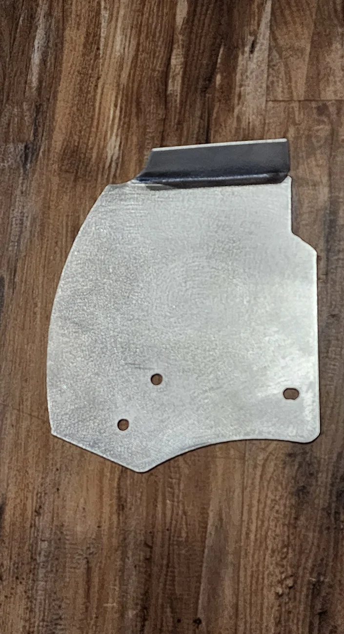

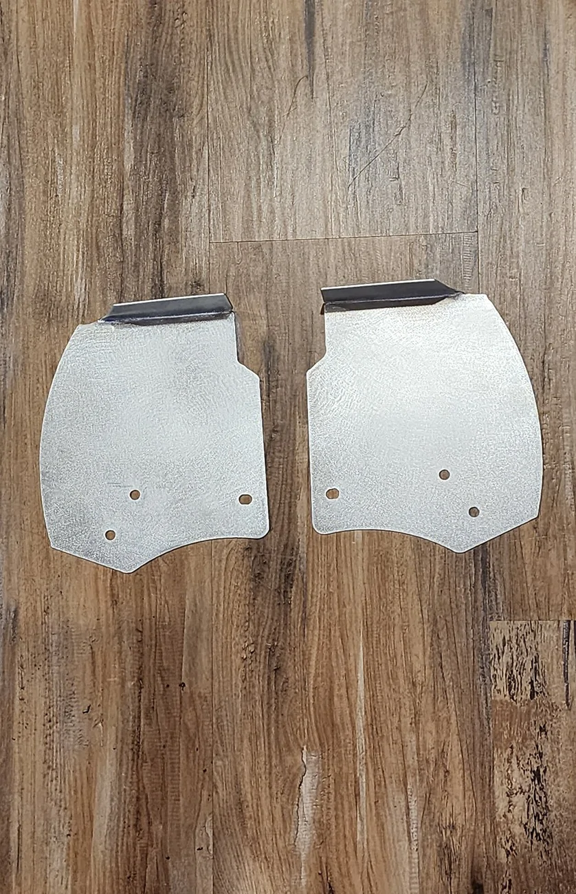

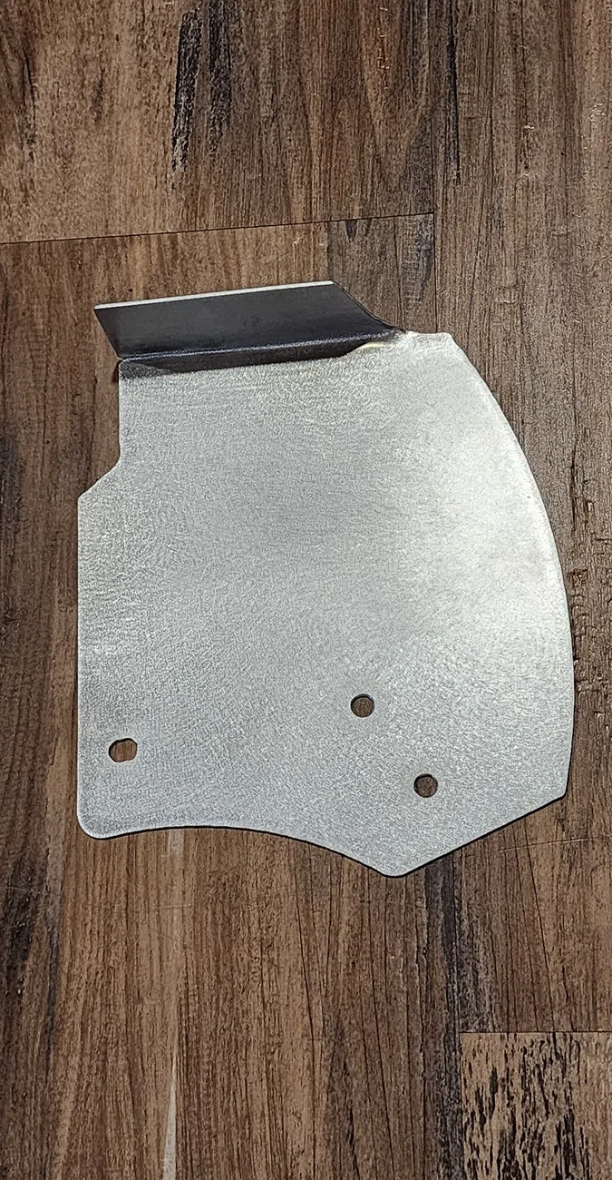

Hey guys,

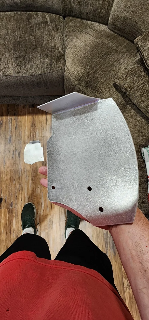

Just ordered these again from VORSHLAG. The front air deflector kit that bolts up to front control arms. I had these on my 21 Roush stage 3 car and 23 Mach 1, they were badass!! I just ordered them for my 2024 GT non PP car. Im doing the entire PP brake upgrade.. The original owner ordered stang w Brembos, Thank God. So im just enhancing it. 😁 Anyways, just sharing some pics, they are massive for the 24.

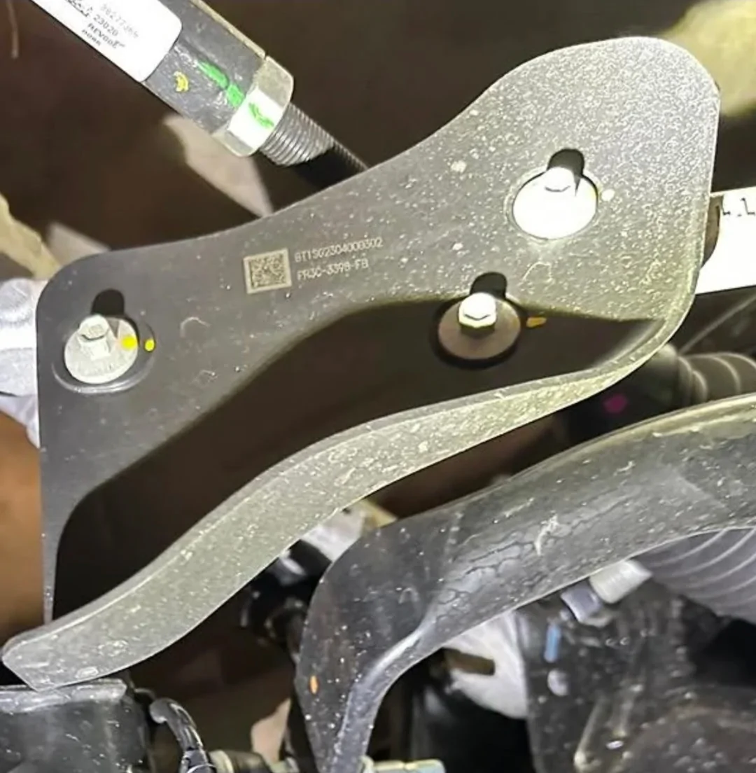

Btw, anyone looking to add these to a Non PP car, you need to tap the front control arms M6 × 1.0 tap and bolts are 3/4 length. These are stock bolts from ford size for PP arms. See the pic of fords puny deflector attached as well. Lol
