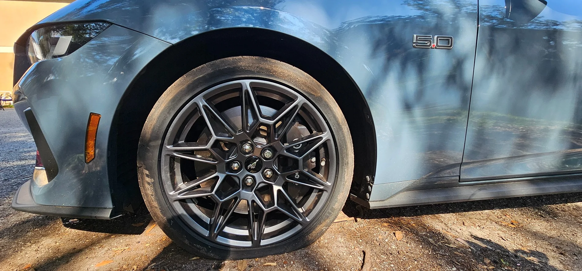

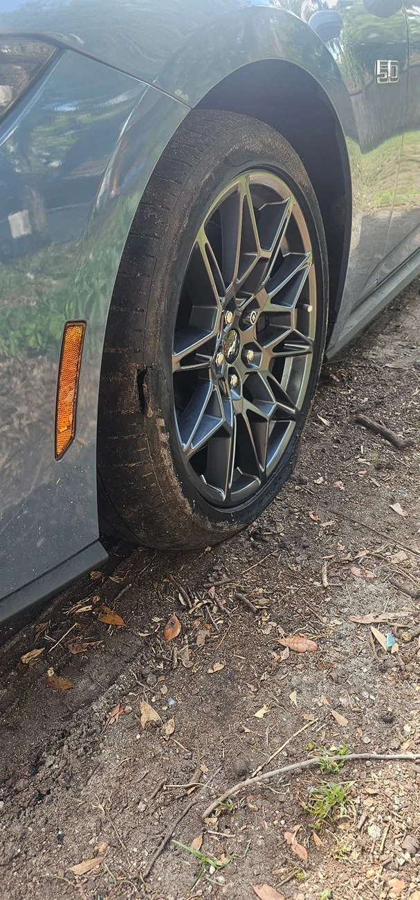

My fronts were due for replacing anyways so I didnt really care, but the rear has a bubble now so I need 4 new tires.
Im torn between just getting new rubber for the stock wheels and hoping the rim isn't bent any - I dont see any cracks or scrapes but who knows.. I did find a local tire shop thats selling take-offs for $1200 but their Facebook post says they accept foodstamps for payment so I feel like they'd sneak a airtag in the wheels and come steal them later 🤣
Or switching to velgen classic5 v2s with Michelin pilot sport 4s (or all seasons?) Was looking at 275/35/r20 front and 305/r30/r20 rear. I dont know much about wheels and offsets. Spending $5k has me hesitant but I would rather not spend $2k on stock tires then finding out i need to spend more on stock rims
Also I somehow drove the car with no air in the front tire for 12 miles @25mph with the first half not even noticeable that I had a flat. After that there was a slight vibration, I get off work at 5am so thankfully there was only a handful of other cars on the road

What a shame. In the first pic posted the wheel seems to have a little deformity, but that may be reworkable. Sounds like a realignment may be in order as well.

The tyre shop will probably spin up the bare wheel to see if it's running true or out of round.
But new wheels and rubber does sound tempting.
And you can sell the originals as a set if they're OK.

First photo - possible wheel deformity. I was thinking the same at first. Looking again, I believe the bulge in the tire is creating an illusion of a deformed wheel. Diagnosing from a photo will never match an in person perspective.

Dam, sorry about that. Looks like a pretty hard hit. I'd definitely get an alignment. If you like the stock wheels get em checked and you could just get some new bologna skins. Cheers 🍻

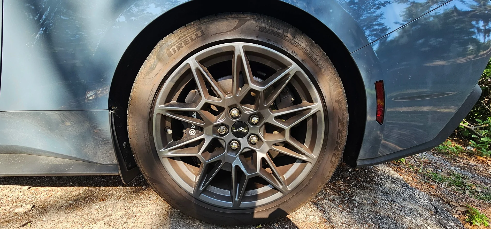

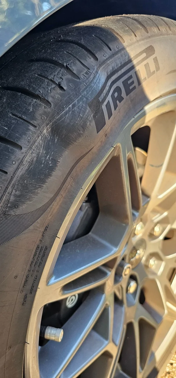

I still cant decide on what to do.

looks like the rear wheel is cracked. I wouldn't trust it, especially on a track.

wheel looks ok
get it roadforced balanced and mark the rim that hit the pot hole if is much higher than the others replace it
just ask the wheel balancer to make a note of the road force for you and if it seems out of round on the machine
