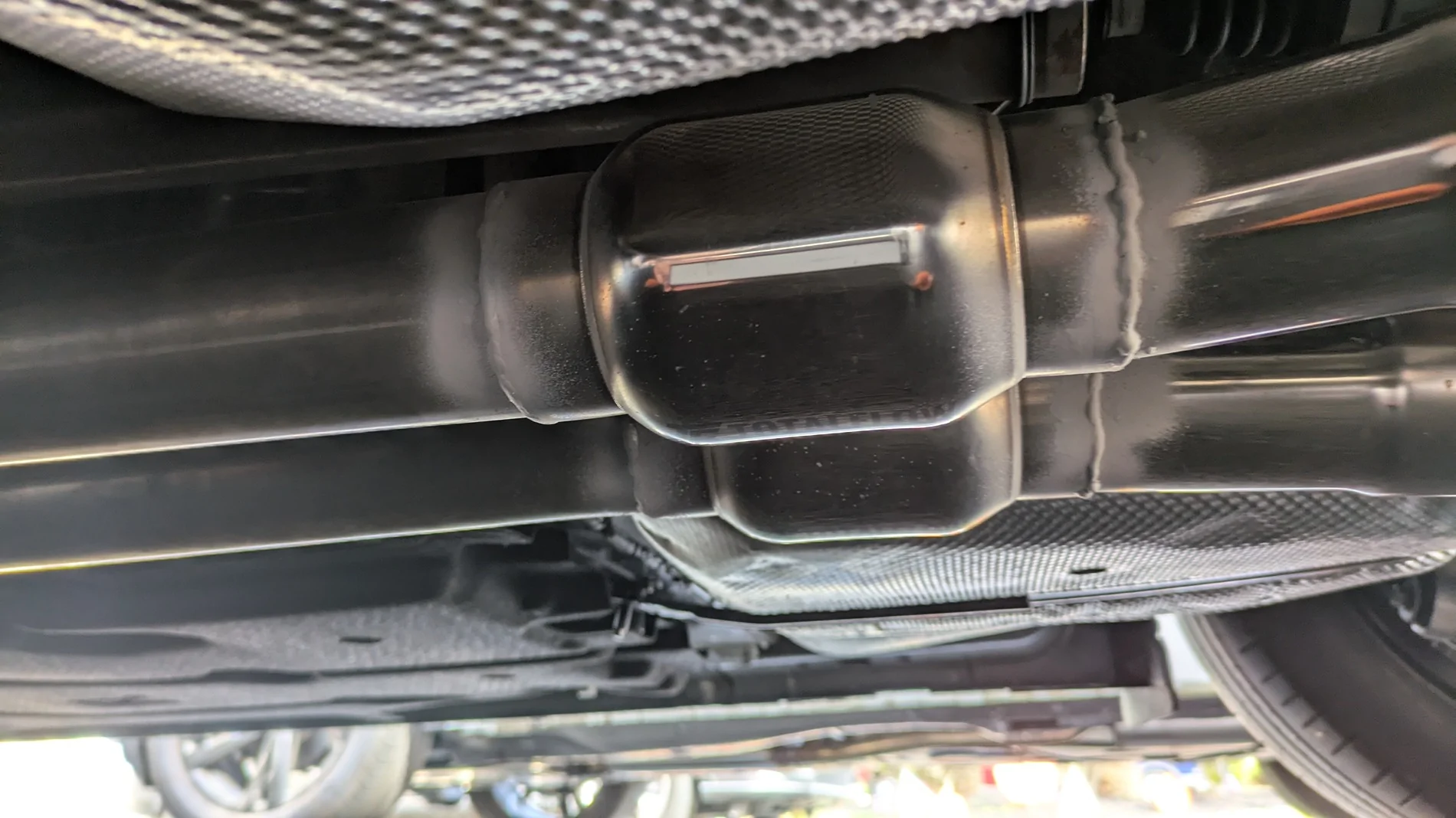

So I had my guy install the Corsa axle back and I kept the smallest total flow mini resonator on there with the X pipe.....There is drone at 1500 - 2000 RPM and also vibration in the cabin. So will be switching to the next size up Totalflow resonator which is still smaller than the vibrant 1792 resonator I first had on there which muted the sound to much.

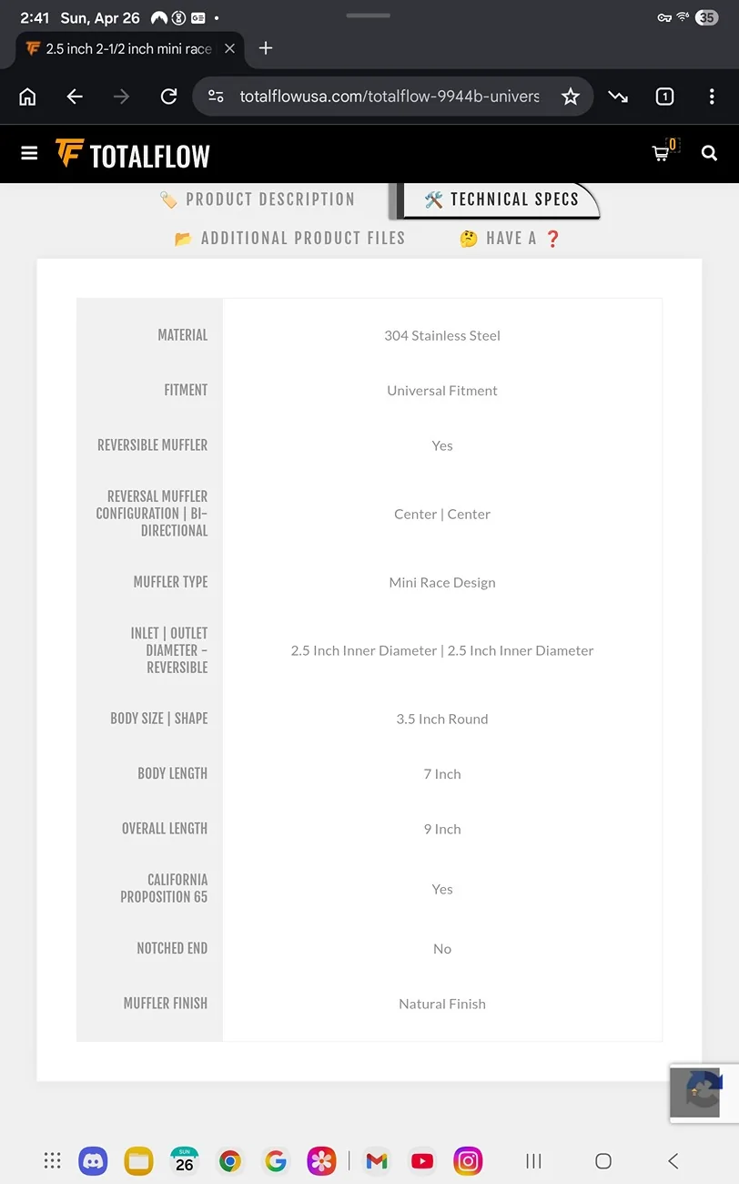

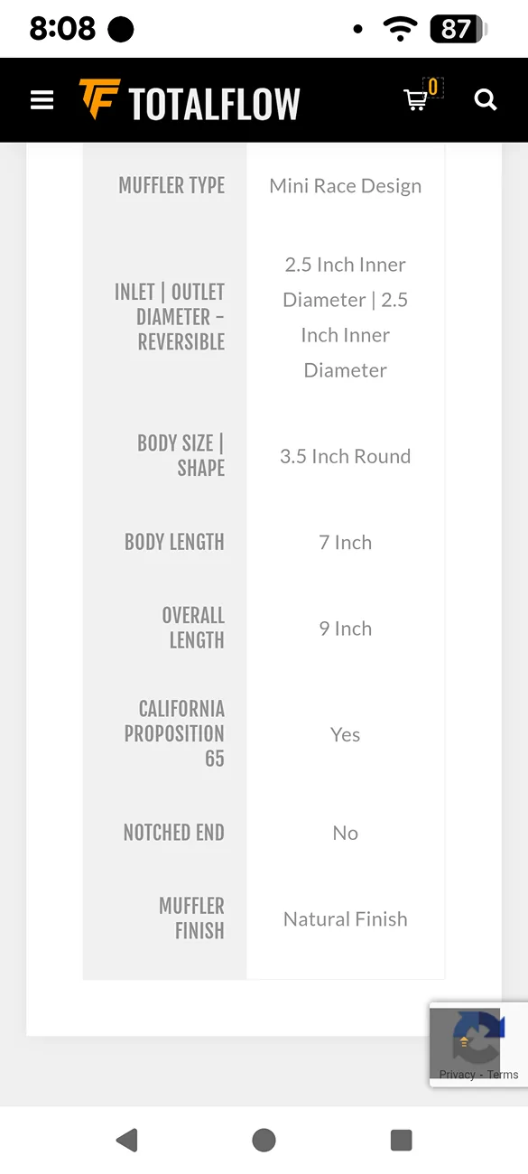

Yes sir, and it is now perfect with my current setup.....Steeda X-PIPE, with the 7 inch (body) TotalFlows attached to the end of the x-pipe, and then the Corsa Axle-back......I would highly recommend this setup to anyone chasing the perfect sound with zero drone or raspiness
