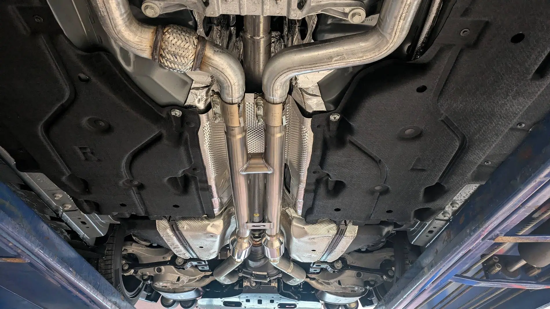

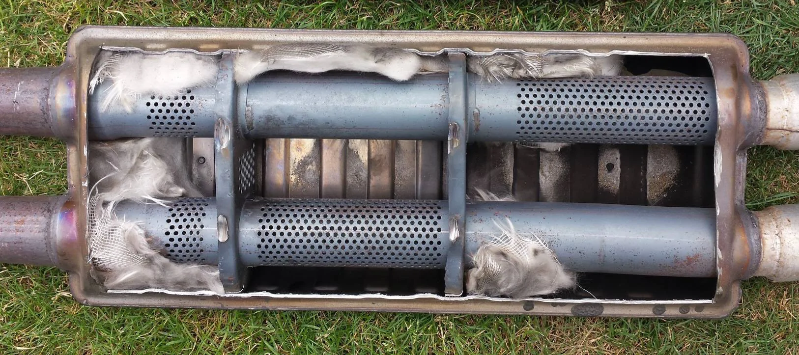

S650 Mustang *Update* Dark Horse with Steeda X pipe with TotalFlow mini race Resonators and Corsa axle-back 1763558641436-v9
S650 Mustang *Update* Dark Horse with Steeda X pipe with TotalFlow mini race Resonators and Corsa axle-back 1763558663089-42
So looking at these photos, it appears that the stock resonator, while being directly a flow through, has only 2.25" pipes.
The stock system reduces at the connection.
Even on the H-Pipe crossover picture, there is a reduction in exhaust size. Look where the exhaust connects into the H pipe, there is a sudden, dramatic pipe size reduction.
Does anybody know what size that stock pipe is before the reduction?
I am wondering if there is horsepower to be gained by keeping the pipe at this larger size (whatever it is) as far back as possible until the stock active exhaust mufflers?
I know @Q6543 used an aftermarket dual input muffler setup in place of the stock resonator with, going by memory, was 3" diameter all the way through?

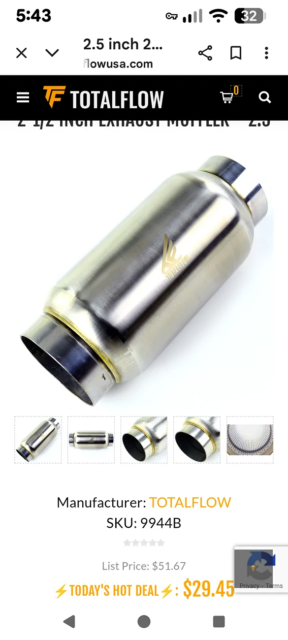

Yes it definitely sounded better with the H pipe and Vibrants. But the Vibrants muted the sound a little to much.
I think the H pipe with either of the smaller Totalflow
S650 Mustang *Update* Dark Horse with Steeda X pipe with TotalFlow mini race Resonators and Corsa axle-back Screenshot_20251113-174336
S650 Mustang *Update* Dark Horse with Steeda X pipe with TotalFlow mini race Resonators and Corsa axle-back Screenshot_20251113-174311
resonators would be perfect.
I see those are 2.5"
Where the Vibrant 12" a 2.5" inlet/outlet?

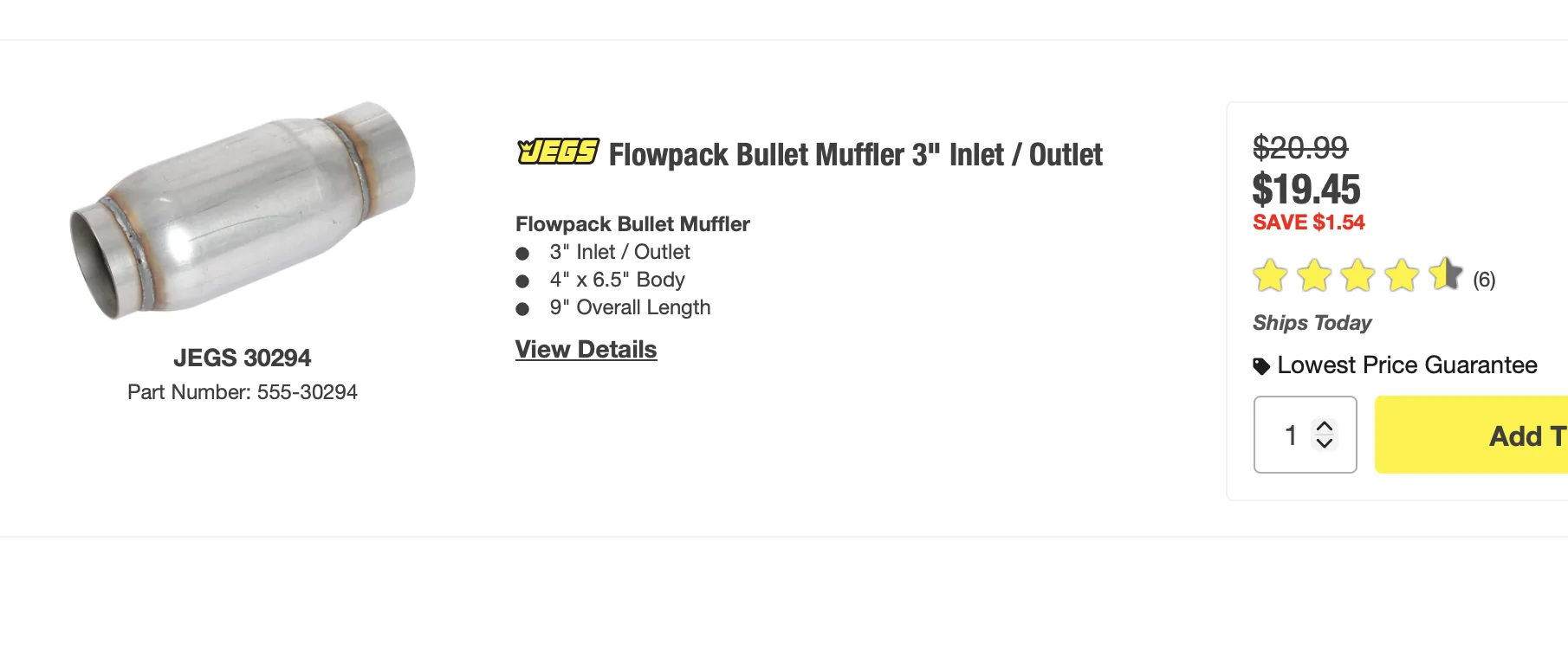

90% of the people out there just want loud. That's why there's so much shit like muffler deletes out there.
I put a pair of these Jegs bullet mufflers on my car, basically smaller resonators. Other brands are bigger and have more packing but for the price and size I figured what the hell.
They don't make the car that much quieter but just sound better because they take all the blapap bapapapap crackablaapa out (especially at part throttle when it's most annoying) and smooth it out to just a 'mmmmmmmmm', like a lower pitched booming noise.
Hard to find a decent muffler shop otherwise I would have went there first so the could measure and I could have gotten the longest possible one in there.
