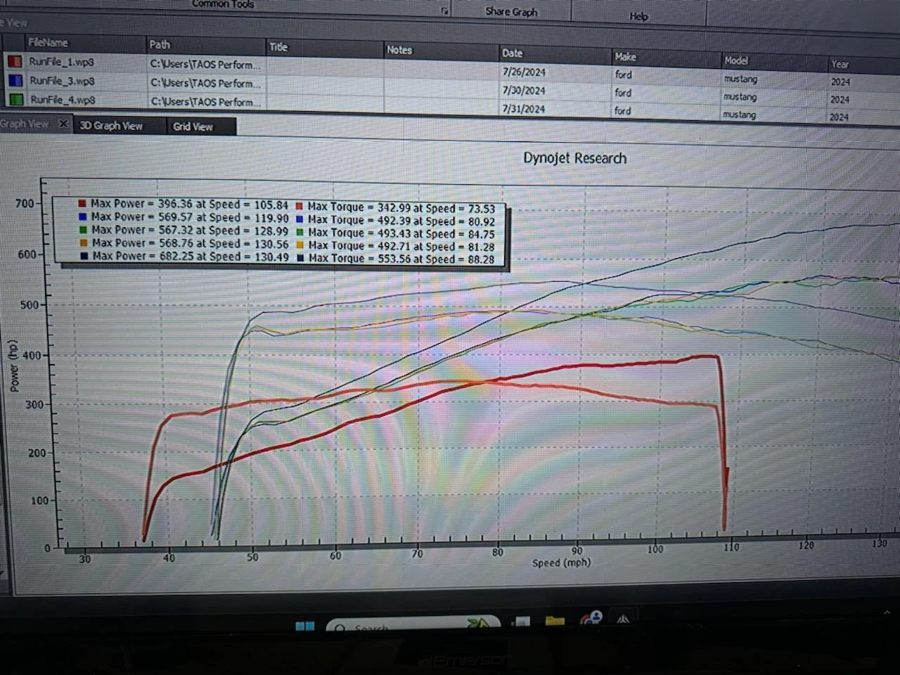

Here is the the real deal so you don't get false hopes. At 3500mi, my Stock 2024 GTpremium pp AT s650 dynoed at 395whp. It was running 87oct until it was filled at 29mi left on gauge for all pulls. This was the first tank of 91 w/ a single can of royal purple octane booster. Then gen6 stage 2 installed, and dynoed poorly(about 620) a can of boostane was added and did some idling and running for a few hours. Another dyno pull after made 682whp. Not bad on a pretty normal first setup, but 168whp from 850 claimed all over the interwebs. Pic for proof. Enjoy yall. (All pulls at aprox1000ft elev80ÂşF69%humid)

Is this a stage 1 or 2? Perhaps they dynoed it in a lower gear because I think the MPH should be significantly higher if you’re in 7th

Im not sure what gear as I'm just the customer receiving the news and dyno pic from the speed shop. I'd guess it's probably still down 20hp as the fuel could be improved and the computer needs time to adjust. I paid for whipple a gen6 stage 2, and i pick it up from the shop friday(7/2)morning when i have time. I have to double check the 112mm throttle body to be sure it's what I ordered.
