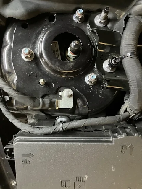

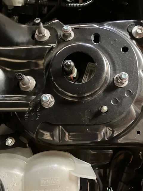

I maxed out the camber in the front, the back has a little more.
The front isn't bad; the back is more of a challenge.
The pictures are after the adjustment

Can you get more by cutting that hole? If not, does somebody make a bigger hole?
Did you post a how to thread with photos or video anywhere here?
