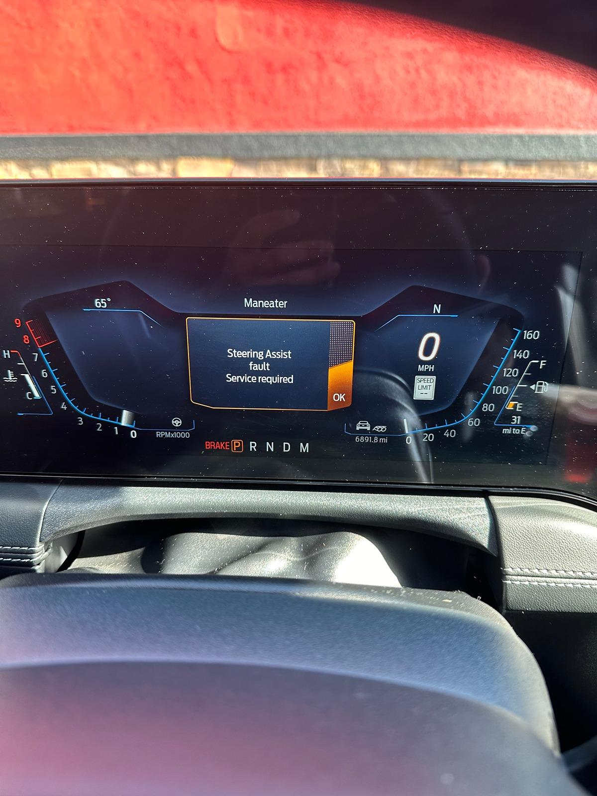

Anyone run into this issue?
Started fine in the morning, stopped to get coffee , turned the car back on and was greeted with that warning.
Car drove fine, no issues, no limp node, error hasn't came back.
Interestingly enough, the car did not start in quiet mode that time eventho it was during the time frame where its supposed to.
Running coil overs and wheels.

Mine did that once. Restarted the car it went away and has never come back that’s been 2 months ago.

I think you kind of answered your question with the last sentence.
Mods + sensor driven systems = unpredictable errors

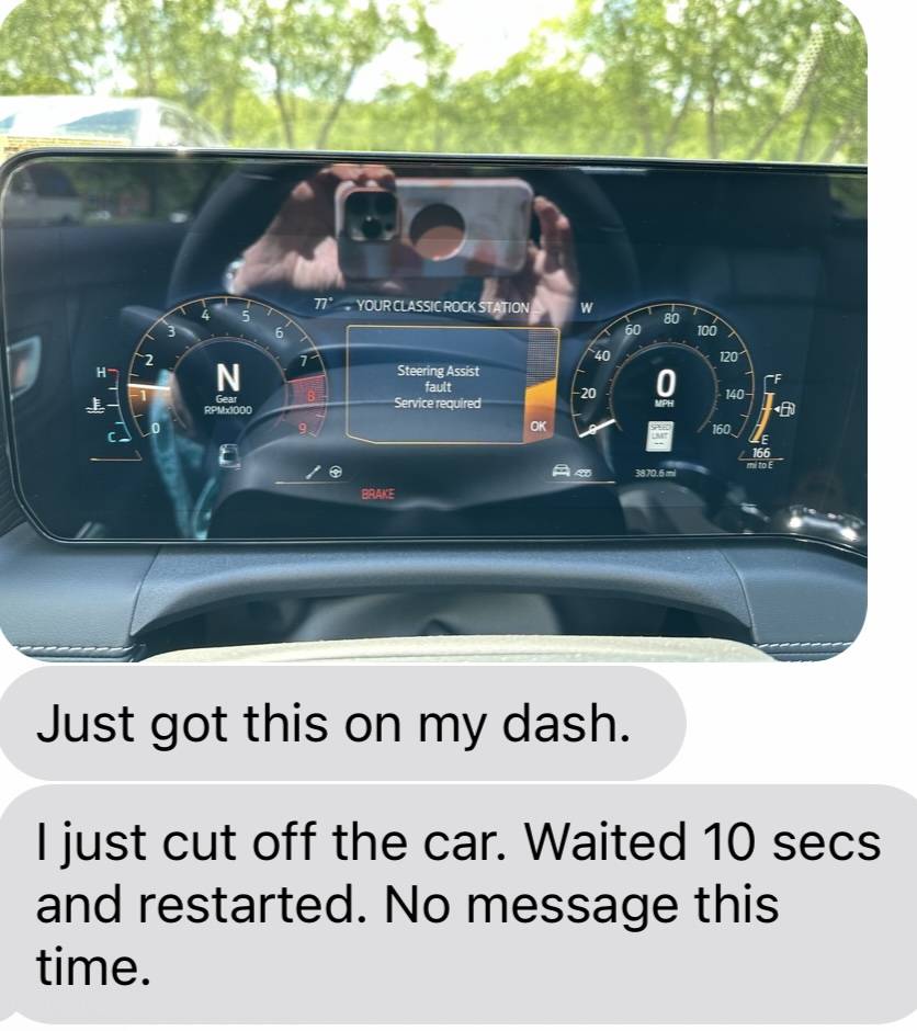

drove to town (13 miles oneway 50/50 highway/town). Ate lunch, upon startup to leave we got the ā€˜steering assist’ fault and then the ā€˜what’s new’ update message (now on 6.3.2 - confirmed also got the classic gauge). Seems my garage is as good as a faraday cage. Tucked away in the garage works for fordpass status but for some reason we’ve only received updates after being out and about. Couldn’t change drive mode using the steering wheel (steering status was just - -). Got through town found a secluded spot (off the side of a side road - didn’t want to be the traffic jam, in case), did a quick restart and no errors and drive/steering modes returned. Dash was reporting 14.5 volts before we pulled over and restarted, tbh i forgot to look when we got going again. The rest if the return trip was error/incident free.

What did you do when you did the quick restart? Do you mean you turned off the car and started it back up or is there a way to restart the electronics as in a reset?

Apologies, correct - my quick restart in that instance was ignition off set 5 seconds ignition on.
some have been (not sure if forced or fortunate is correct however) able to reset by disconnecting the negative lead from the battery for 30-90 seconds.

I also experienced the "steering assist fault, service required" message on my 24 GT Premium today. 516 easy miles on the vehicle. Wary of wonky electronics, I pulled over, shut her down, fired her back up and the message ? Gone. If it comes back, I guess I'll have to call the dealer. Stiff steering and modes disabled while fault was active. Possibly other features as well. Car has never been wet.

Just wondering if anyone else has experienced this—I’ve booked my car in for a service to get it checked out, but thought I’d ask around here too.
I occasionally get a message pop up very briefly that says:
ā€œSteering Assist Fault - Service Requiredā€
It seems to happen when I’m turning the wheel in tight spots or doing a U-turn. The steering goes a bit stiff for a second, then it goes back to normal as I complete the turn. No other warning lights stay on after that.

After months of going back to the dealer multiple times, they replaced the steering rack and the problem has gone away.
