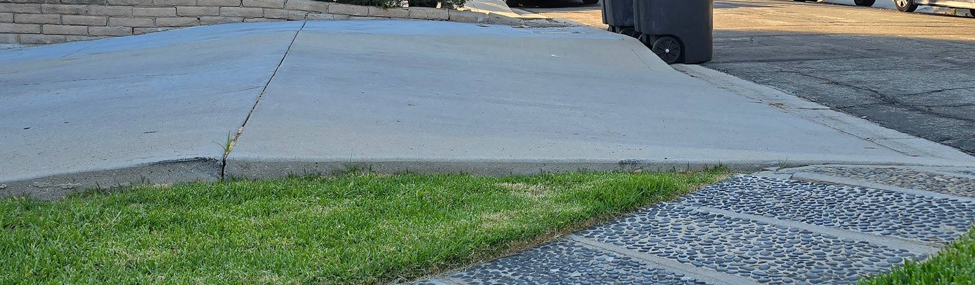

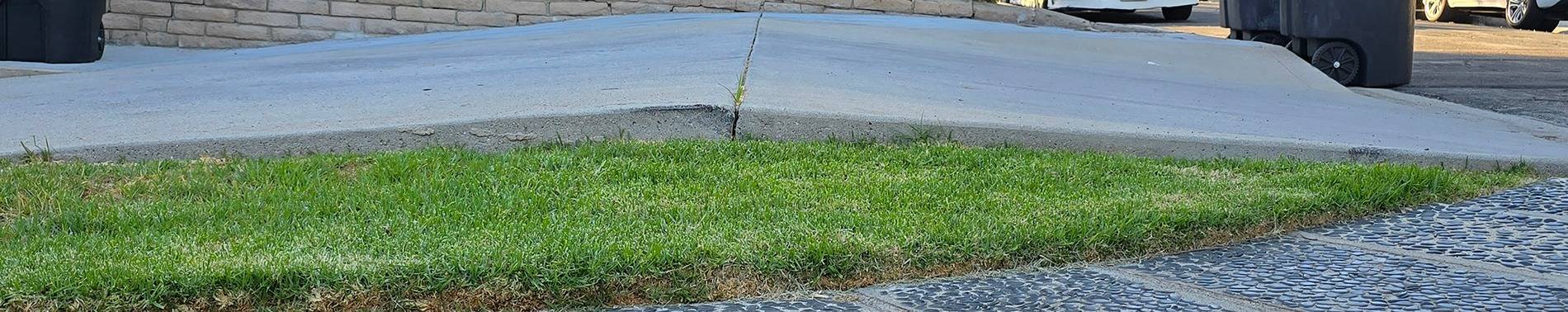

Here are some pics
S650 Mustang Steep garage, worried about ground clearance. 1000009703
S650 Mustang Steep garage, worried about ground clearance. 1000009702
It's actually 8ft in not 4 ft where it peaks.
Trying to avoid coming in at an angle cause planning on parking a second car on the driveway and it will be difficult angling in.

I would move the other car and angle it in..... only chance you have....I know a total pain but I have to move cars around my house all the time to get cars out.....you get used to it after a while......either that or get a lift system installed as well.....or something to raise the car up like air ride......
Or better yet- see if you can rent a Mustang from one of the big rental places and try it out.....I would say Turo one but wouldnt want to do that to a individual......

@Lakersfreak ..... I used to build houses. Why is your driveway crowned like that? From what I see it would be easy to use a cut saw to score both ends of the rise then break-up in between the lines and re pour in a flatter angle. If you need the slope to keep rain from running down the driveway put a SS drain across it. Am I missing something? Seems like it would be worth the cost in the long run.

Take it slow and keep checking the first time.
The corvette and mustang have the same wheel base.
The Corvette can lift almost two inches at the front but that's only one inch at the center.
I don't see lowering springs in your future!

Old home in Los Angeles. It was for sure done for storm water control. Indo eventually need to redo the whole front yard so that's definitely an option in the future.
