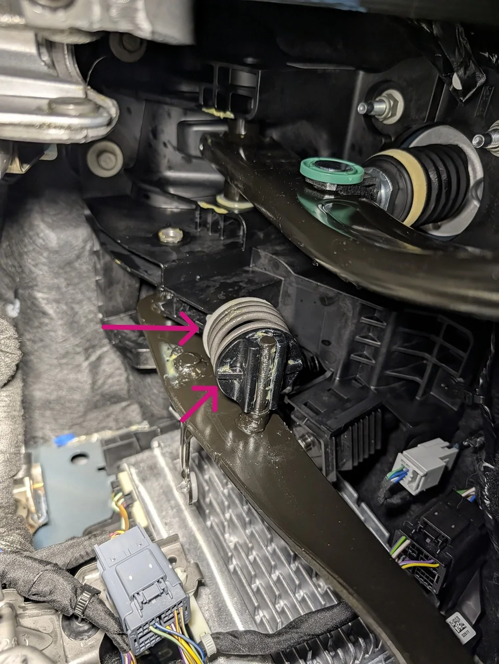

Had the exact same issue on my dark horse. It’s where the spring contacts the plastic perch. Pull the spring and perch and lithium grease around the edge where the spring and perch touch and the perch mount points while you are at it. Eliminated my squeak completely

Second diagnosis by @Shadowblackbeast. However, my solution was conceptually but not procedurally the same. That exact squeak emerged about a week after I picked up my 2026 DH. Having done one clutch spring replacement (on an S550), I didn't really want to risk/repeat the torture. IDK, maybe the procedure is easier on the DH. So, I used a little (very little ) LPS 1 arisol lubricant. Been squeak-free for +500 miles.

Can you send a quick video or photo of this procedure please

I guessed at what was causing the squeak, placed a piece of cardboard behind the clutch lever, and shot a touch of dry lube on top and bottom of the perch. Odd, because as you can see, there's quite a bit of grease on there already. What I can't attest to is whether I inadvertently sprayed a bit above the perch (my aim at that angle wasn't great), which may have caused or contributed to the squeaking.

Thanks i appreciate it
