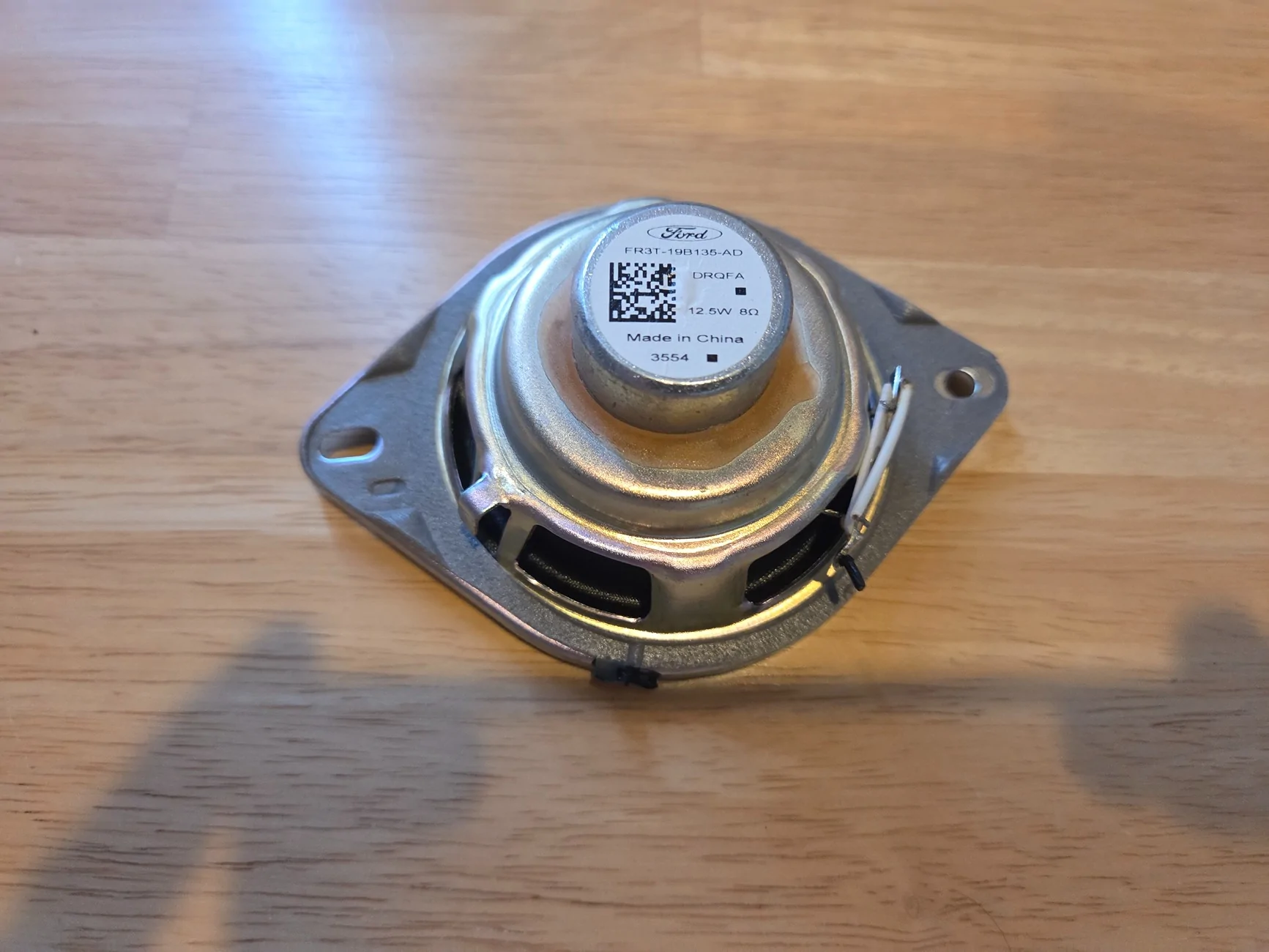

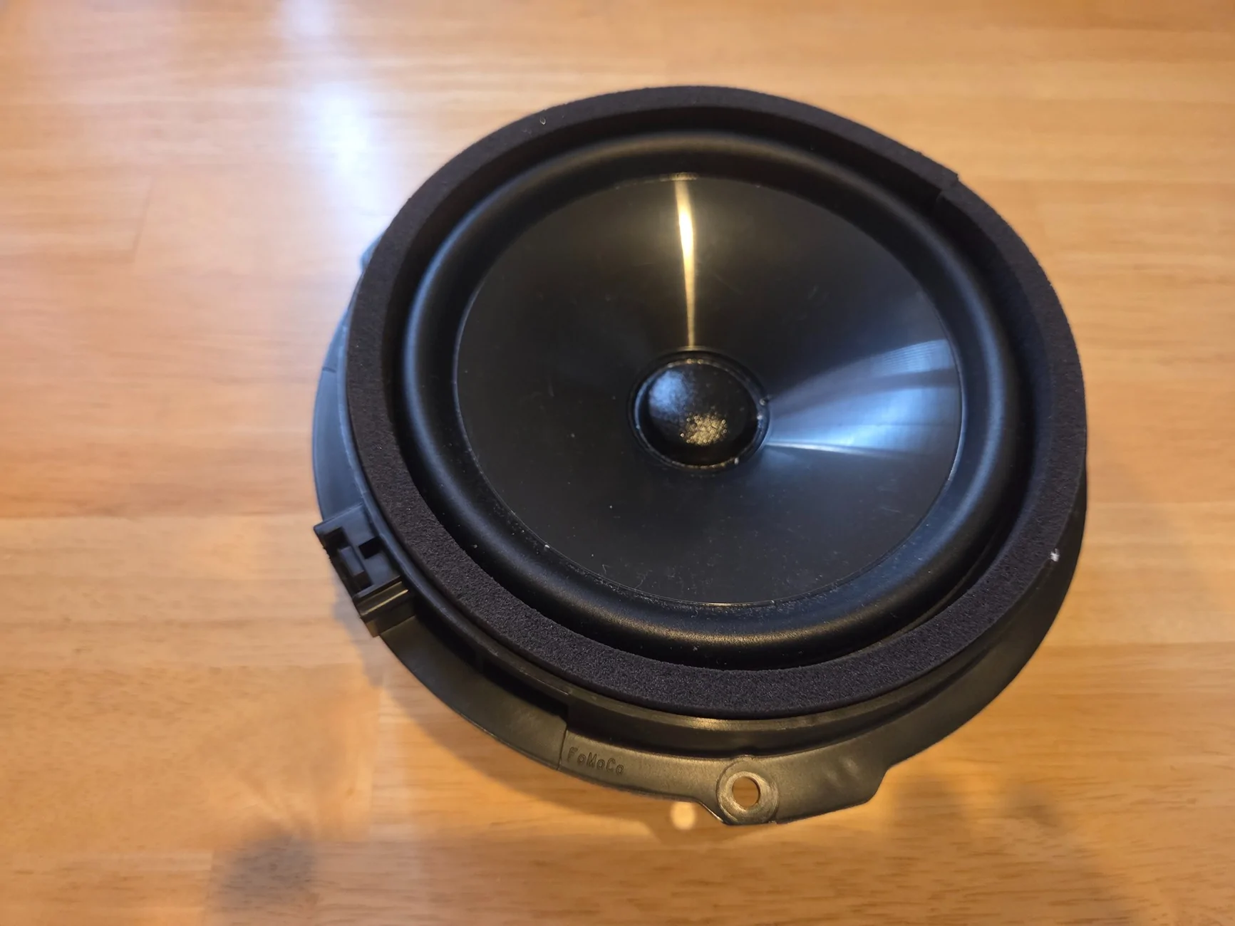

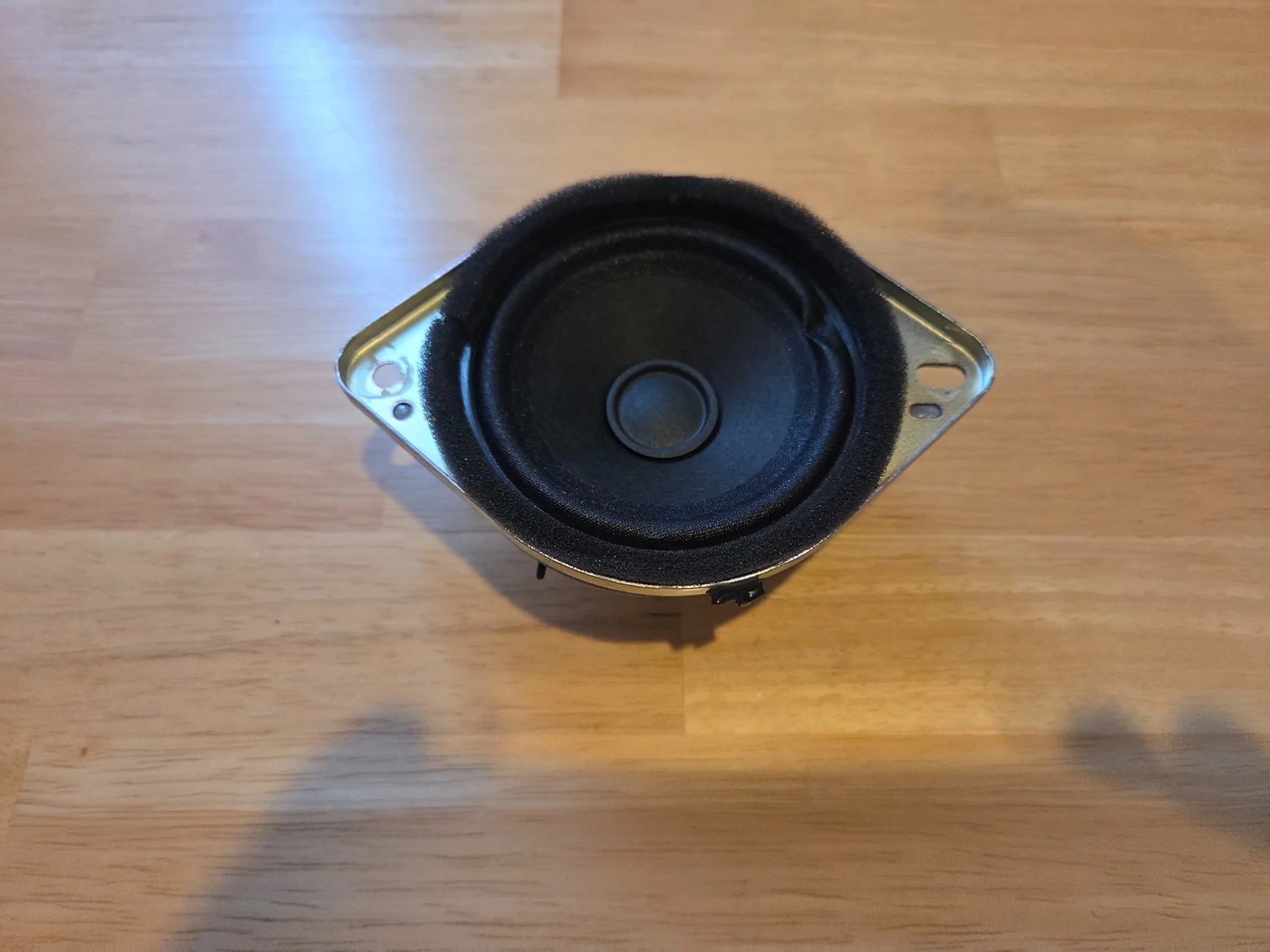

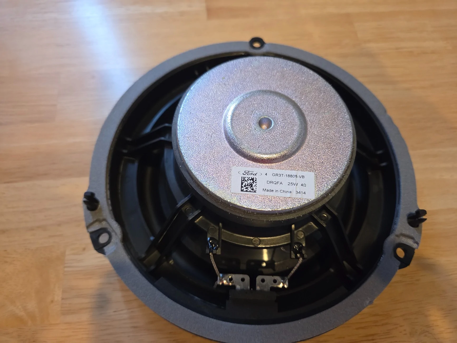

I had the 2 upper speakers and 2 lower ones in each door replaced.
The 2 upper ones were 3.5" 12.5W 8-ohm. The 2 lower were 6.5" 25W 4-ohm.

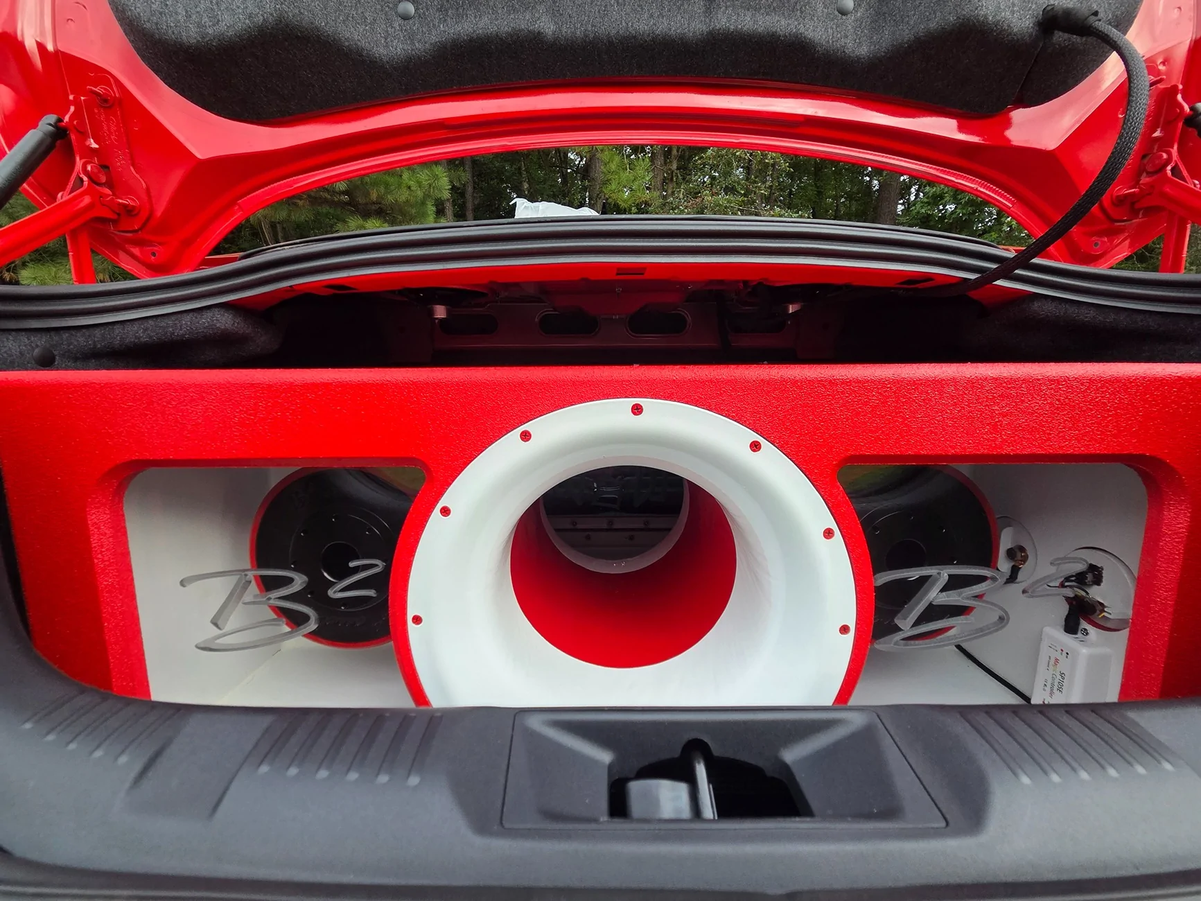

Already got the 4'th Order with 2 10" B2 subs and 1.5K SALT Sundown Amp with AudioControl L2Ci Pro. The stock alternator handles it just fine.
