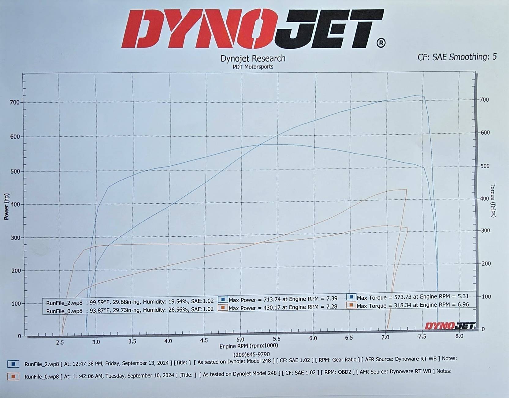

I have a Stage 1 kit in my car. It is completely stock: exhaust, headers, everything. During the install, I chose to go with a 3.75 pulley and a bottle of boost. I put down 713 rwhp. No issues or errors; the car runs great.
No limits on throttle or whatever they say happens? Are you still using the belt it came with?

Nothing yet stock belt stock everything no limitation I do run boosting because we're in California 91 gas is garbage

How much boost does the 3.875 that Comes stage 1 make? And how much boost does the 3.75 make?

Is 3.75 the lowest you went?
Yes just one pulley down. Never ran the 3.875 still have it but I assume pulley and boostane are good for 40ish rwhp as most stage 1 completely stock down to 91 I'm seeing 670's
