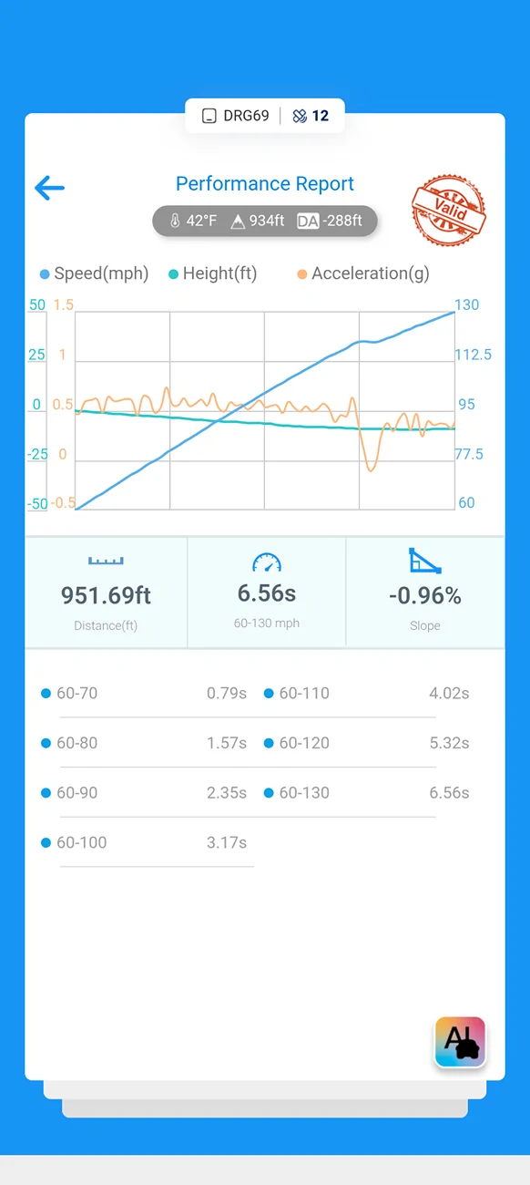

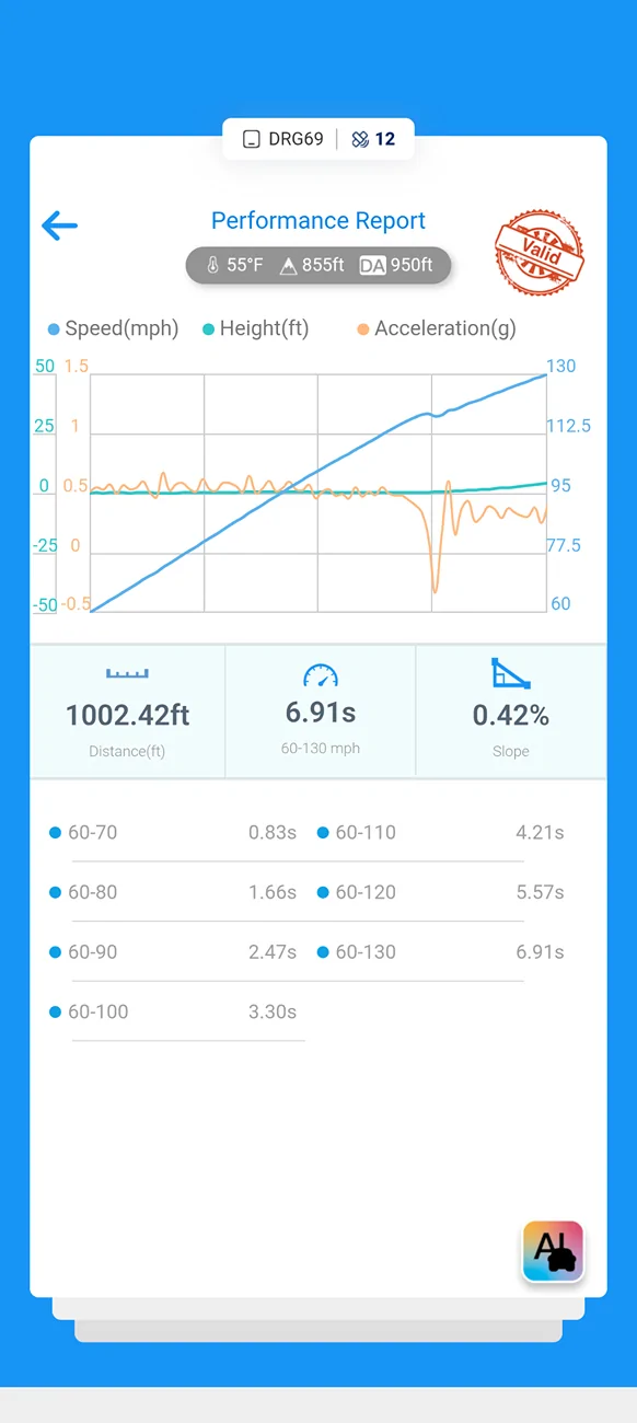

Stage 1 MT-82 on e30. I ran the 6.56 last year. The DA and slope in that run were better but not sure how I lost 4 tenths 60-130. Will a tune help me make a faster pass? I was expecting to run closer to my fastest pass with the headers I had installed

You can’t compare negative air to 950+, a 1500 ft differential is huge
Negative is basically seeing fractional boost
Did you go catless? That’s the bulk of the gains on headers N/A

I'm boosted but yes catless. I didn't think that much DA would make a huge difference.
3,012
2,997
Did you only do one run? Did you datalog it?

No did about 7 runs last night. That was my fastest time. I tied it starting in 2nd gear but spinning a little bit. I didn't log it.

what is that huge dip in acceleration and speed on the 4th section of the graph? You're losing huge time there. Is there a corresponding power curve dip?

Shifting from 3rd to 4th gear. Pretty sure there's tons of clutch protection in the tuning on the mt82 cars. That's shifting as fast as I can

Is it stage 1?
Yes D/A affects boosted cars as bad if not worse, hell even the 42-55 temp difference is a big deal.
You’re starting at like 40-45 mph right?

First thing to look at could be timing and knock. Maybe your fuel isn't as good as last time
Thanks! Next time I get the car out I'll try and log it. Looks like it's going to be cold for the next few weeks đź«©

Yeah it was pretty humid last night too. I'll see if I can replicate the temp and DA sometime soon
