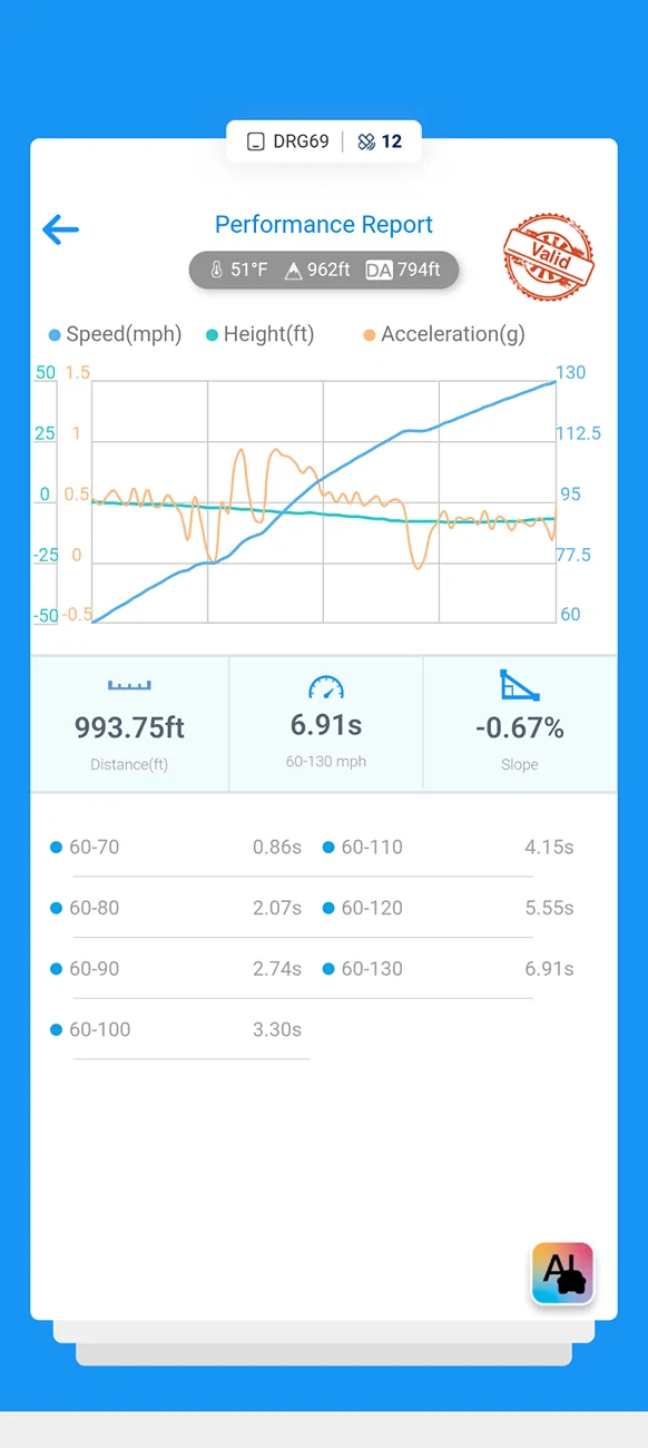

Your first run, in addition to 42° air and a density altitude below sea level, is run on a 1% downhill slope, with gravity assisting by adding 0.17 m/s²
The second run is half a degree uphill, gravity dragging 0.0787 m/s²

LOL, I just noticed the "Height(ft)" green/blue line. You can see the downhill run on the first graph.
I also ran this one that night starting in 2nd gear with a negative slope. I was just hoping to pick up more with the headers. Guess I need to pulley down and then
