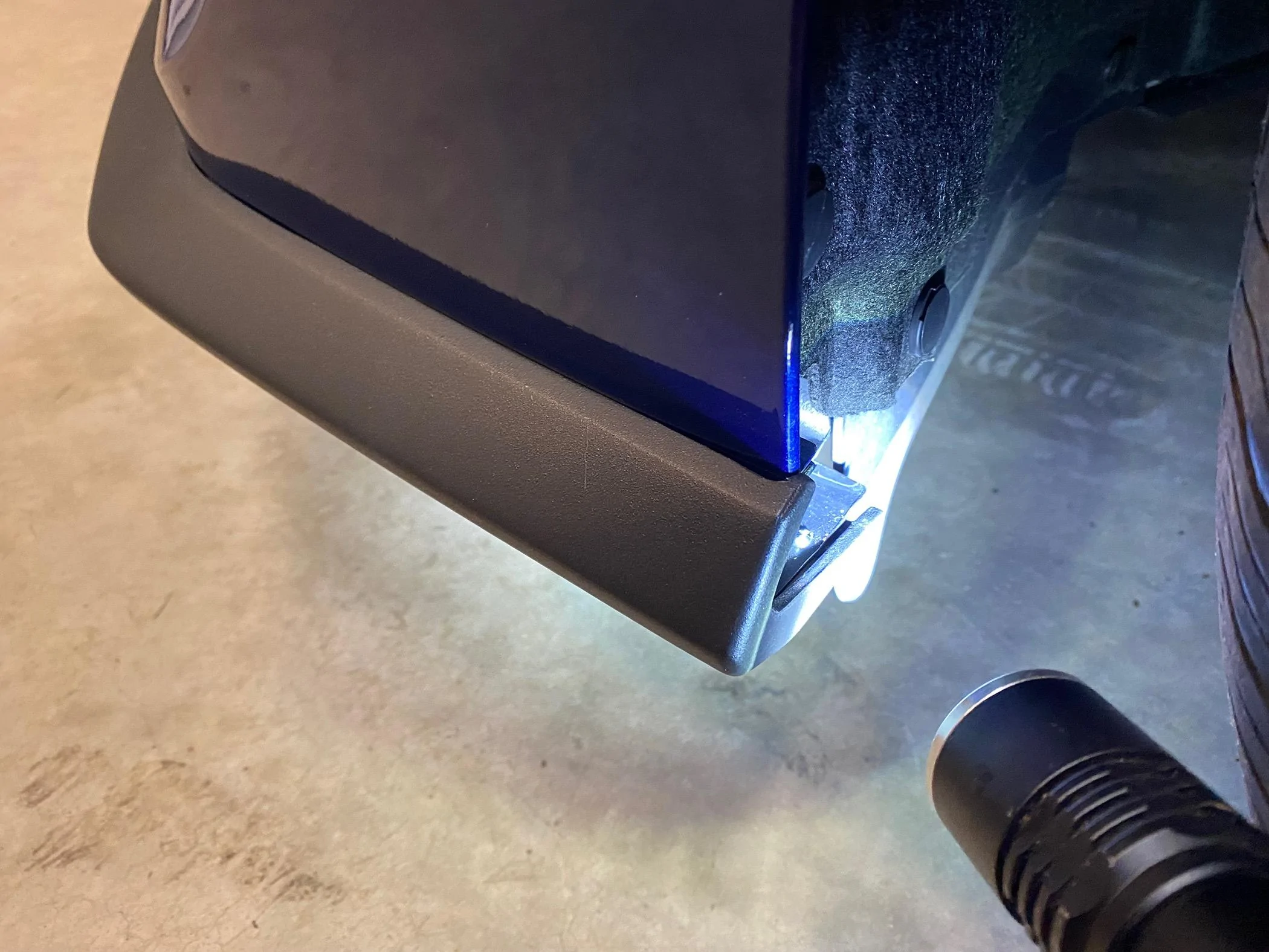

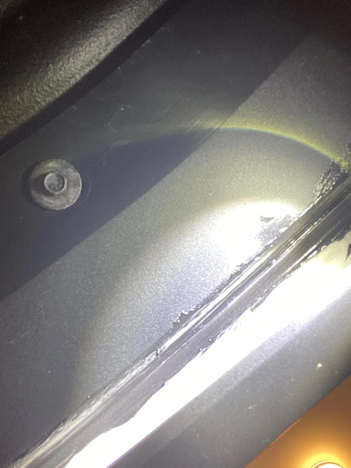

After getting the ford splitter home, I test fitted it several times. There is double faced tape preinstalled that goes down on top of the existing small front lip and it hooks into the front wheel well, including a portion at the bottom. It also comes with a small cleaner pad and a small adhesion promoter pad, as well as a tube of black adhesive.
The instructions say to put the adhesive (you will need a caulking gun) in the hollow of the splitter, and to not let it touch the double faced tape. When I test fitted the spoiler, it was clear that when properly lined up, the channel where the instructions said to apply the adhesive would be about an inch away from the bumper, and not much use.
I put the car up on ramps and after cleaning and using the adhesion promoter, attached the spoiler using the double faced tape. I then drilled a pilot hole up through the flat end of the splitter where it overlapped the horizontal portion of the fender well on each side, and put in a short self tapping screw through both.
From the bottom, using the caulking gun, I put the adhesive along the back edge of the splitter, at the top, where it was made contact with the front of the car. I had a rubber glove on, and used my finger to smear a decent layer of the adhesive into the crack and along the edges.
I let the car sit for 24 hours and then took it for a long drive at good speeds, stopping every now and then to check the splitter. I have since washed the car and checked the splitter, and it has not moved and feels very secure. I have my doubts that following the instructions would be as secure, but overall it was easy to install and a couple of extra steps only took a few minutes.
I will attach pictures that show the end of the screw and location, along with a picture looking straight up from the ground at the splitter, showing the area where I applied the adhesive.
