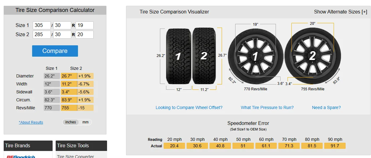

PHASE 2: 19" LMR SVE DHP1 + 305/30R19 and 315/30R19 + Steeda Sport Progressives
RESULT: No rub but it was very low (3.5" ground clearance to splitter) and the front splitter was scraping on everything it possibly could
After watching Hamond take his NON-HP DH and basically make it a HP with 20" wheels I have started to tinker with the idea of this.

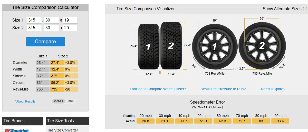

PHASE 3: 20" APEX VS-5RS wheels (details below) + Steeda Minimum Drop Springs (already on the car) + 285/30R20 and 315/30R20

- Wheels: Apex VS-5RS 20x10" ET35
- Tires: 285/30R20 Michelin Pilot Sport 4S
- Why it works: Dropping the front wheel width down to a 10-inch barrel ensures the 285 tire sits perfectly square with a meaty sidewall lip protector. Because the ET35 offset pulls the wheel face away from the physical edge of the fender flare, you can run a standard factory street alignment (no extreme track camber needed) with absolutely zero risk of rubbing the fender lip or active MagneRide struts. [1]

- Tires: 315/30R20 Michelin Pilot Sport 4S
- Why it works: The 315-width tire sits perfectly square on the wide 11.5-inch Apex barrel, giving you a massive footprint to hook up your supercharger's instantaneous torque while preserving deep concave wheel lines. The +48mm offset lets the wide tire sit cleanly within the factory independent rear suspension (IRS) cavity without rubbing the inner liners or shock boots.
When you go to order your tire set, make sure to look for the "FP" (Ford Performance) or standard Mercedes/Porsche specification variants of the 315/30R20 Michelin PS4S, as they are specifically engineered with a slightly wider, squarer shoulder profile to optimize wheel lip protection on high-width wheels.
- Rim Lip Protection: Both the front and rear tires will feature flat, square sidewalls. Your forged wheel lips will sit completely shielded behind a thick rubber tire bead protector.
- Splitter Insurance: Dropping down to the 30-series aspect ratio on a 20-inch tire bumps your overall tire height up just enough to safely raise your aggressive Handling Pack front chin splitter by 0.26 inches (6.7 mm) off the ground. This perfectly compensates for your Steeda lowering springs without altering your fender clearances.
