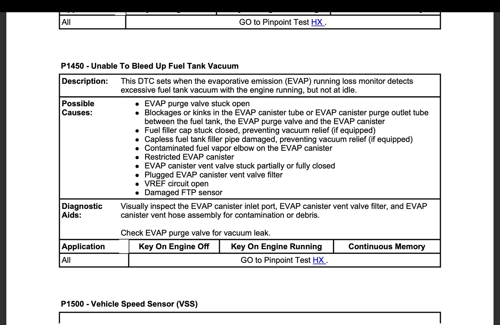

"Only after getting gas"
So once the car is started, it runs normally, accelerates normally, etc?
What about a faulty fuel pressure sensor?
