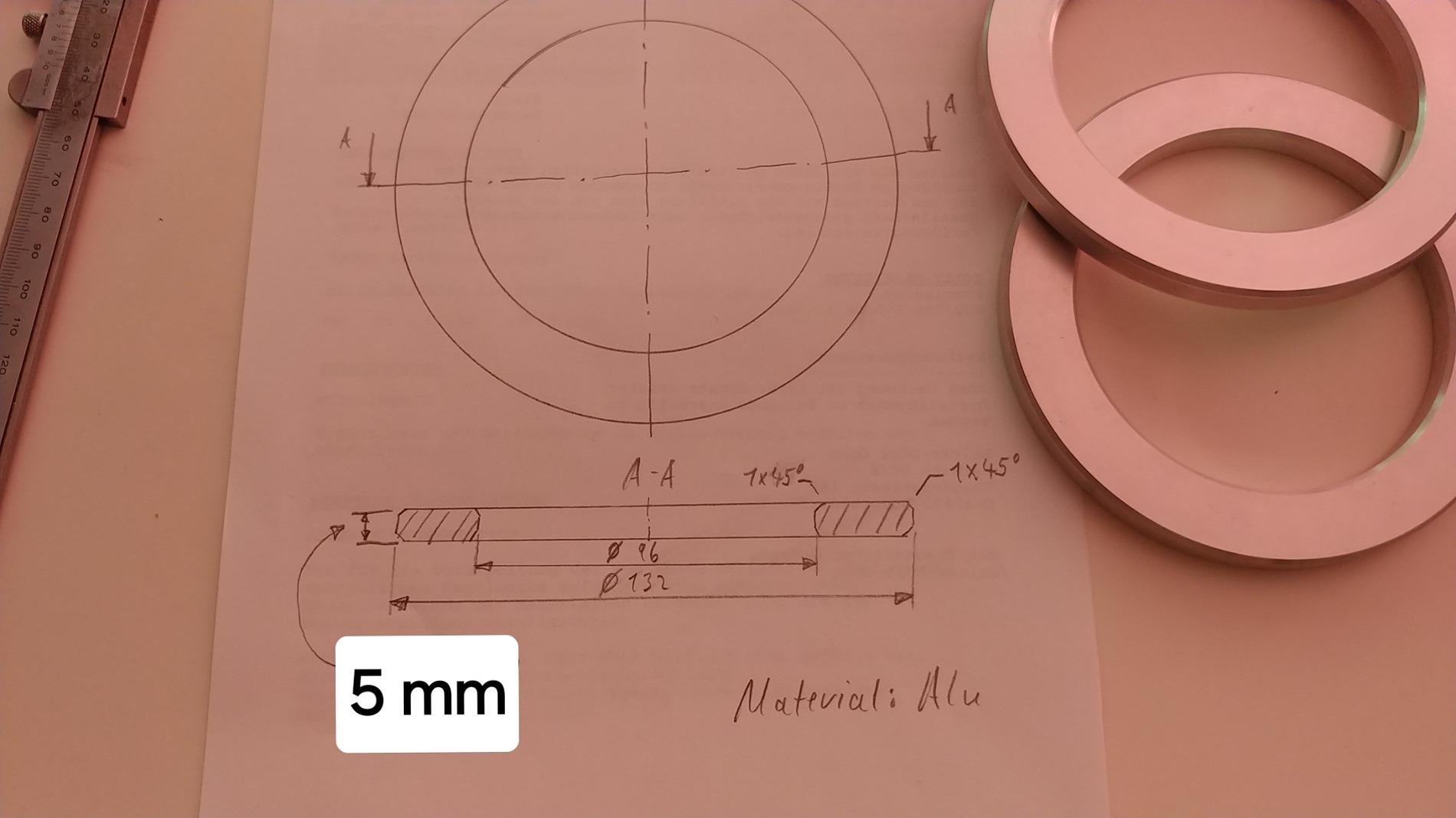

Go to a metal shop and have them make you such spacers from aluminum. It's in mm, so convert to inches):
Such 5 mm spacers will lift to around 12-15 mm I think, so the ratio is between 2.4 and 3.
They will come above the springs in the rear and are also sold by Steeda in case you can't find a shop.

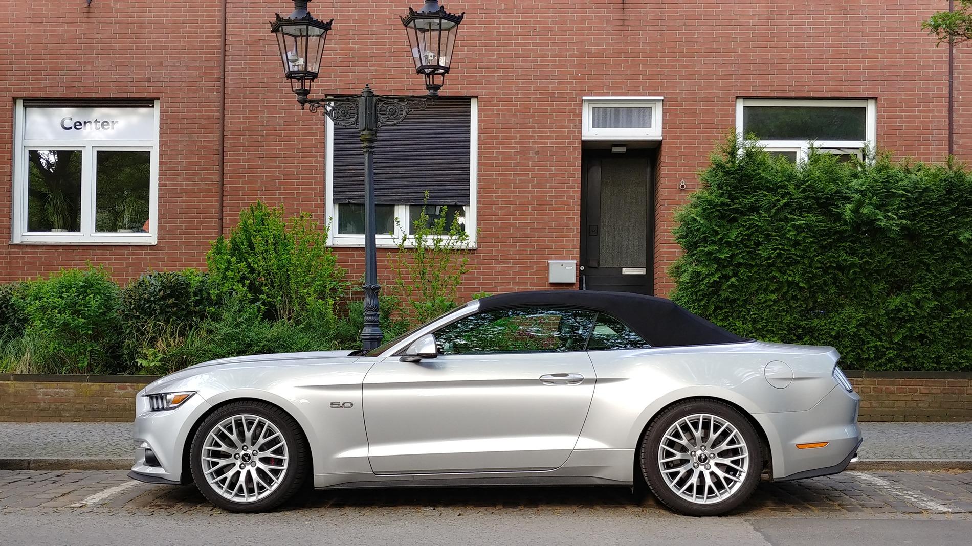

These leveled my S550 with Eibach Pro Kits almost perfectly:
