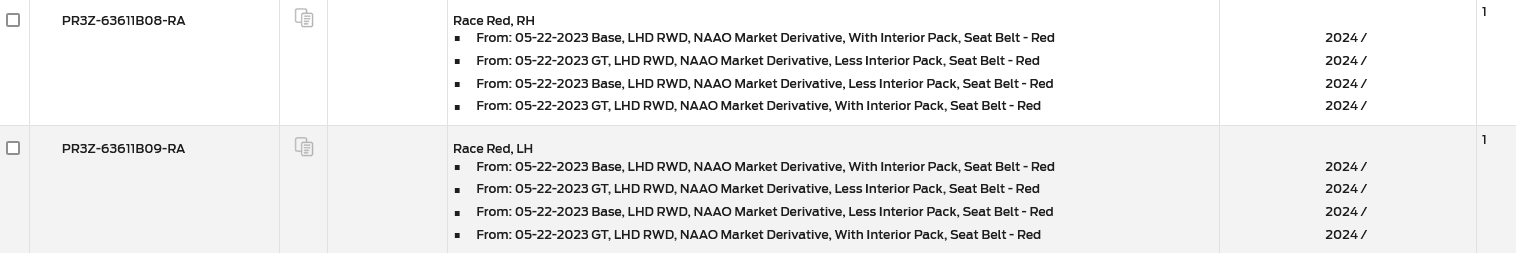

here are the part numbers for each of the race red seatbelts
prices seem to be ~$250 USD for rear, and ~$350-$400 USD for front
Coupe
Driver Front (coupe): PR3Z-63611B09-RA
Passenger Front (coupe): PR3Z-63611B08-RA
Driver Rear (coupe): PR3Z-63611B69-RA
Passenger Rear (coupe): PR3Z-63611B68-RA

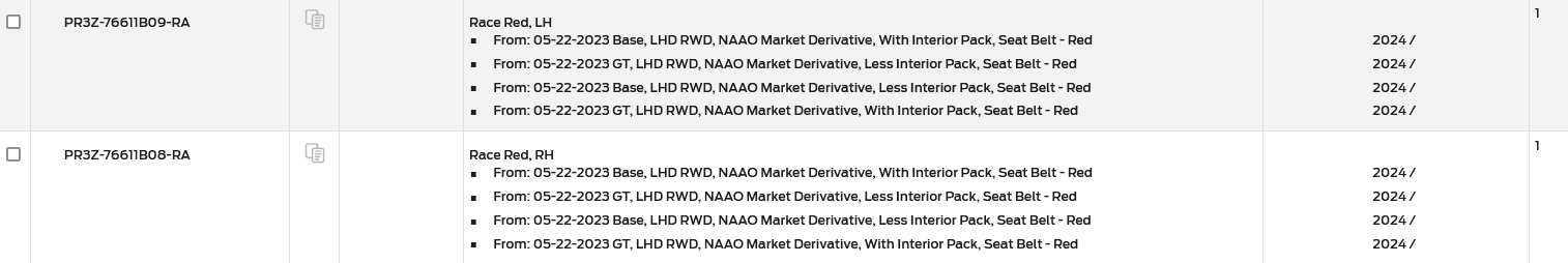

Convertible
Driver Front (convertible): PR3Z-76611B09-RA
Passenger Front (convertible): PR3Z-76611B08-RA
Driver Rear (convertible): PR3Z-76611B69-RA
Passenger Rear (convertible): PR3Z-76611B68-RA

These are the part numbers I got for a coup:
Driver Front: PR3Z-63611B09-RA
Passenger Front: PR3Z-63611B08-RA
Driver Rear: PR3Z-63611B69-RA
Passenger Rear: PR3Z-63611B68-RA
