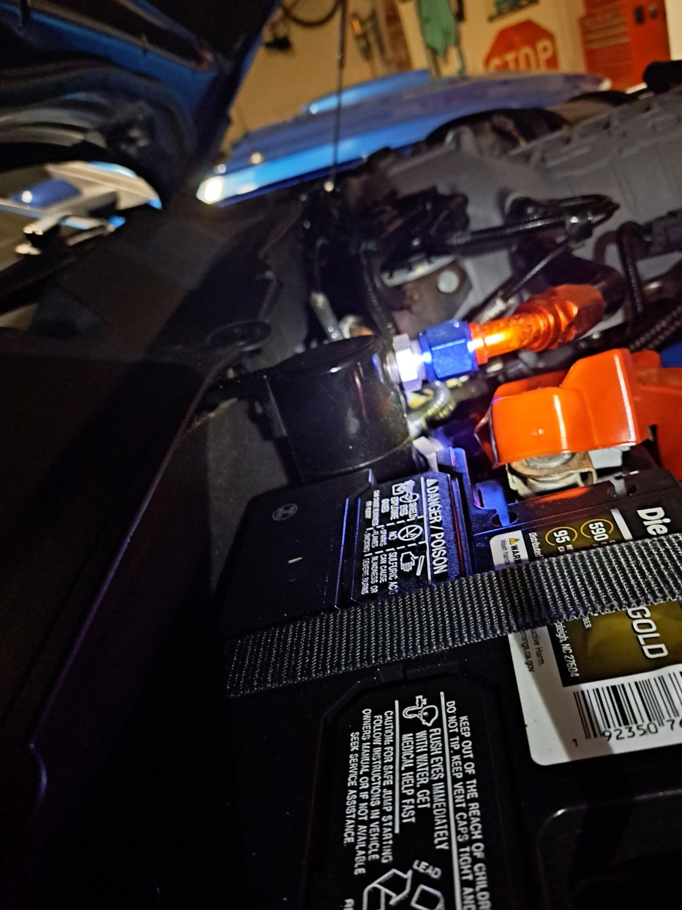

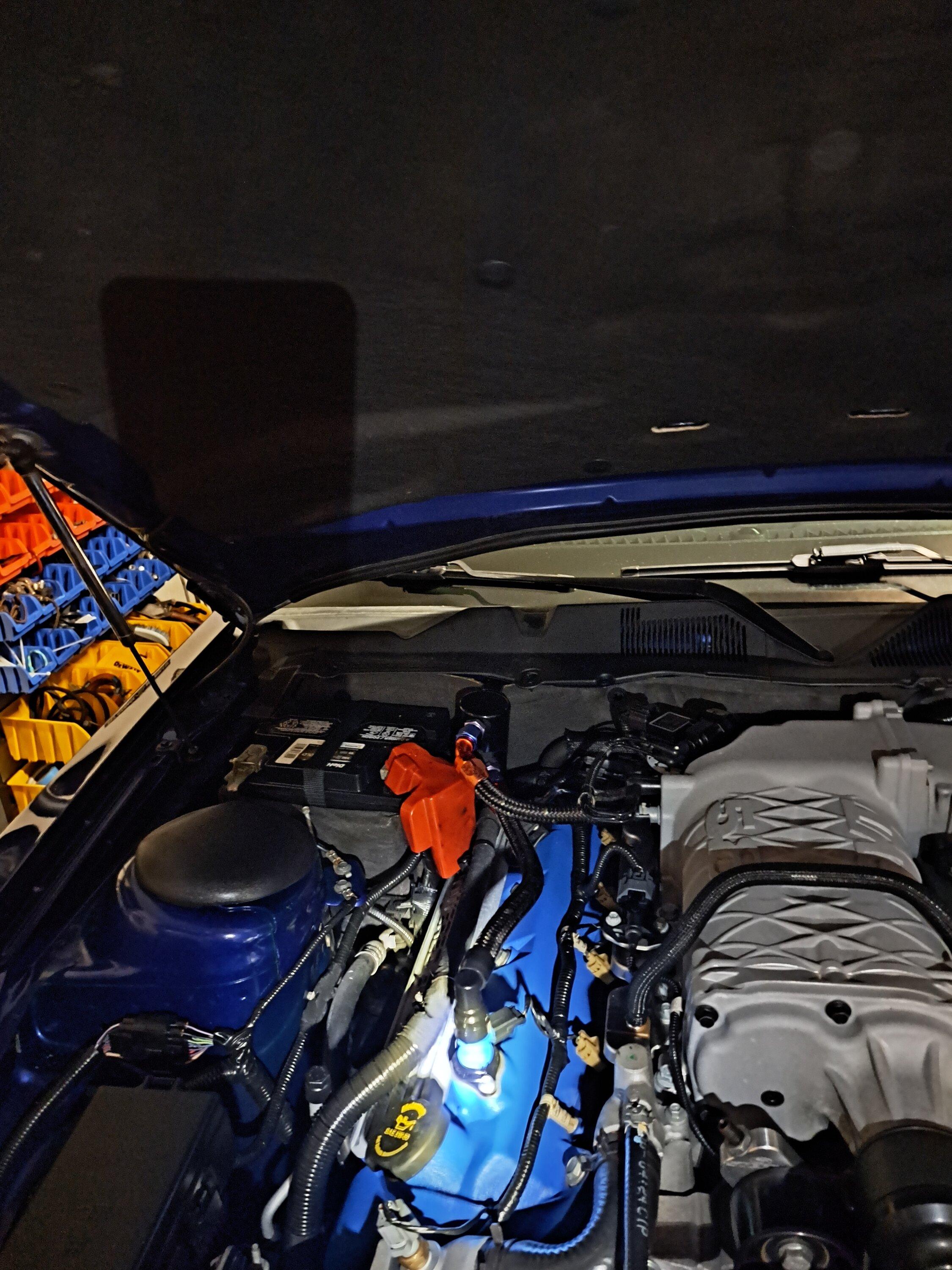

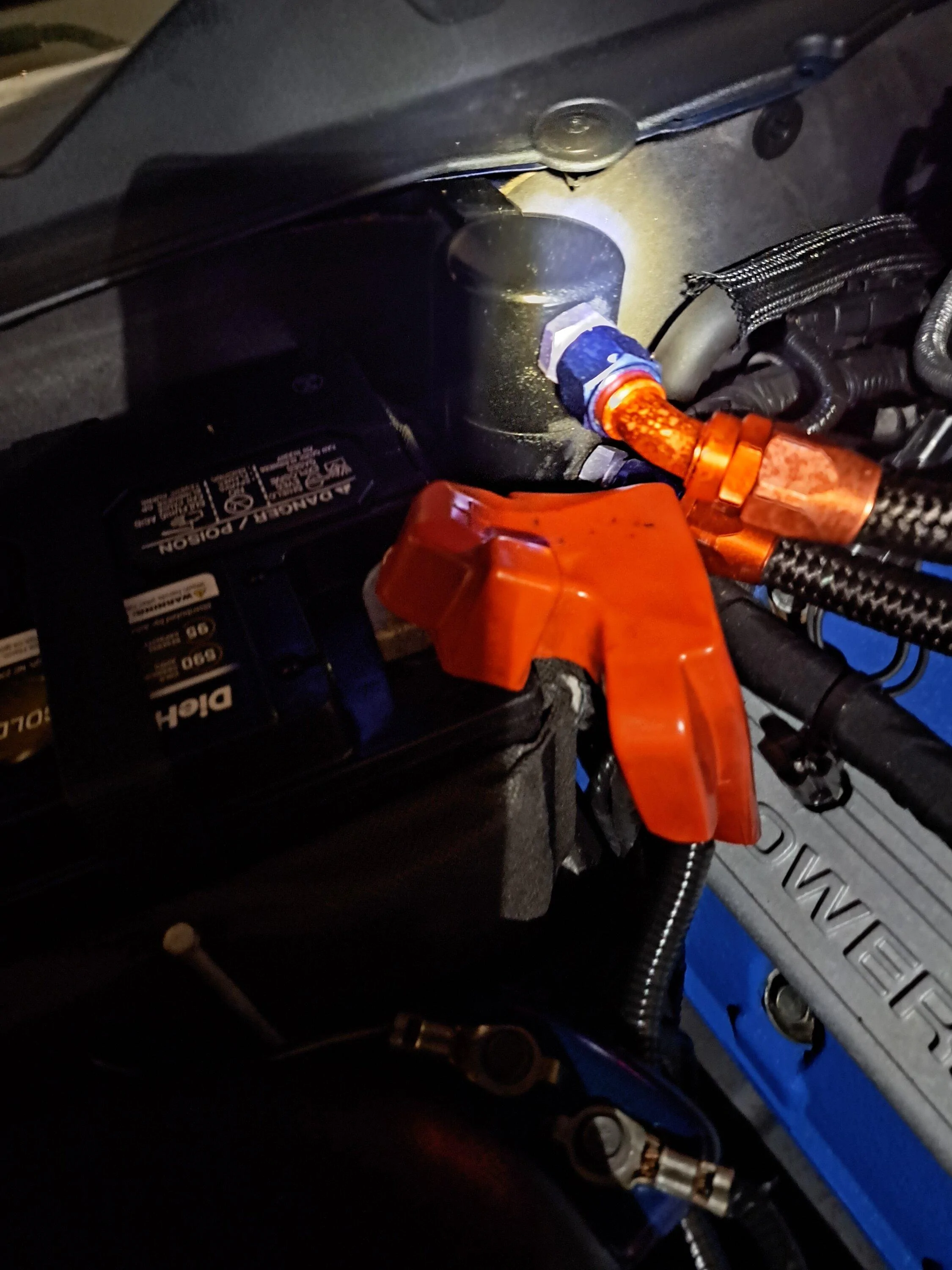

Hello Everyone, I know this is the 5.0 section but couldn't find a gt500 section.. I just purchased a 2013 gt500 with 49k miles. Upon looking under the hood, next to the battery, I noticed a black cannister with 2 cables that connect to I think the fuel injectors and the intake? I will post pics, but is this a nitrous hookup or what??? If not, anyone know what this is? Sorry if this is in the wrong section, thanks

No, oil evap canister
unscrew the bottom and empty every oil change

Oil Catch Can LOL..

Ok thanks guys for the fast reply. I was looking at other engine bays for the car and none of them had it. .Any reason why the previous owner would install this? Any benefits?

Keeps oil from going out of the crankcase and into the intake manifold. Keeps your intake cleaner.
