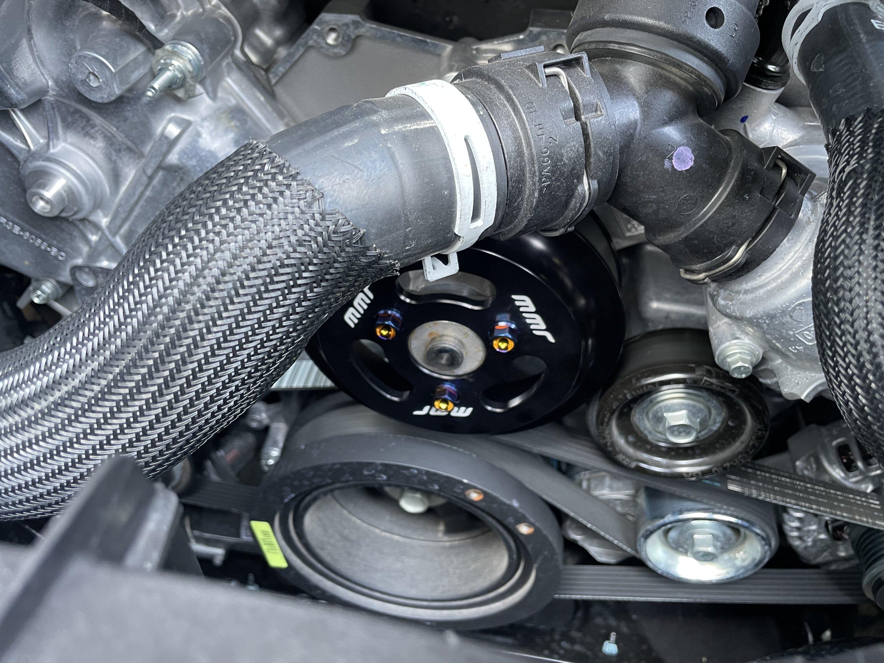

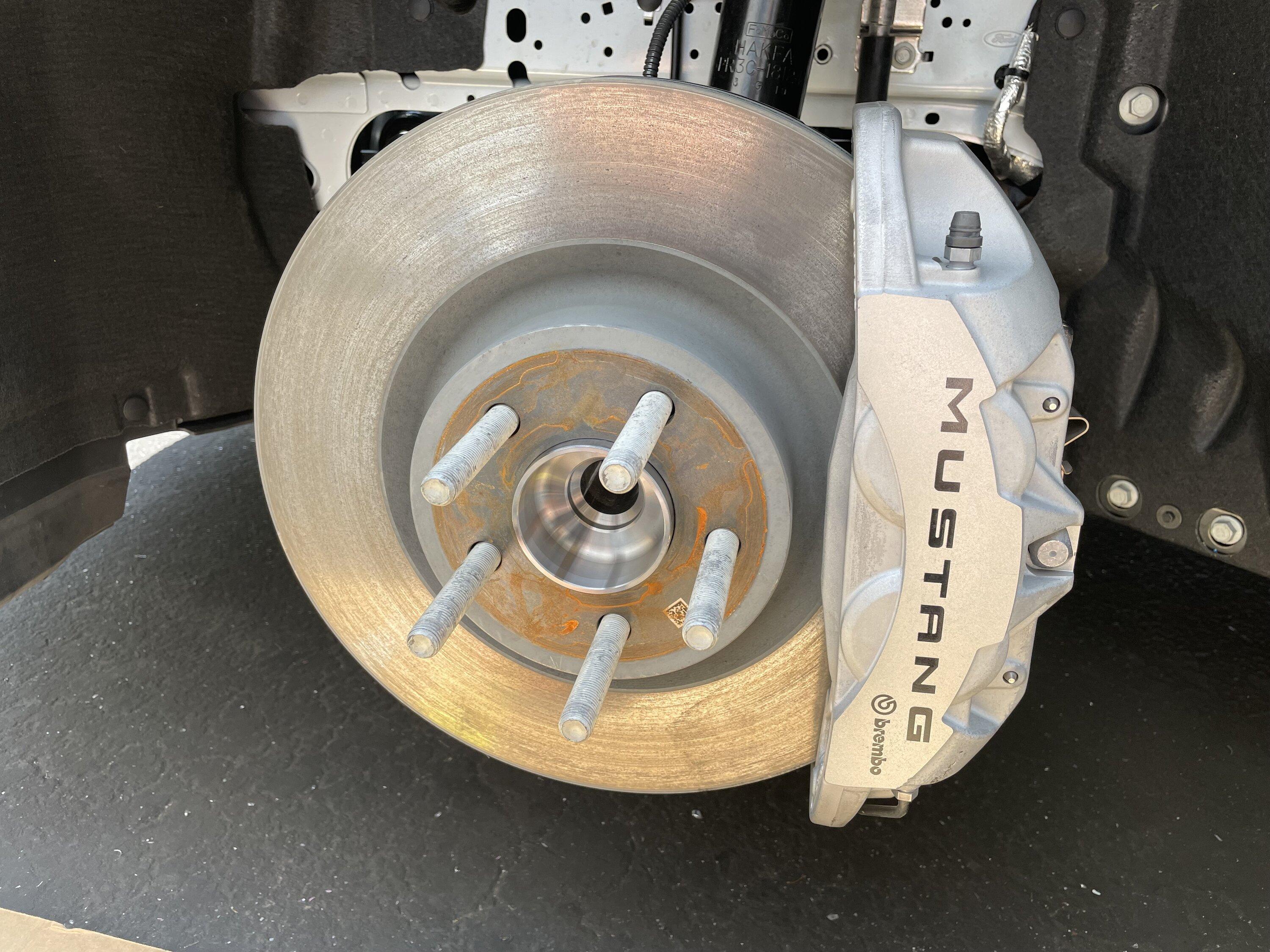

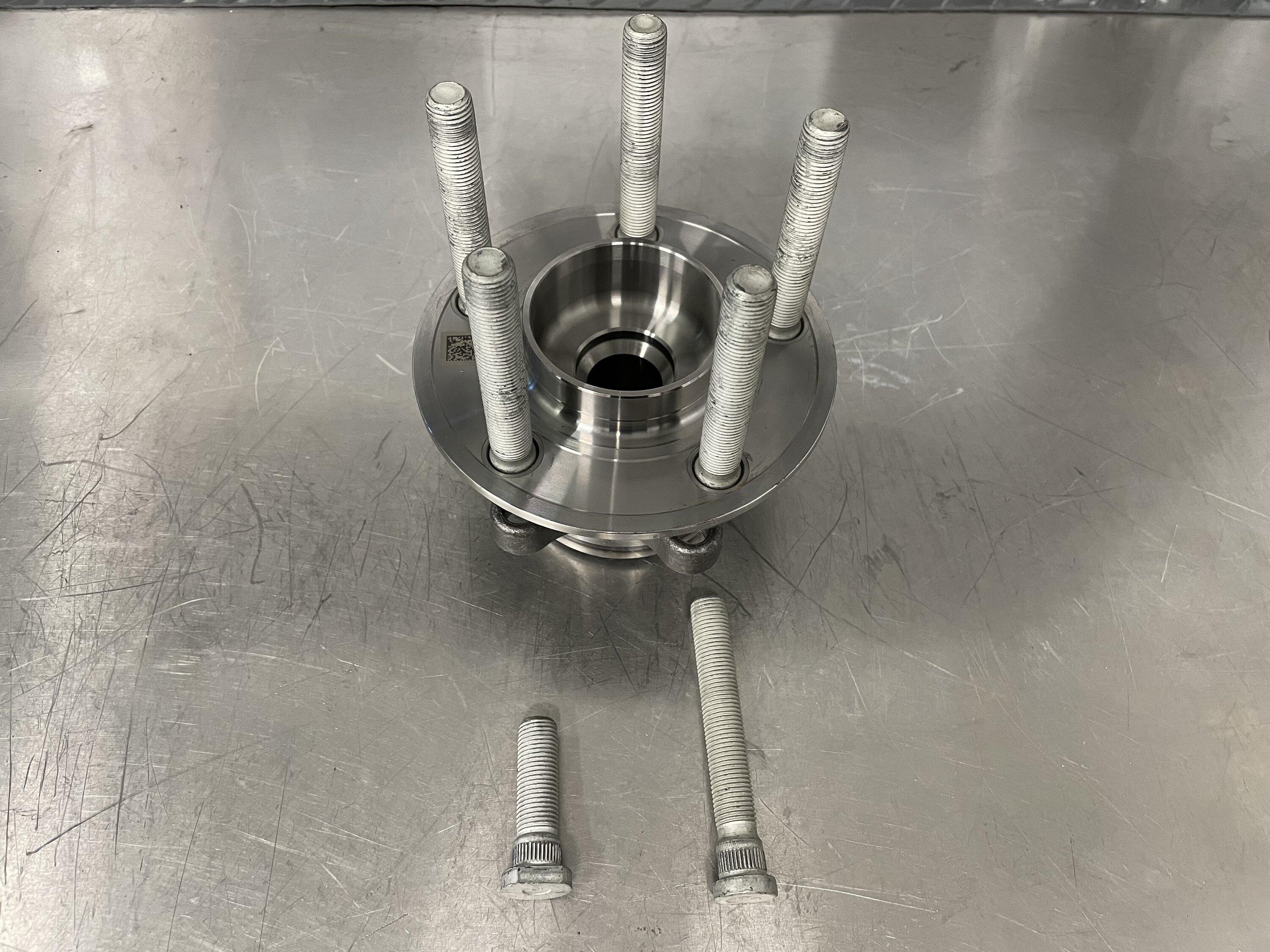

In preparation for our new S650 to hit the Road Course we started today with some basics. Getting ready for the new wheels we added a set of GT350R Extended Wheel Studs. This will allow us to get the front track as wide as possible and give plenty of choices for wheels/offsets.

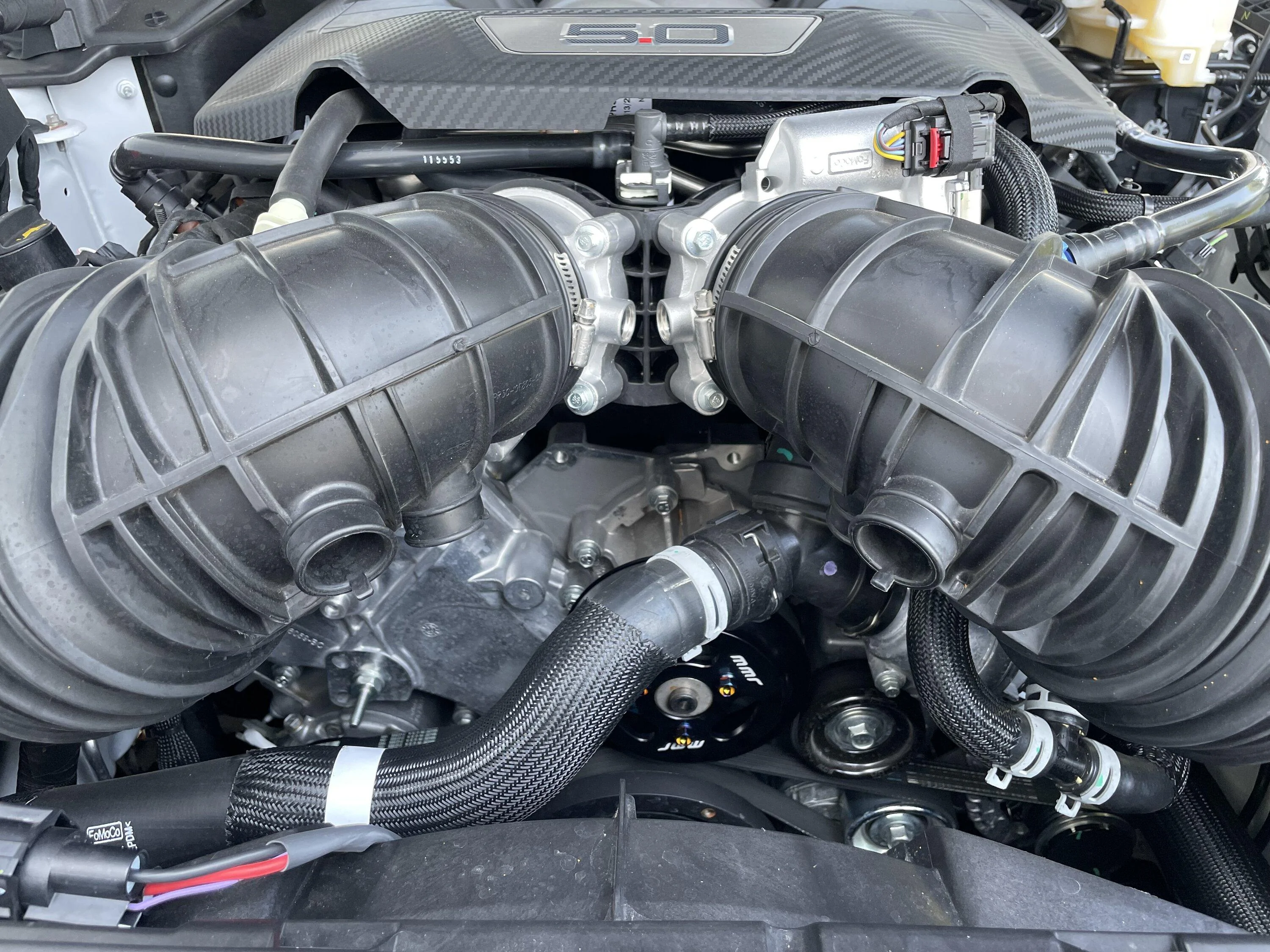

We also added our Billet lightweight water pump pulley with the Titanium bolts option to reduce parasitic loss.
Next week we will be upgrading the Rear Studs, Front suspension bushings with the MMR Sphericals and adding the MMR Billet Rear Toe arm and Camber arms - stay tuned.
