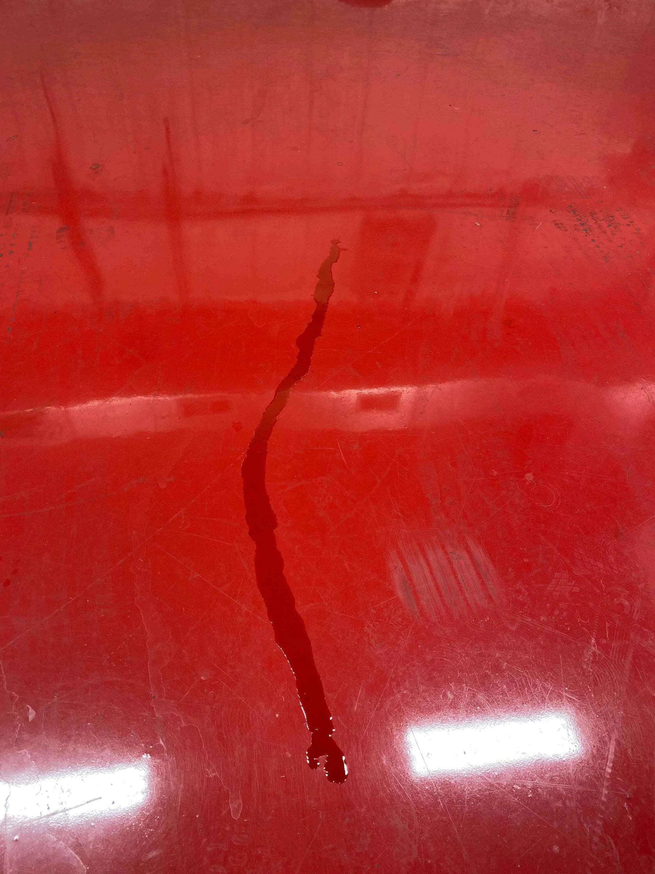

I was thinking I might get a call about the car leaking on the floor of the PPF shop. Got that call this morning. They sent me a pic. I appreciated them reaching out. Their customer service is the reason I choose to do business with them in the first place. They called first, then said they were sending over a pic. Wanted to know if I wanted them to continue forward with the PPF and tint at this time or not. I chose to move forward.
Moving back over to the pic. Drove it approx. 15 miles to their shop and parked it. I'm sure they moved it a few times. Assuming this is from around 16 hours of sitting overnight. If I can keep from going by and looking at it myself, I will be showing up with a few quarts of oil in hand before I leave to take it to the dealer. Only thing I have to scale this leak is the tire marks and the one foot print in the top left of the pic. That isn't a small oil leak. Hopefully it is an easy fix, in and out when the time comes.

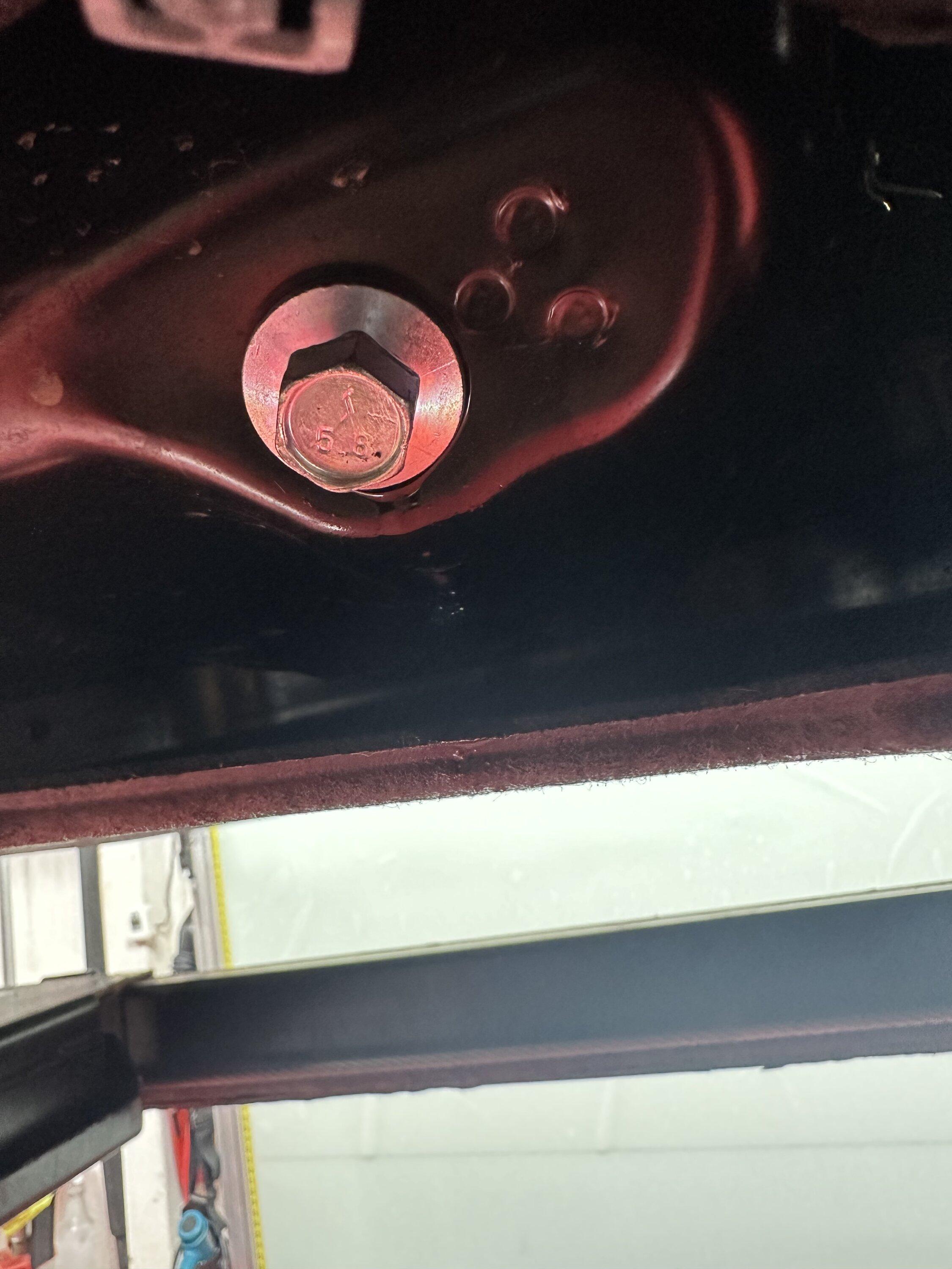

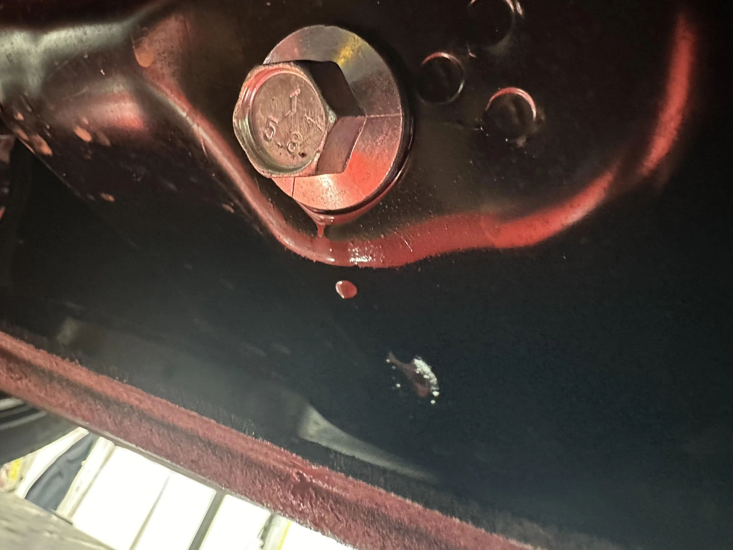

Like most of us on here, I couldn't stand it much longer after my last post. So I called Automotive Film Specialist (AFS) to see if they were ok with me coming down to take a look at the car and the leak while they were working on the car. No problem they said. So I packed up and headed down to AFS where my car was already on a lift. They couldn't have been more courteous and being on a lift couldn't have been more convenient. First things first, it was still leaking oil since they cleaned it up this morning. I looked up at the undercarriage of the car expecting to find quite a mess with oil everywhere. That wasn't the case. Right in front of me was a drip coming from the oil drain plug. I honestly dismissed that and started looking for the source. I am thinking, there is no way this is the source of the leak on a new car. also it wasn't leaking when I picked it up (that I know of or can tell). With the help of a flashlight, I quickly deducted that the drain plug was actually the source. Took a socket and turned the drain plug very gingerly assuming it might be over tightened. Nope, it was loose. It turned approx. a 1/3rd of a turn easily till it snugged up. This should resolve the issue, but only time will tell. At least my sanity is in check for the next few days till I pick her back up.
I will take a quart of oil and a funnel with me when I pick her up, just in case. I assume the car has leaked 1/4 to 1/2 a quart since it started.
The moral of the story is, check the obvious if you start having an oil leak on your Mustang.
