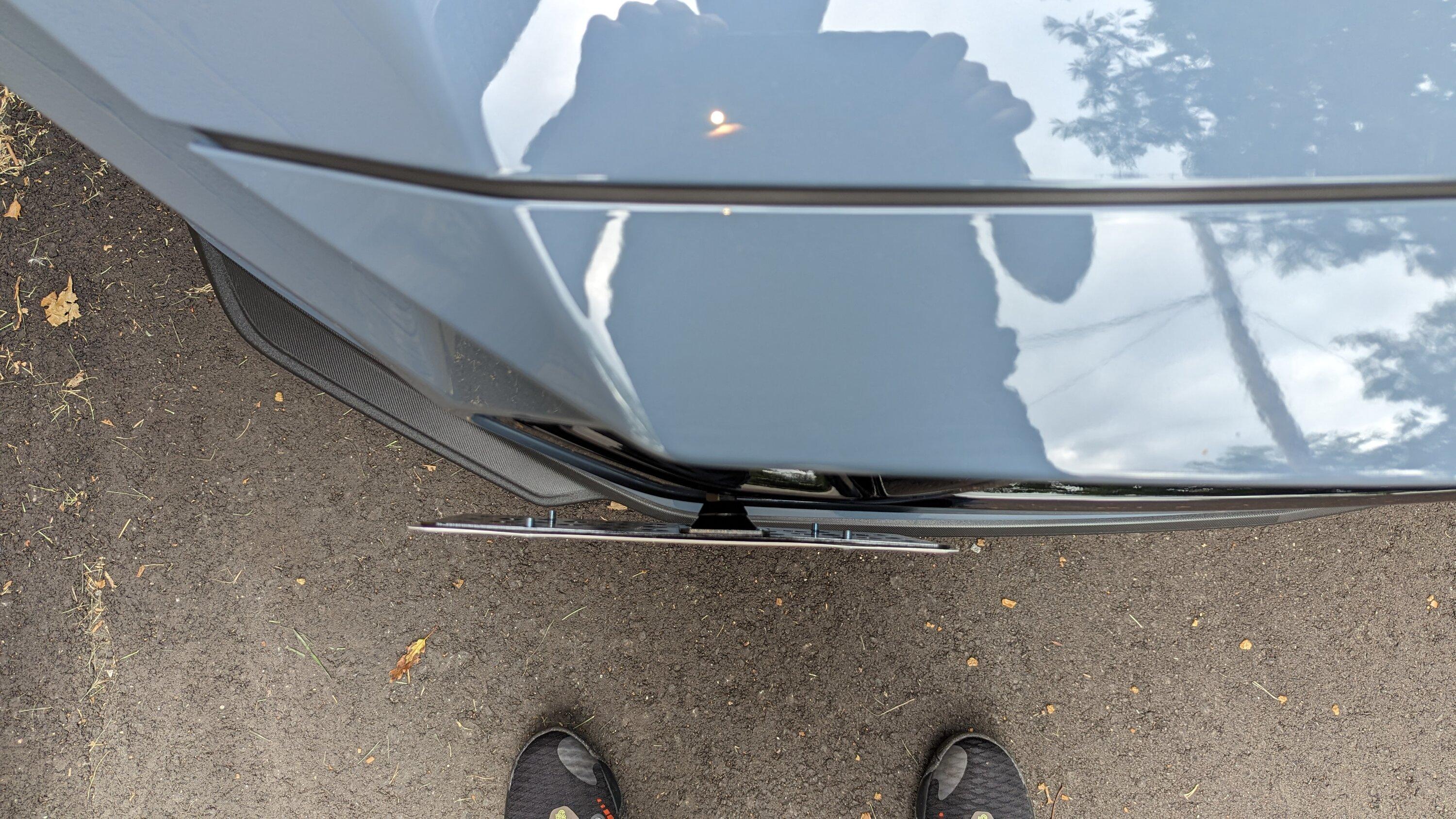

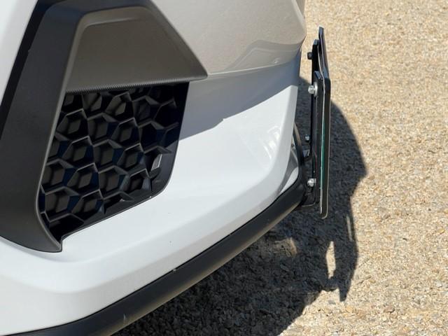

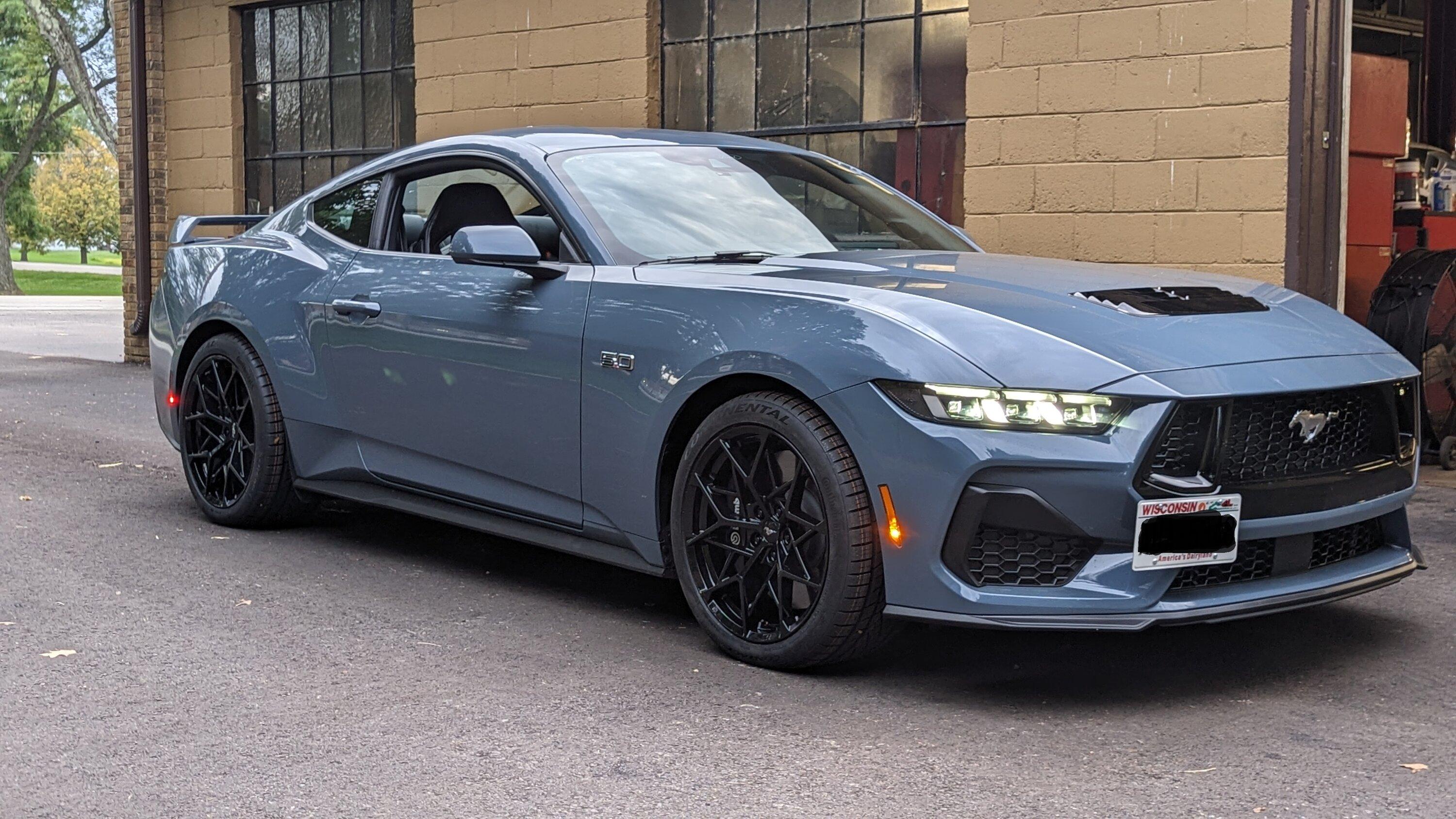

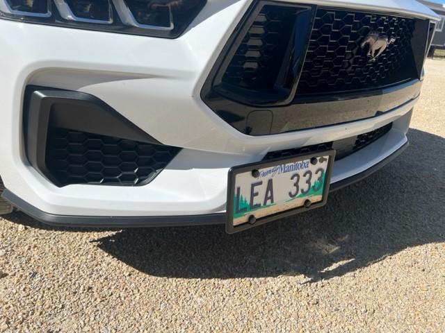

2 L-Brackets that are 6"x6". Use 2 existing screws Under the splitter/bumper.
For extra hold, I also used some 3M automotive mounting tape.
