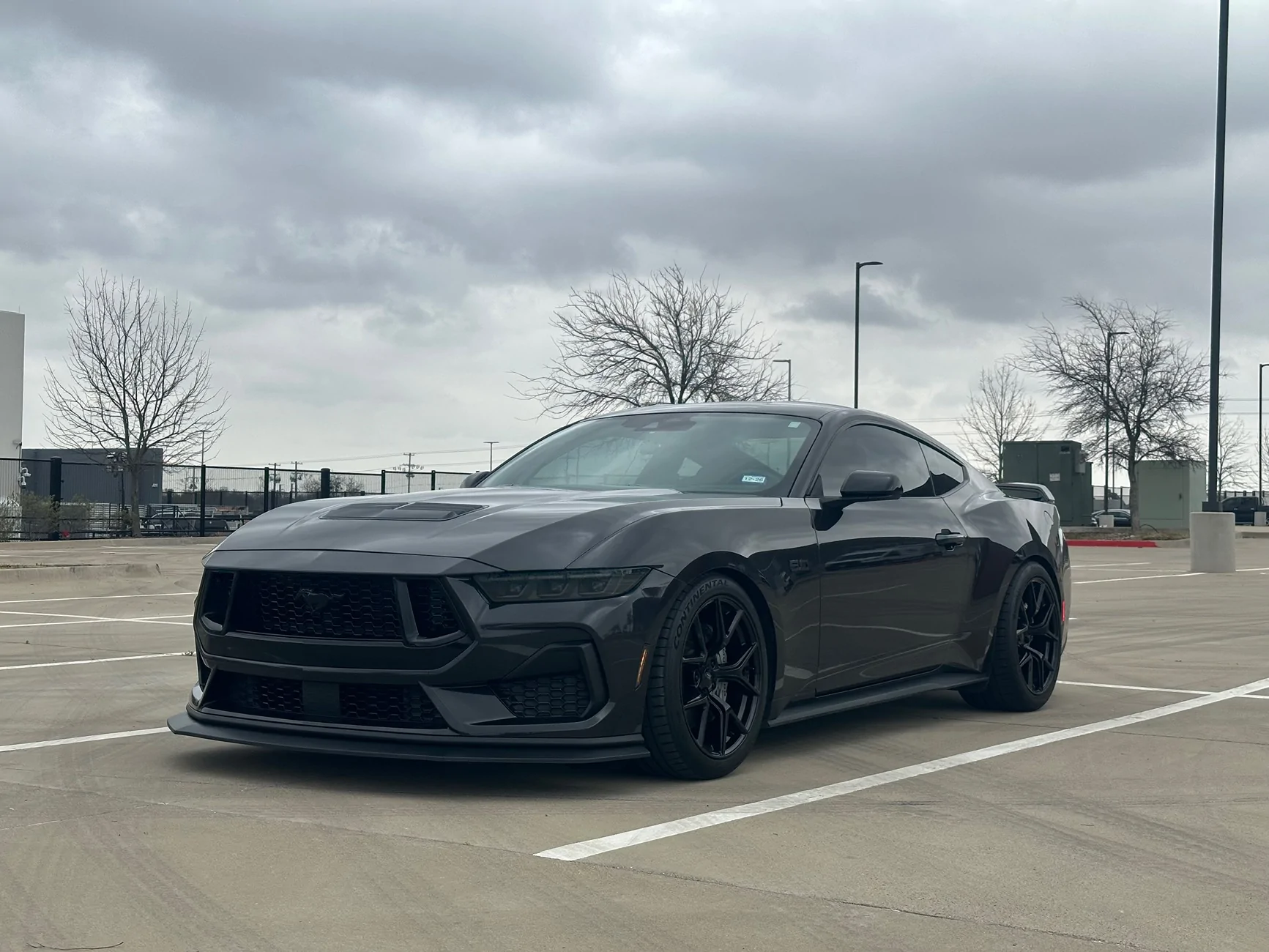

Awesome set of wheels and tires! 👍

Why so small on the front? Should have went at least 275/35
I feel like 275/35 front with 305/30 rear would give a weird stance

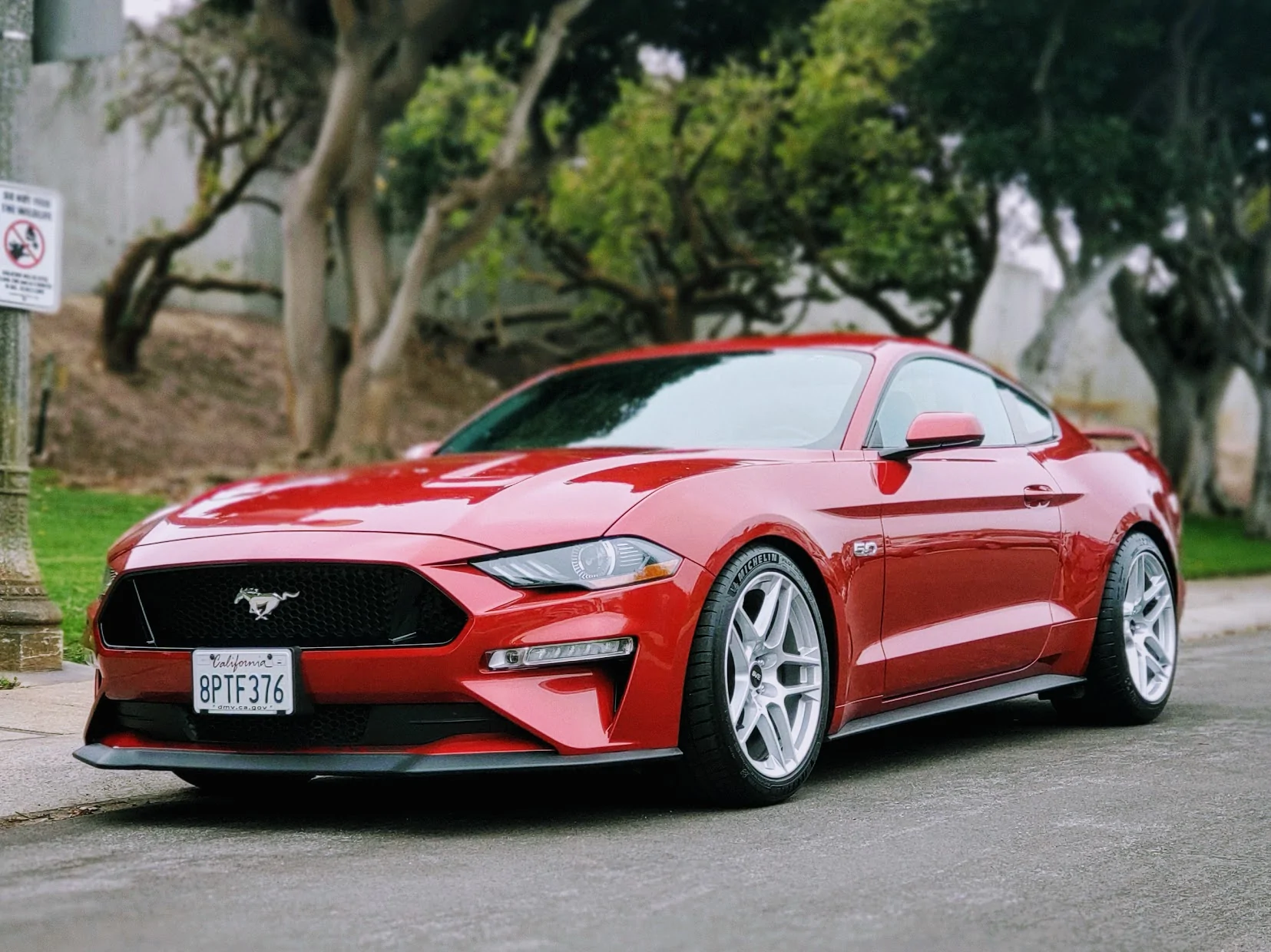

You should have run 35 aspect front and rear. What you are running now is now over 1" shorter than OEM. It looks like your car is a Performance Pack car with 255/40/19 and 275/40/19, the respective diameter for the OEM was 27.2" front and 27.7" rear. You are now at 25.5" front and 26.2". Continental does make a 275/35/19 and a 305/35/19 and this should have been the correct choice. A 35 series tire is only .3" shorter than OEM, within the tolerance of the ABS and the Stability control.
Here is my old Mustang with the 285/35/19 and a 305/35/19 looks like.
S650 Mustang New Shoes 1689201970538
Here is the difference in speedo reading.
S650 Mustang New Shoes 1780002466153-j
You will get a little more torque multiplication though...

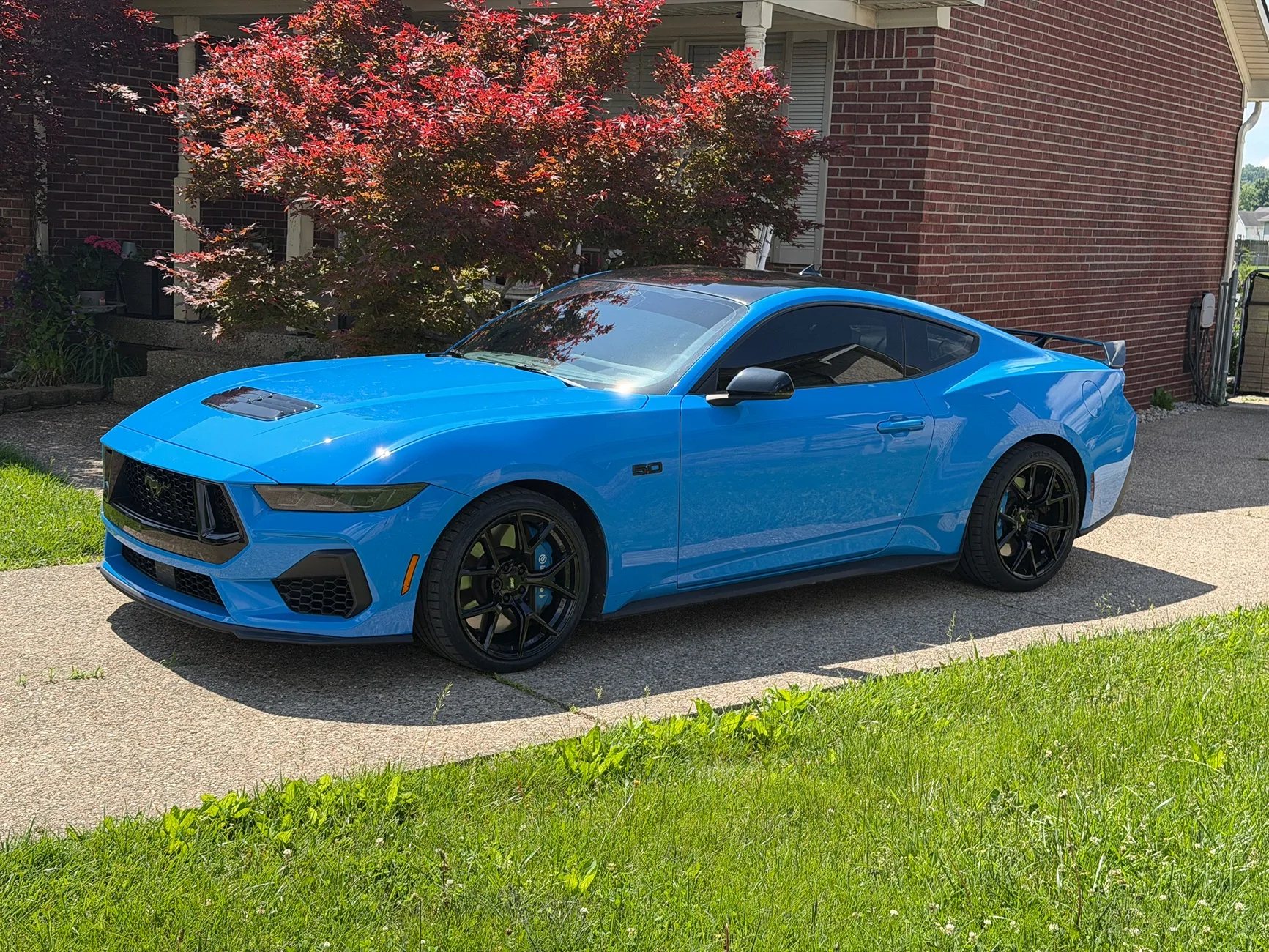

35 wasn’t available with what I was originally looking at , Michelin PS4S but then I audibled and went with Contis and kept the size.
There's more NVH with the 30 compared to the 40 but the car feels a lot more athletic overall. Handles like it’s on rails which is a result of a combination of better tires and smaller sidewall. Overall I’m thrilled with them and as this isn’t a real daily I’m good with the NVH. If I get tired of it over time the good thing about tires is they aren’t permanent and I can always change next go around 😁

I went with 285/35/19 and 305/35/19 on the same tires you have. Also lowered an inch all around.
Looks sick! I’m really liking these tires so far. I thought about lowering as well but the wife nixed that idea lol

Looks great… do the wheels vibrate at all? I’m considering SVE wheels but concerned about vibrations…

I don’t get any vibration from mine. I’m really happy with the quality of the SVE wheels and they shipped fast from LMR.

Thanks! I was considering the MHP1 when I was shopping. Good looking wheels as well

Wheels look really nice in black on the Grabber stang. Nice having a second set of wheels.
