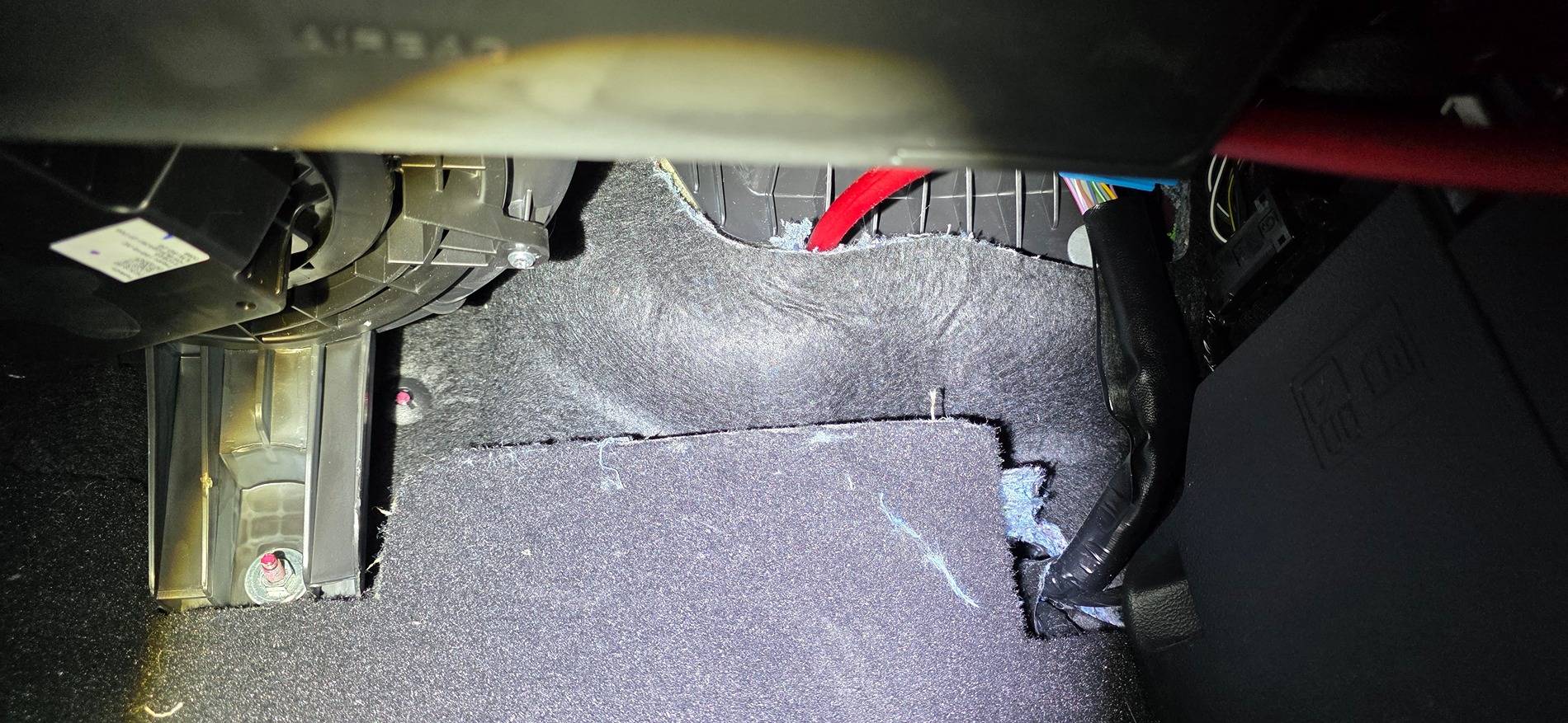

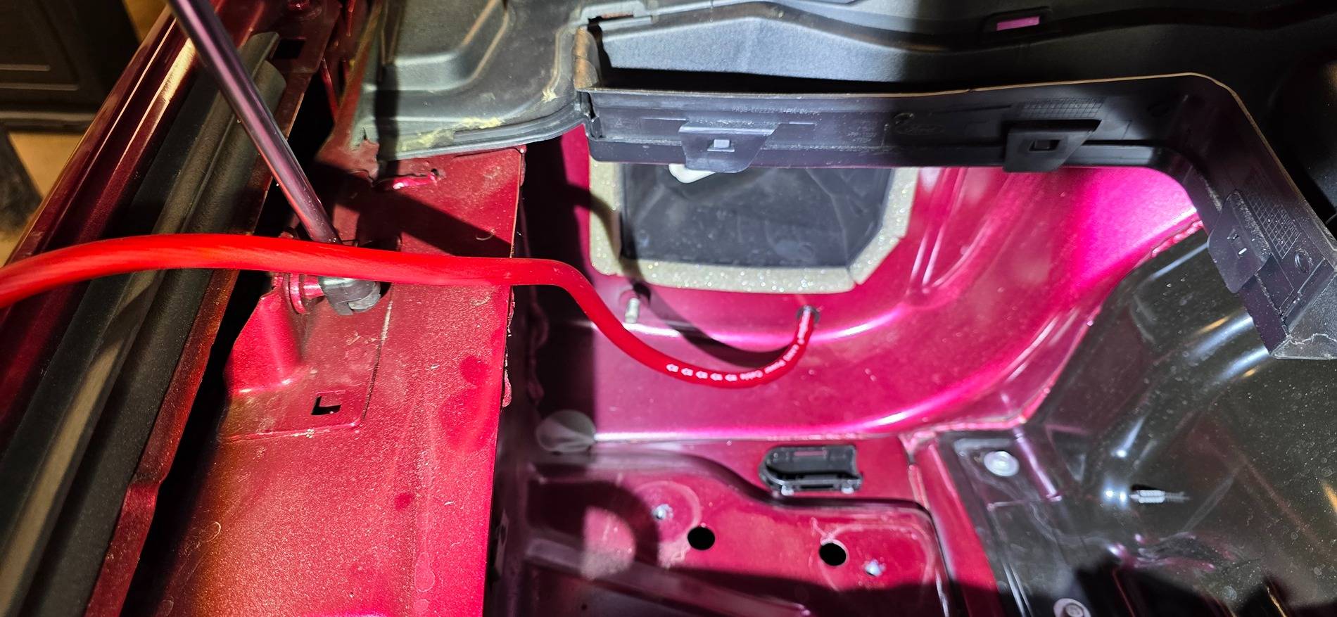

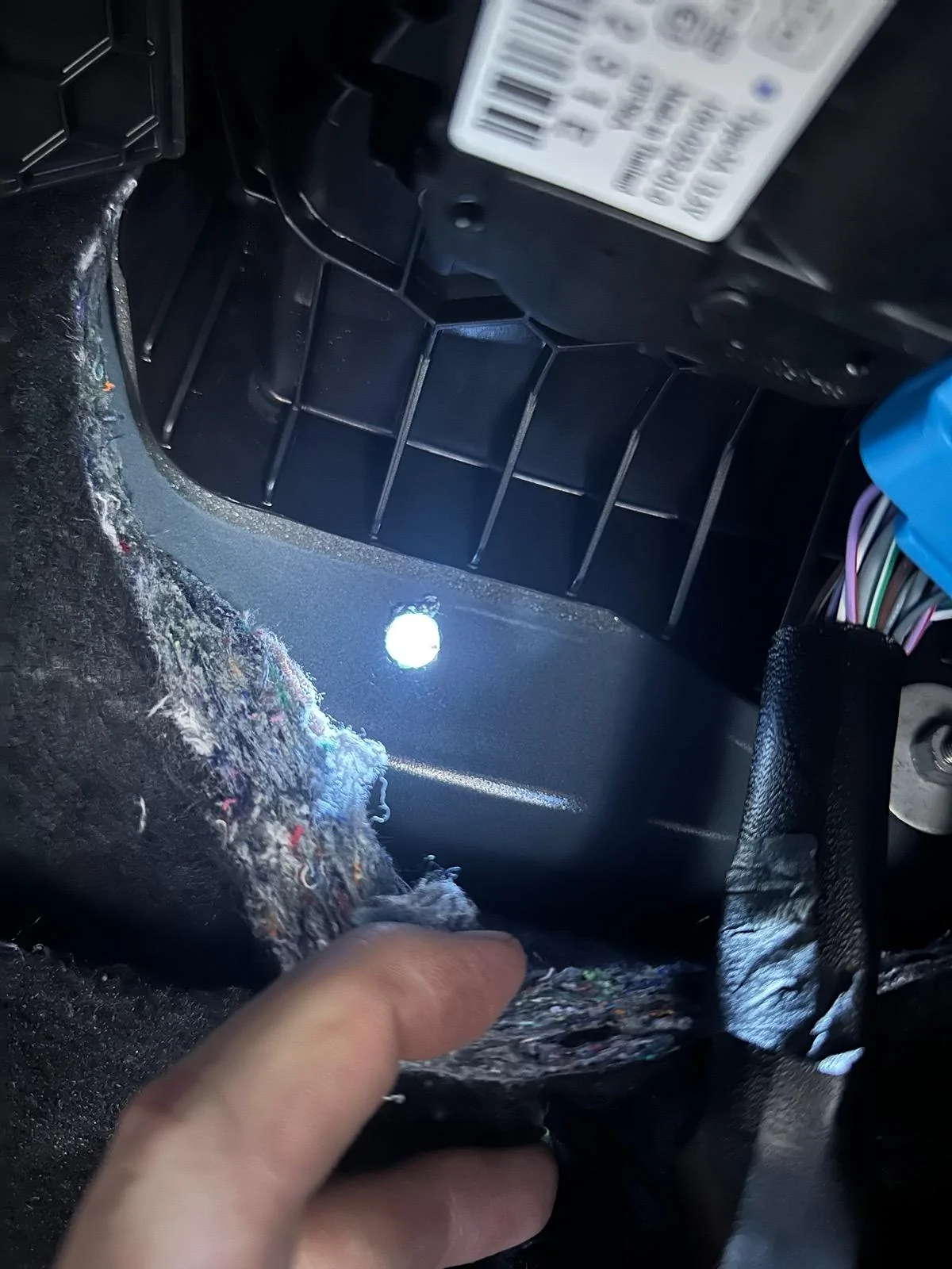

Here you go, I just popped a quick hole and grommet, don’t be reckless with the drill… there’s wires on the other side.
Pull back passenger carpet and it’s right there, easily route back to the trunk.

Awesome, thanks. So you lifted the battery out and drilled below that black plastic housing. Pretty sure I've got a metal drill bit for that size, would just need to order a pack of grommets.
