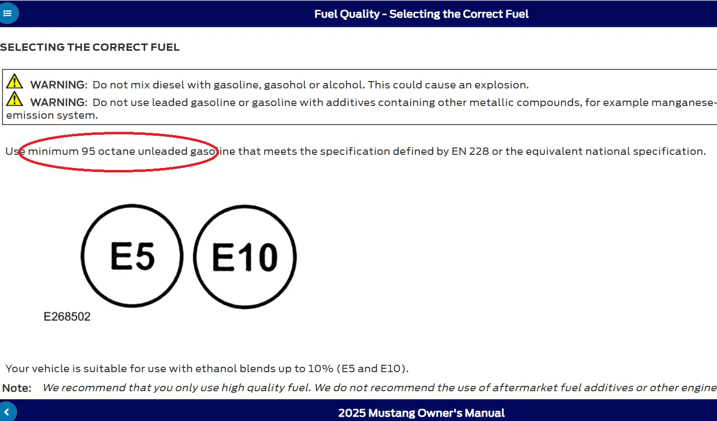

Hi ALM, thanks for bringing that up.
In our crazy online manual they provide us with it does state a minimum of 95 Octane can be used. Ive attached a screen shot.
I always use 95 in it unless there is none available and I then I use 98.
I drive pretty sensibly usually, only really give it a bit when overtaking.
I've not noticed any pinging, rattling or knocking and power seems fine.
Since you have mentioned it, I might ask my dealer their thoughts on whats acceptable to use this Friday when I see them.
S650 Mustang Mustang Road Trips - Grand Touring - Australia Ford Manual octan

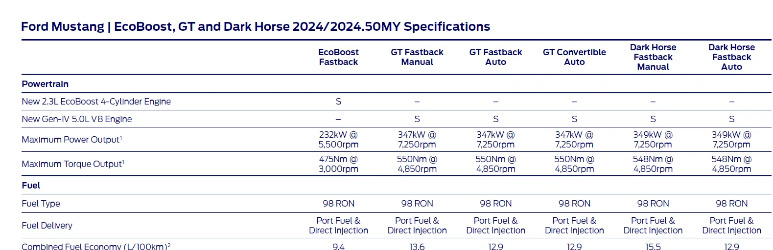

Manufacturer information is all over the place!
The specs call for 98;
S650 Mustang Mustang Road Trips - Grand Touring - Australia Specs

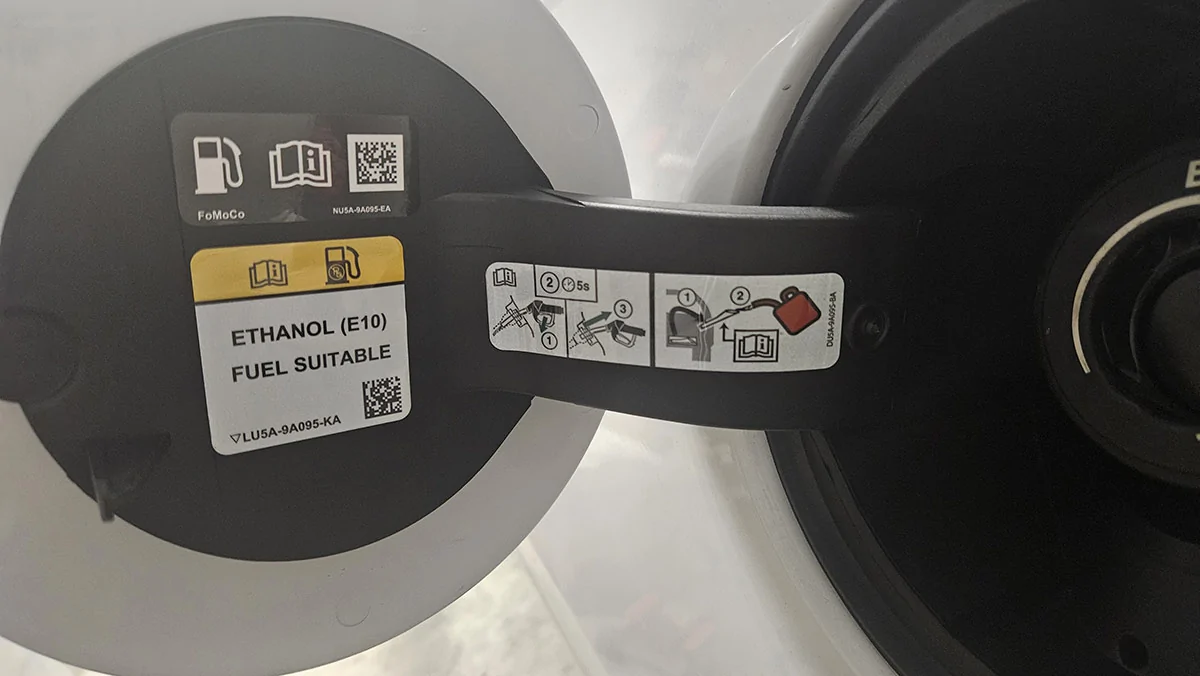

Yet behind the fuel cap says E10 suitable;
S650 Mustang Mustang Road Trips - Grand Touring - Australia 20260518_105909_1200
E10 is based on 91RON.
So in other words, anything from E10 > 91 > 95 > 98!
I guess the fuel injection system adjusts timing to avoid knocking, but this usually comes at the expense of power and fuel economy. ie; it can be a false economy filling up with a cheaper lower RON fuel if the economy/mileage is worse.

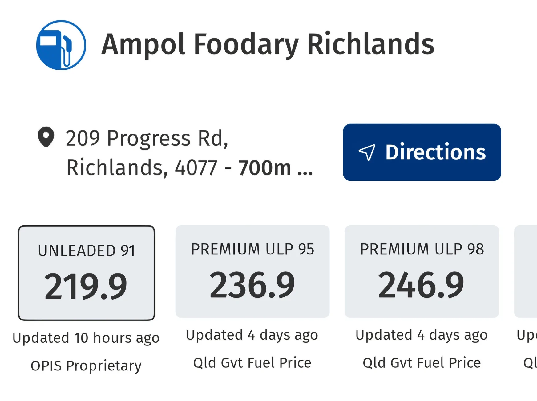

With only a ~10 cent/L difference, and a 50L fill from near empty, ~$5 difference, I'm not sure I could be bothered personally.
S650 Mustang Mustang Road Trips - Grand Touring - Australia Screenshot_20260518_111906_Fuel & Deals

I think these V8 or turbo engines work as supposed to with 95 or 98. The E10/91 can be used if needed in particular situations or emergency, but engine may not perform properly if this type of fuel is used constantly.
There is still a chance that, when a car maker says "use 98 or 95", it is to provide a 'premium feeling' to the customer and in reality there are no problems in driving with 91.

Everyday driving with the odd WOT will be fine using E10 which is 94 ron , whilst i normally use U98 over the last couple months ive been filling with E10 due to price and you would not know the difference TBH out side a small drop in economy .... Clearly if you track/race your car use the best fuel you can but for the average old dude in a Stang you will be fine
