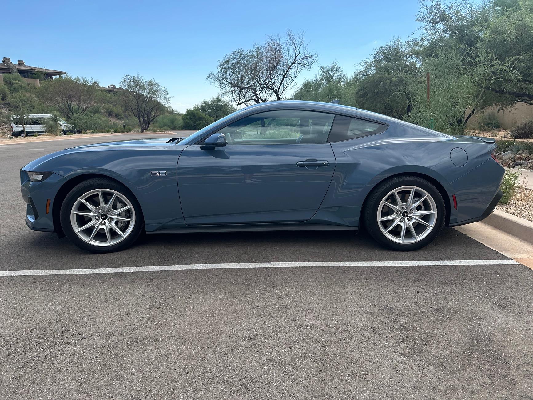

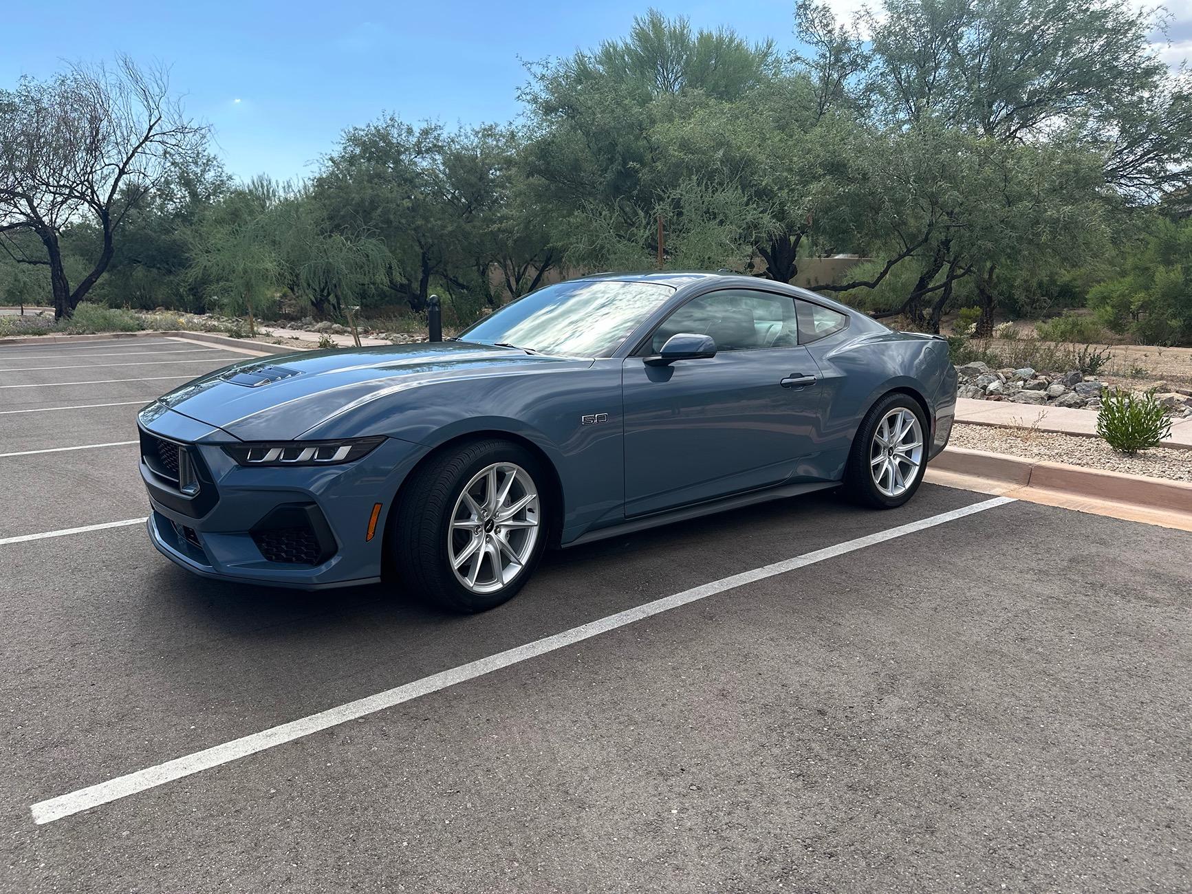

I am currently running 25mm Spacers on 19inch wheels, I love the aggressive look but want to go lower.
I have been looking at the Eibach Sportline lowering springs and was wondering if anyone had tried a similar combo and had any issues with fitment or rubbing…push comes to shove the spacers can come off but would love to have both.
Any feedback appreciated!
Current Stance/Look

spacers are a band aid at best. buy wheels with the offsets you want.

While not really an apples to apples comparison, I’m running Ford Performance lowering springs on my Dark Horse. I do have aftermarket wheels but they’re in the factory handling package specs…19x10.5 and 19x11 with corresponding factory offsets. The only rubbing issue isn’t a rubbing issue, but pertains to the splitter but that was an issue before the drop because of how big it is. if your car had magnaride then the springs I have should work for your car.

This isn't an exact answer to your question, but I had Sportlines on my S550 paired with SVE R350 19x10 and 19x11 wheels and never had any issues.
