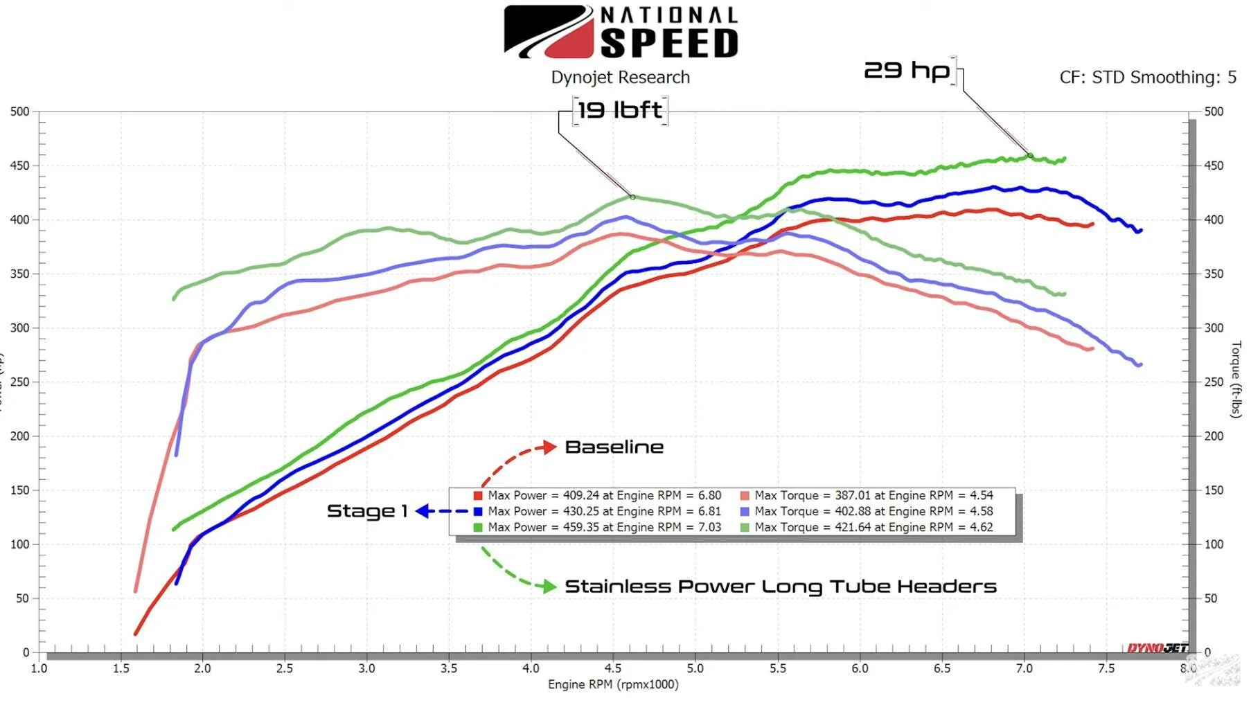

Looking for objective information on actual HSP and Torque gains with installing headers. There seems to be subjective information floating around but I would like to know from members with stock motor and long tube headers what the actual Dyno Tested gains are.

20-30hp isn't uncommon. If you see more than that there are usually other mods that came with it, or the car wasn't tuned prior to the headers but was tuned after, etc.
S650 Mustang Long Tube Headers Screenshot 2024-10-25 at 12.58.45 PM

Headers over the years is normally a 20-30hp gain and about 20 or so ft lbs. But that isn't at peak. Most headers pending the design will see gains in the mid range while helping with torque on the lower end.
With running a GESI or GREEN cats, it won't take away from the power gains either as they flow great.
