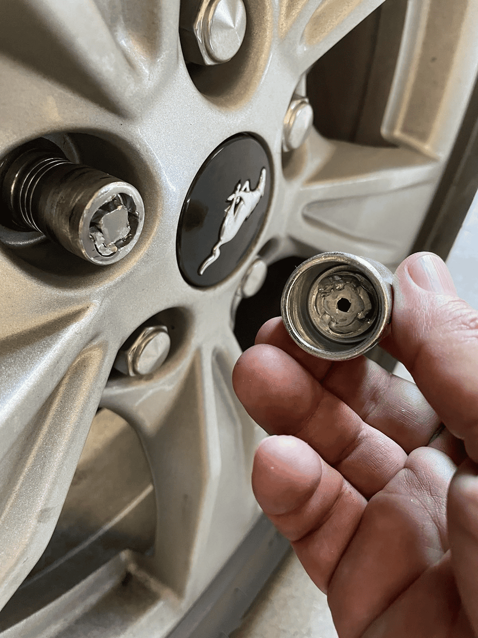

The Ford McGard locking lug nuts and keys cannot take 150 ft lbs. My 2022 Ecoboost had to have all 5 cut off at local tire shop when my key destroyed itself (dealer made me purchase them to make the sale, on a good note they gave me two sets so I put one on eBay). I didn't even attempt to put them on my S650, which has the same torque spec.
Yeah, because the local tire shop used an impact wrench set on max. They would have survived if the tire shop employee had actually done their job.
when your tire shop gets your car and immediately picks up the impact wrench, here’s what you should be thinking:

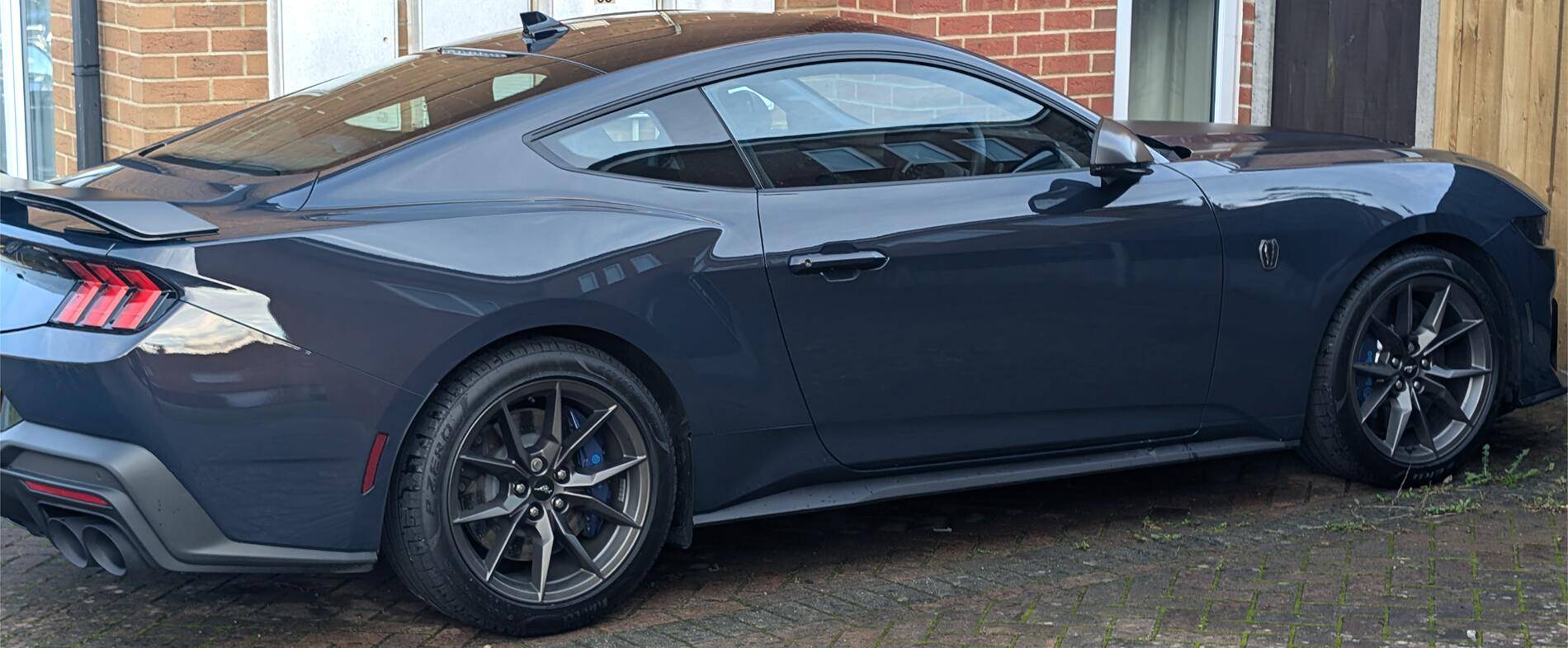

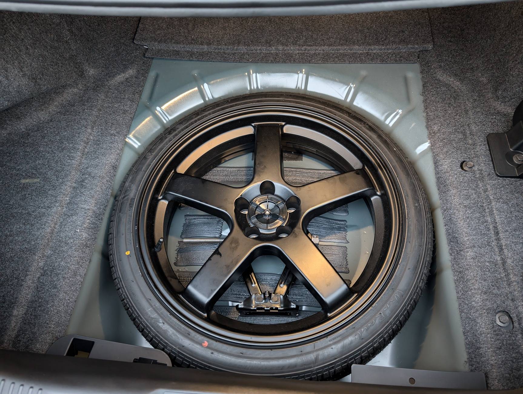

AA spare tyre arrived today and fits in the boot nicely. Will see if i have to find something to fit between the wheel and the jack if they start to rattle.
The kit came with lug nuts despite the site saying it retains the factory ones, also came with a spacer.
I'll probably test fit it as the weekend weather permitting.
Also the locking wheel nuts came in the boot and were fitted by the dealer, they look nothing like the ones above. You can barely spot which ones are locking, eg it's the top lug in the attached pic

How thick is the spacer? So is that the S550 spare plus spacer or a redesigned wheel?
Oh and the locking nut doesn't fit the spare wheel which is probably why they supply the spare nuts. Otherwise you have to carry a non locking wheel nut in the car with you.

I’ll measure it tomorrow, but it’s not very thick probably 5mm or so. It’s a 20” wheel so different to the s550 spare. The brembo’s at the front are massive and will be difficult for anything to clear
