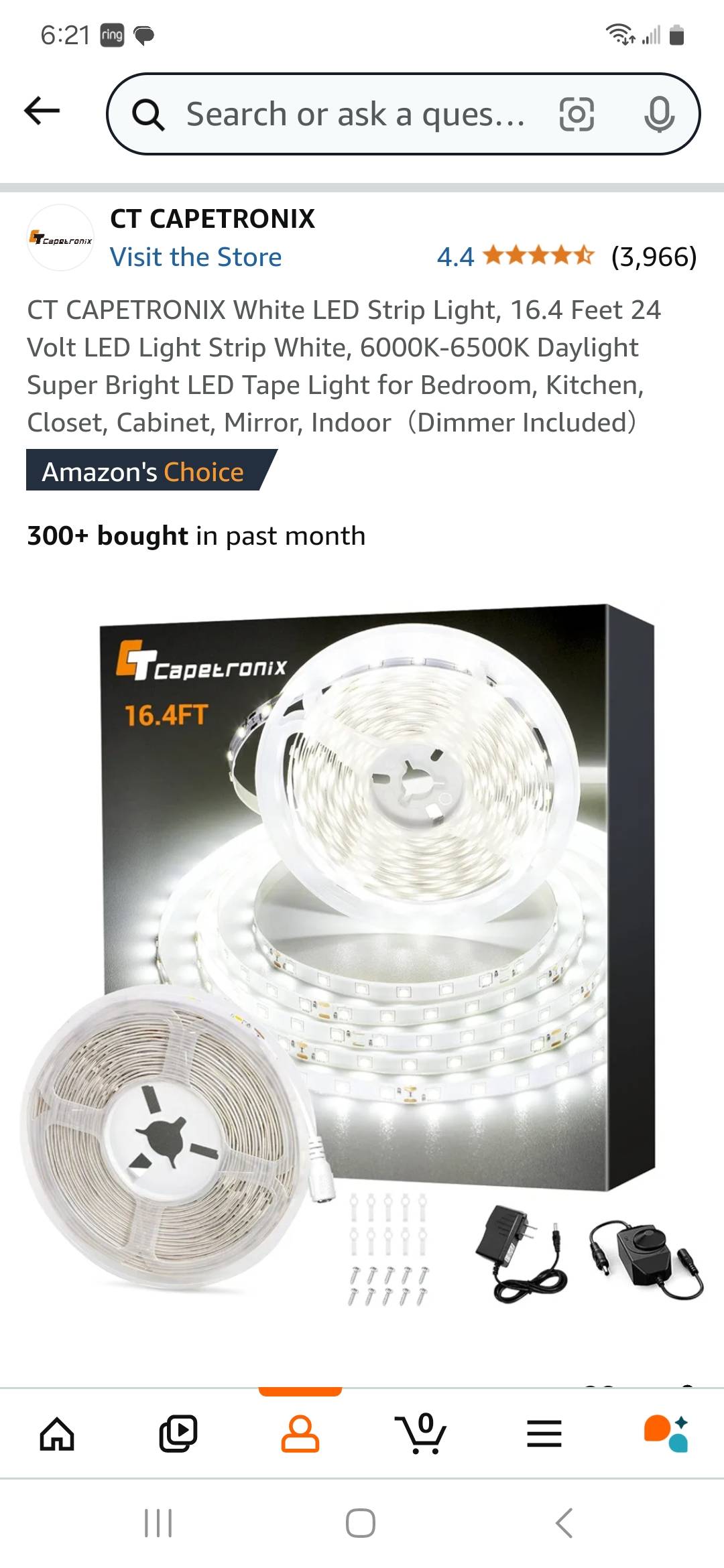

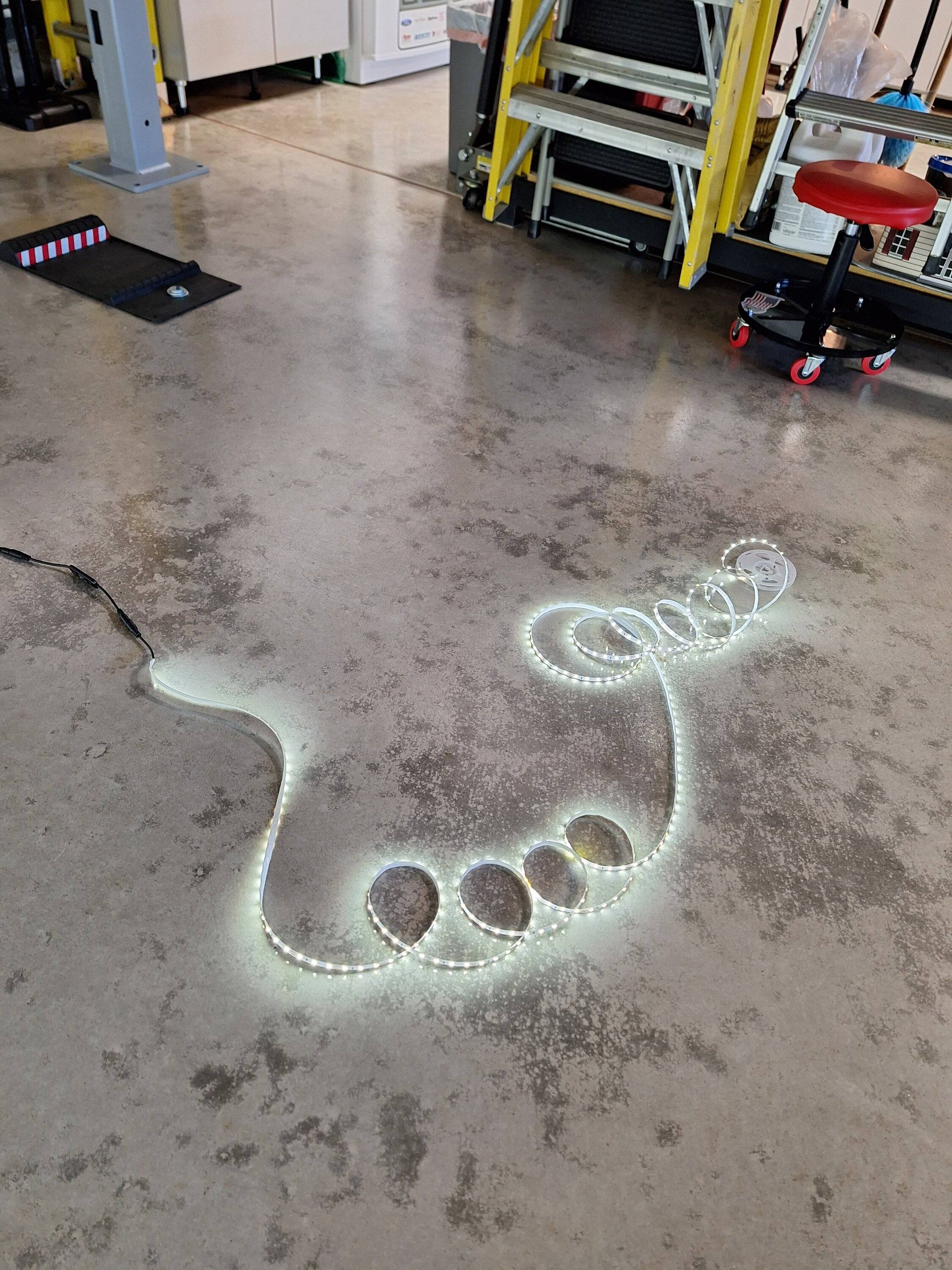

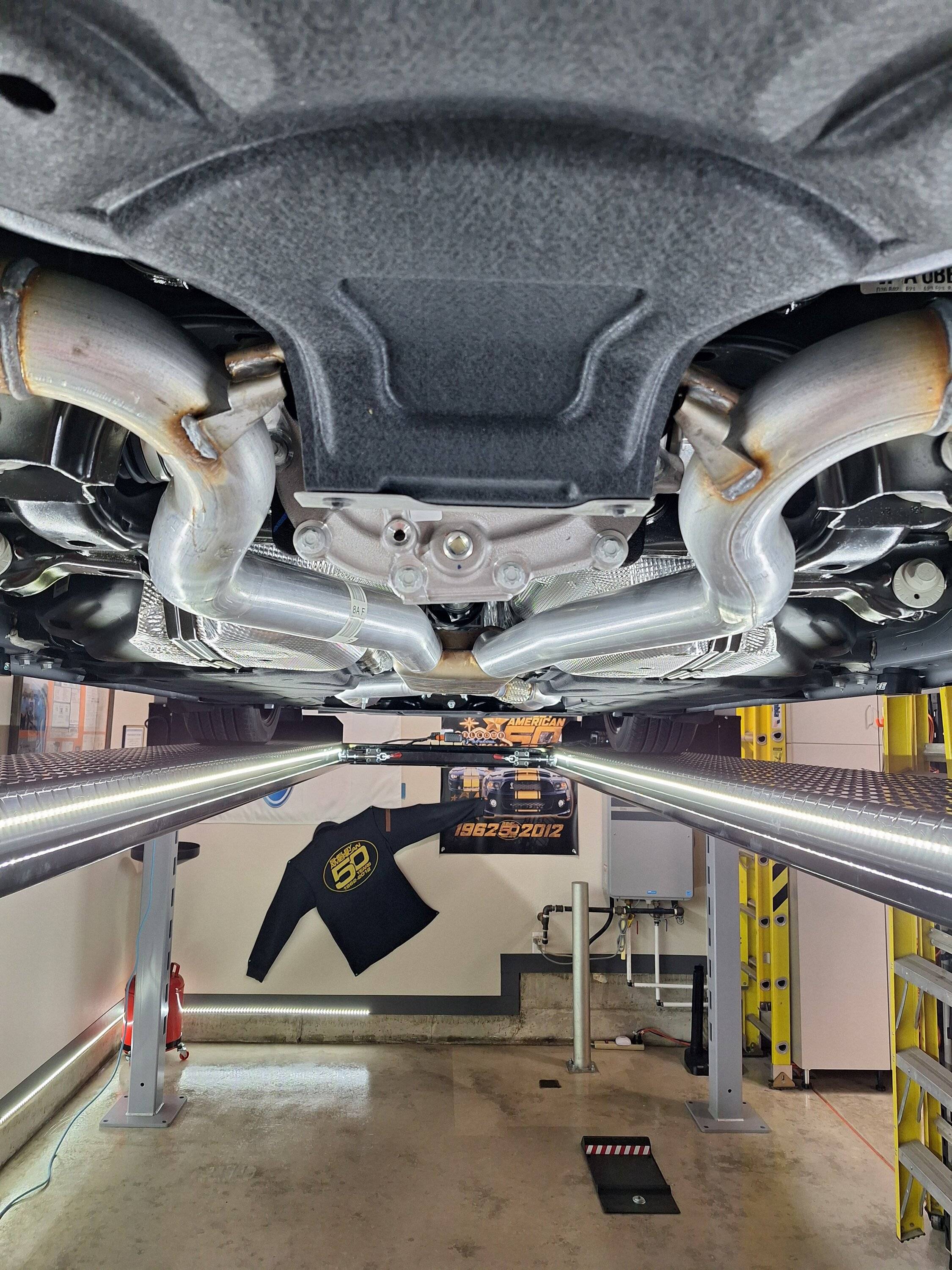

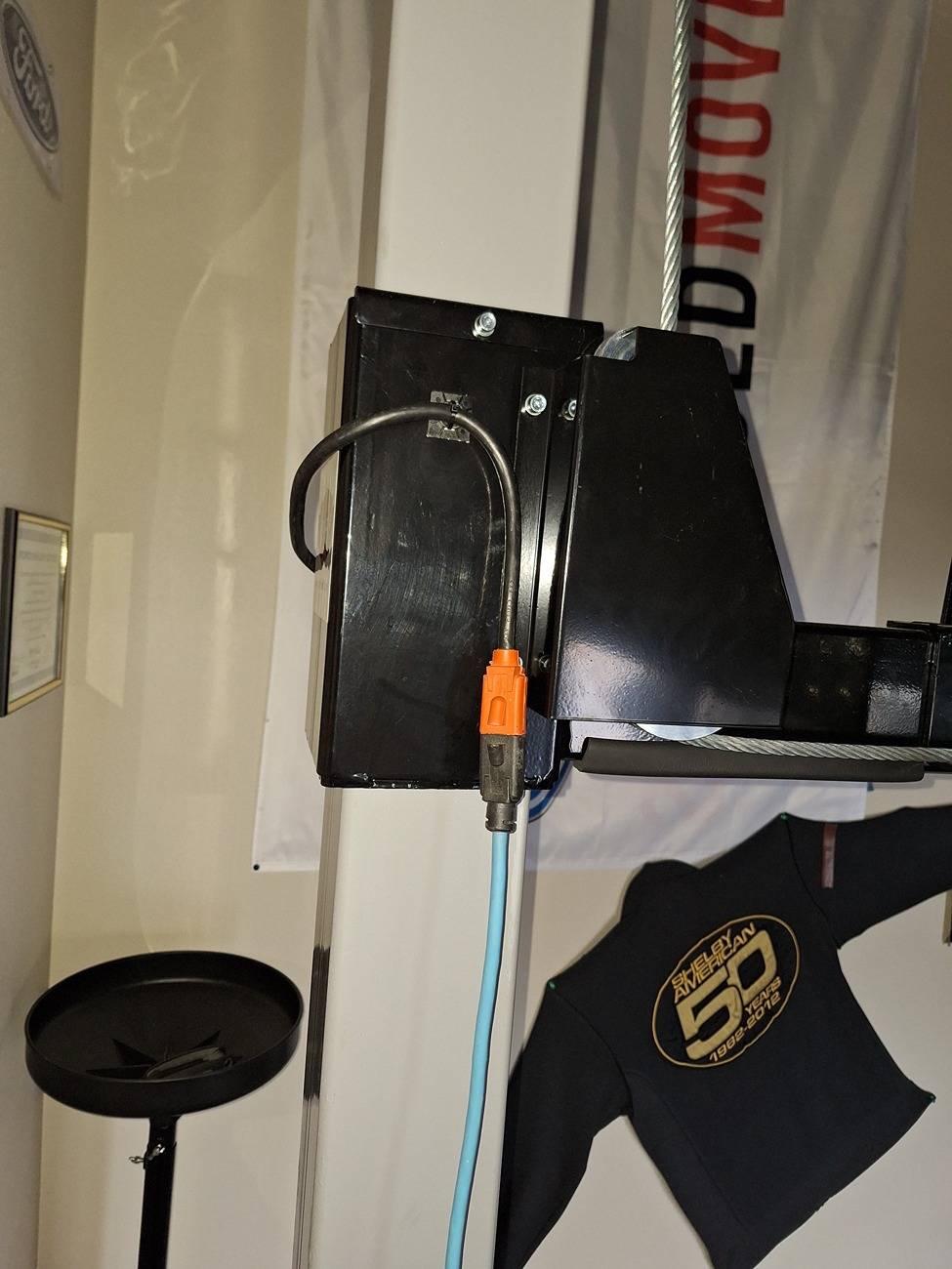

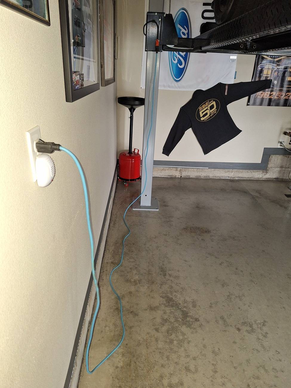

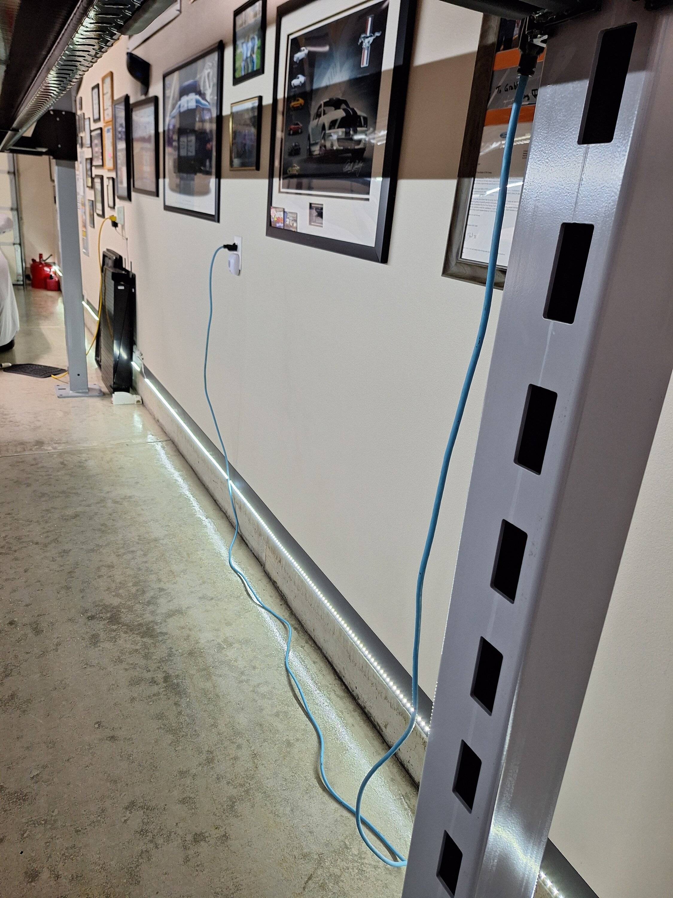

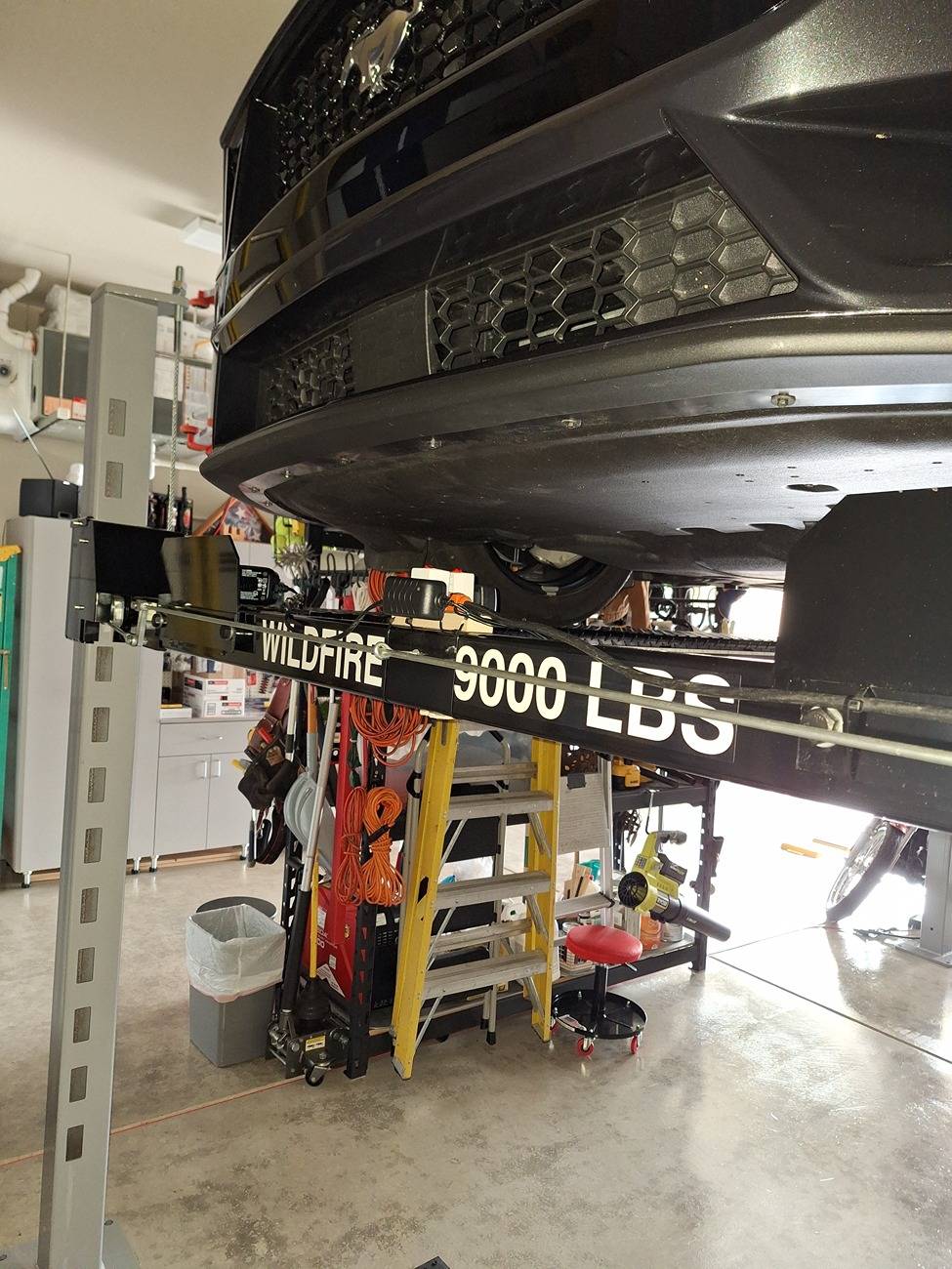

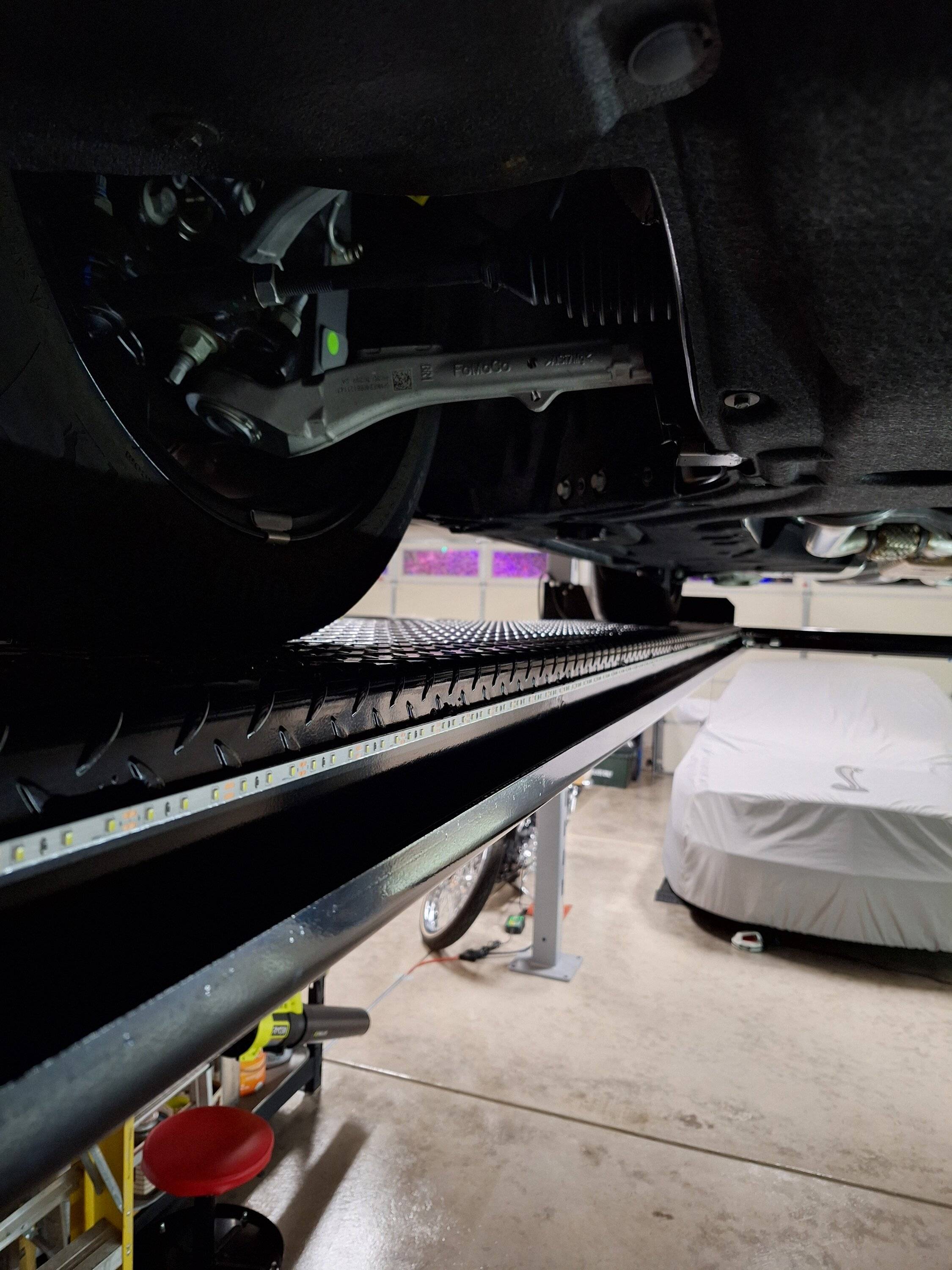

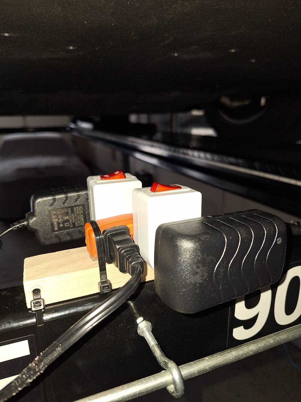

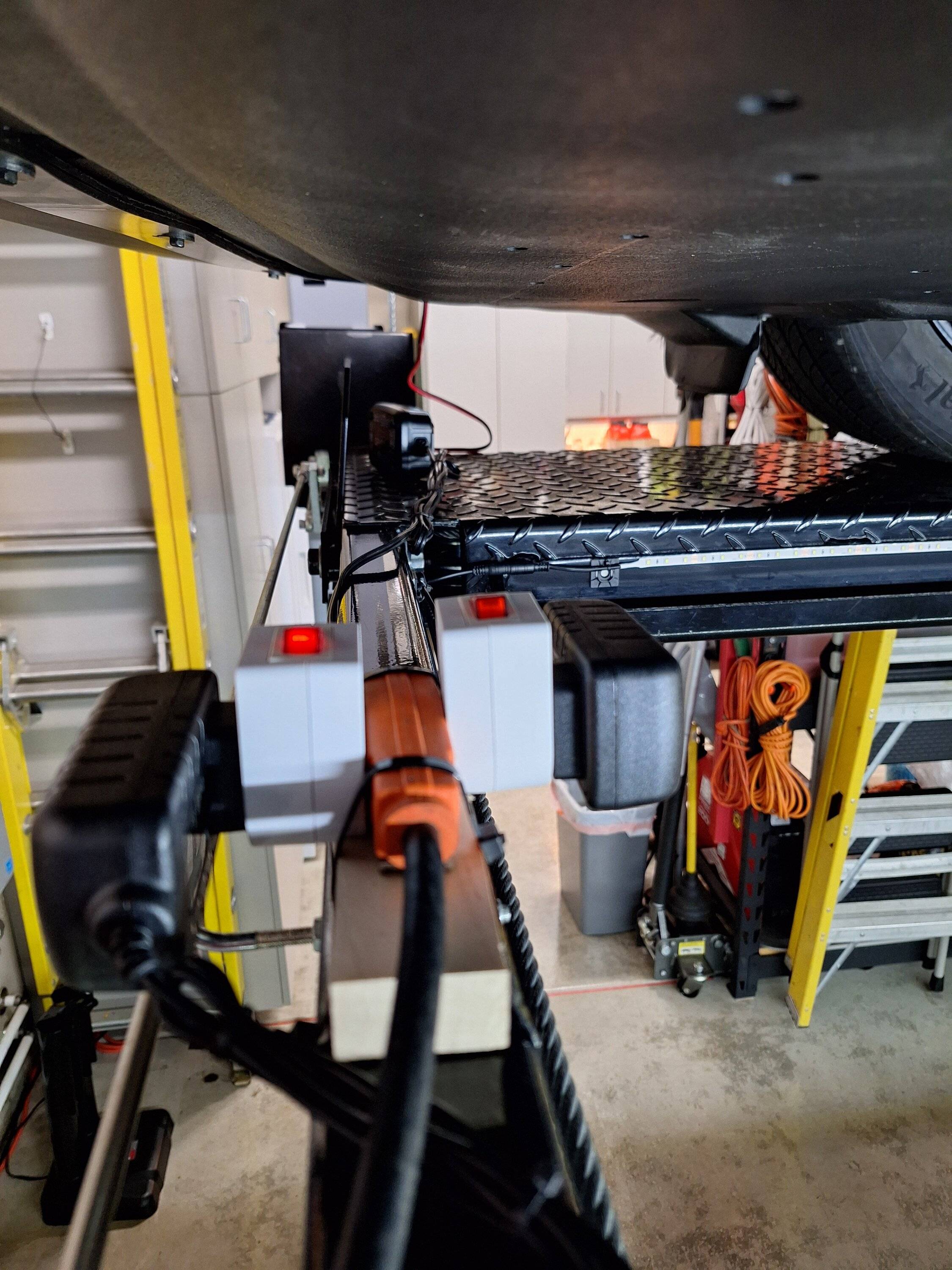

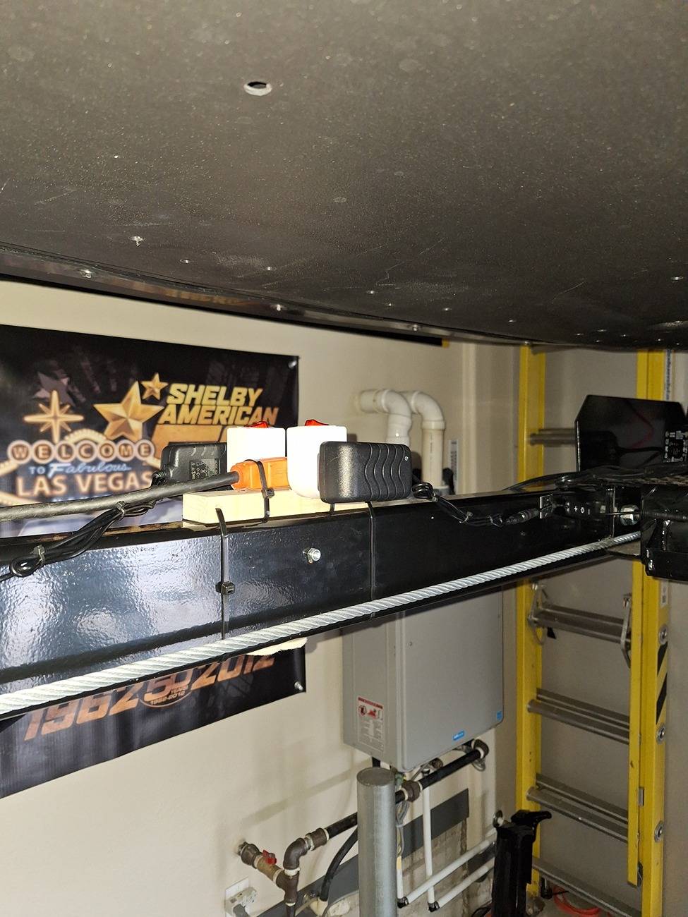

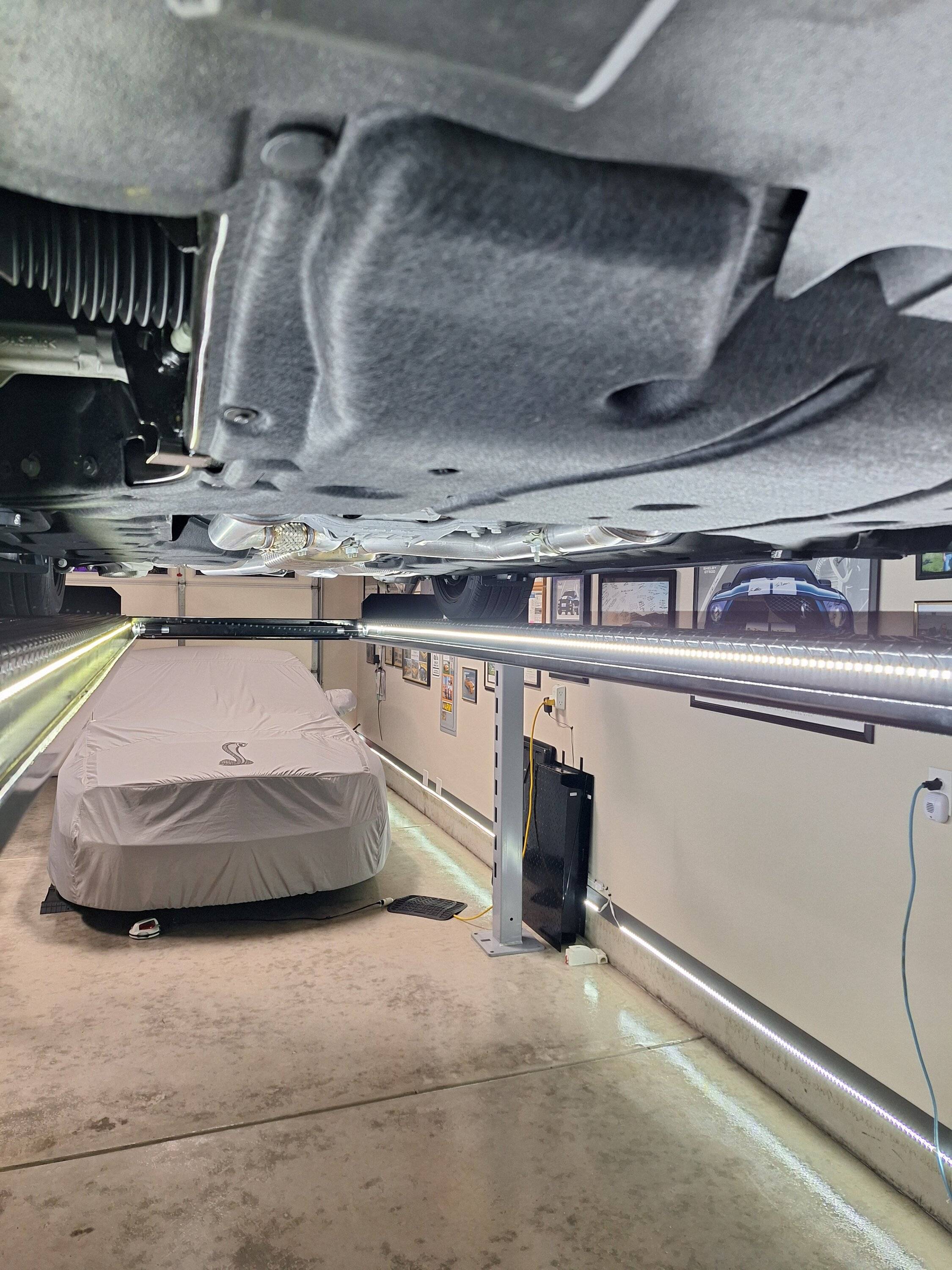

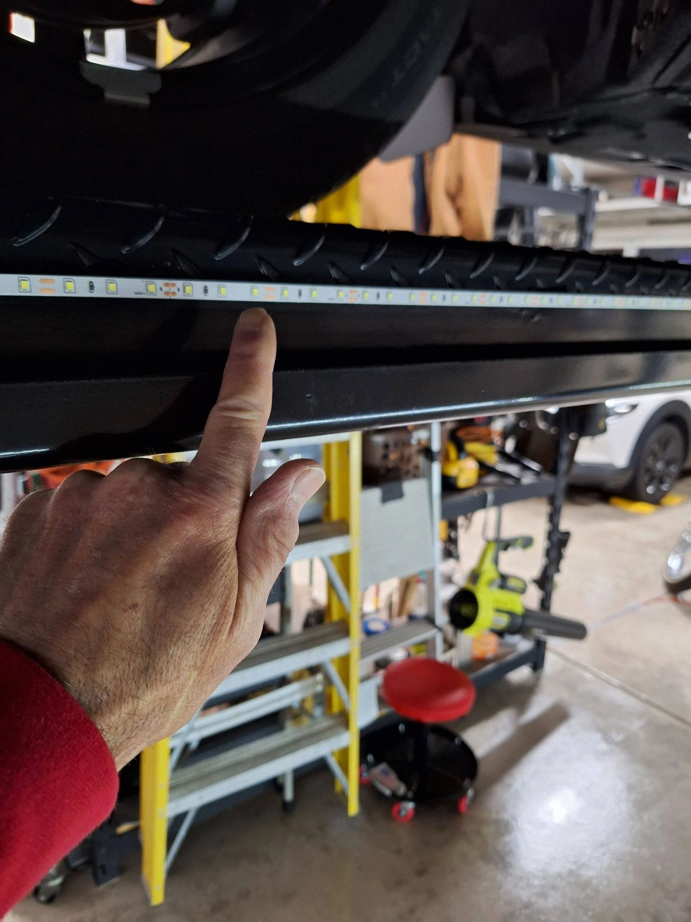

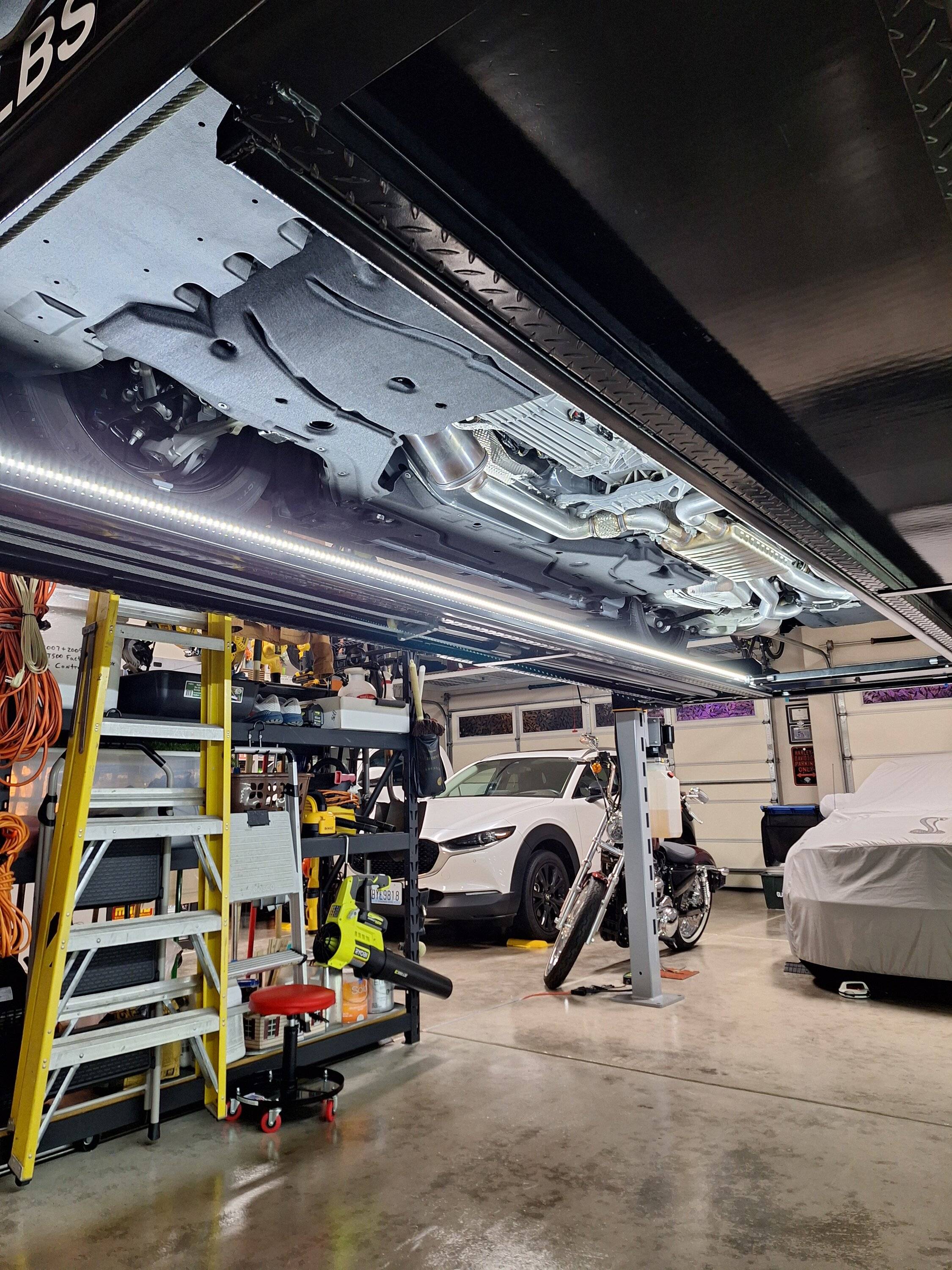

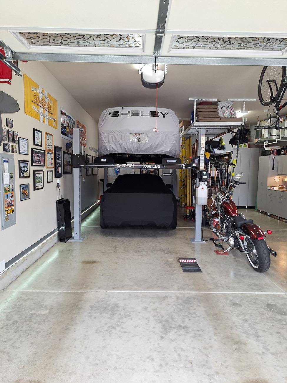

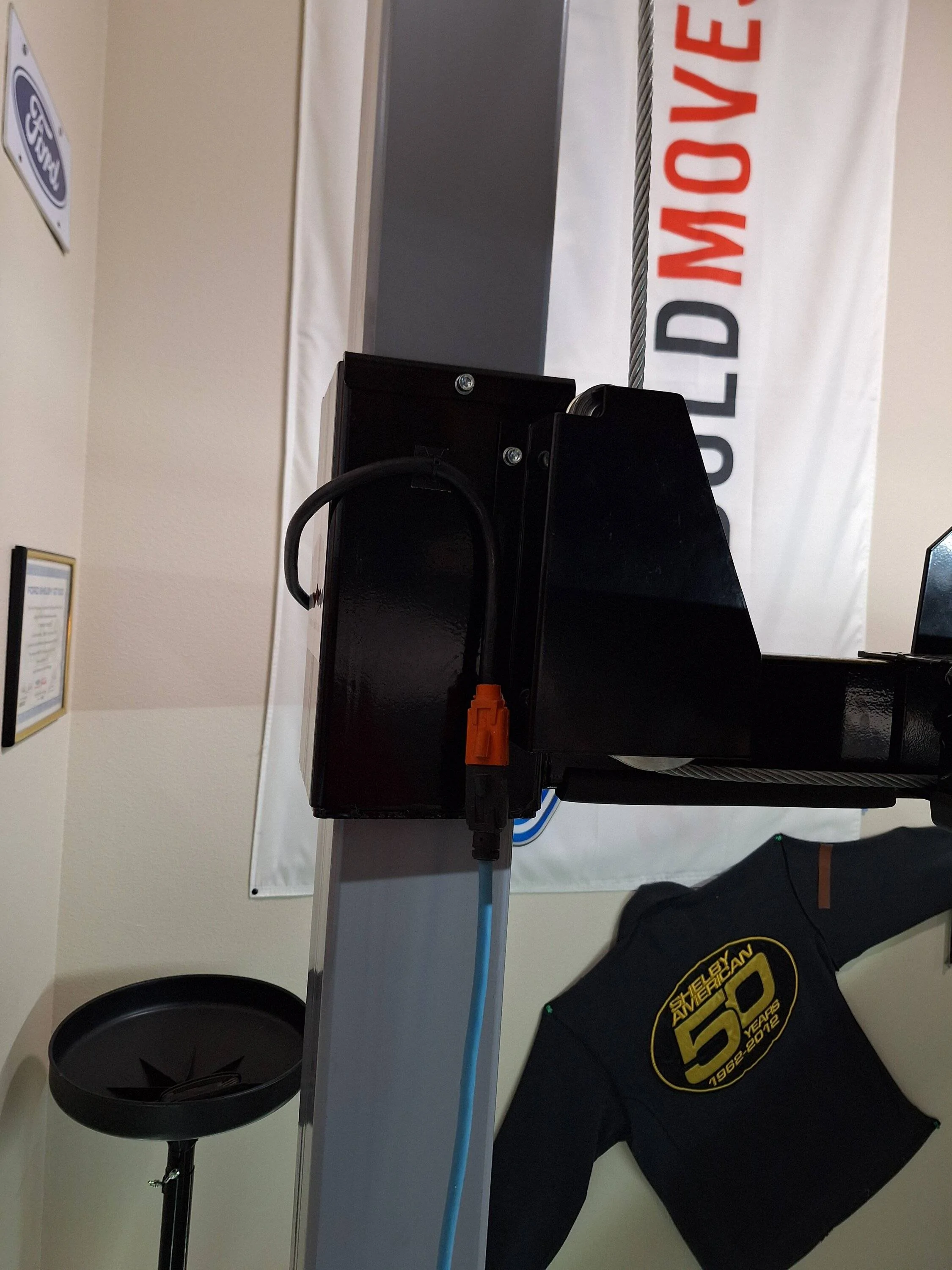

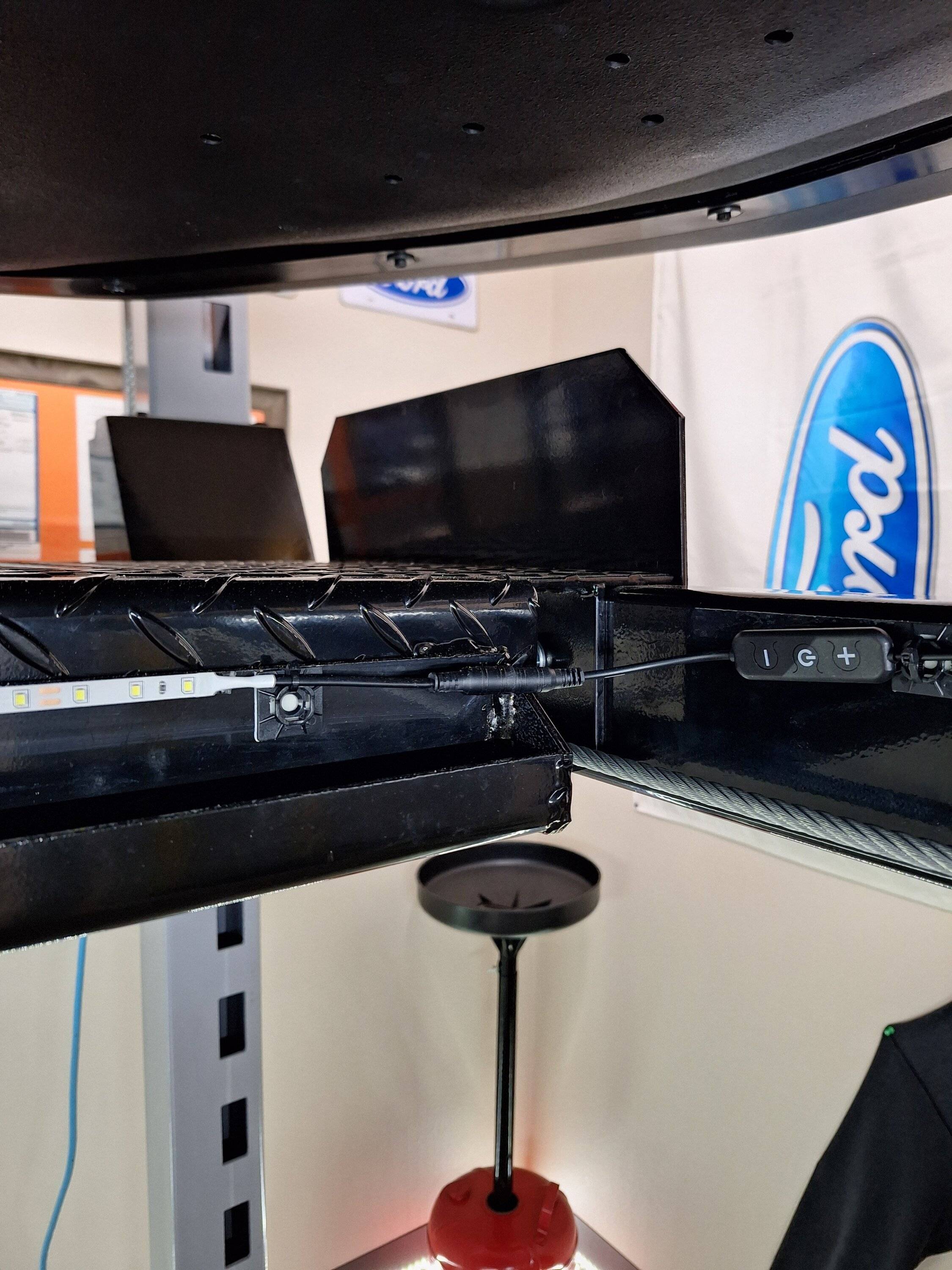

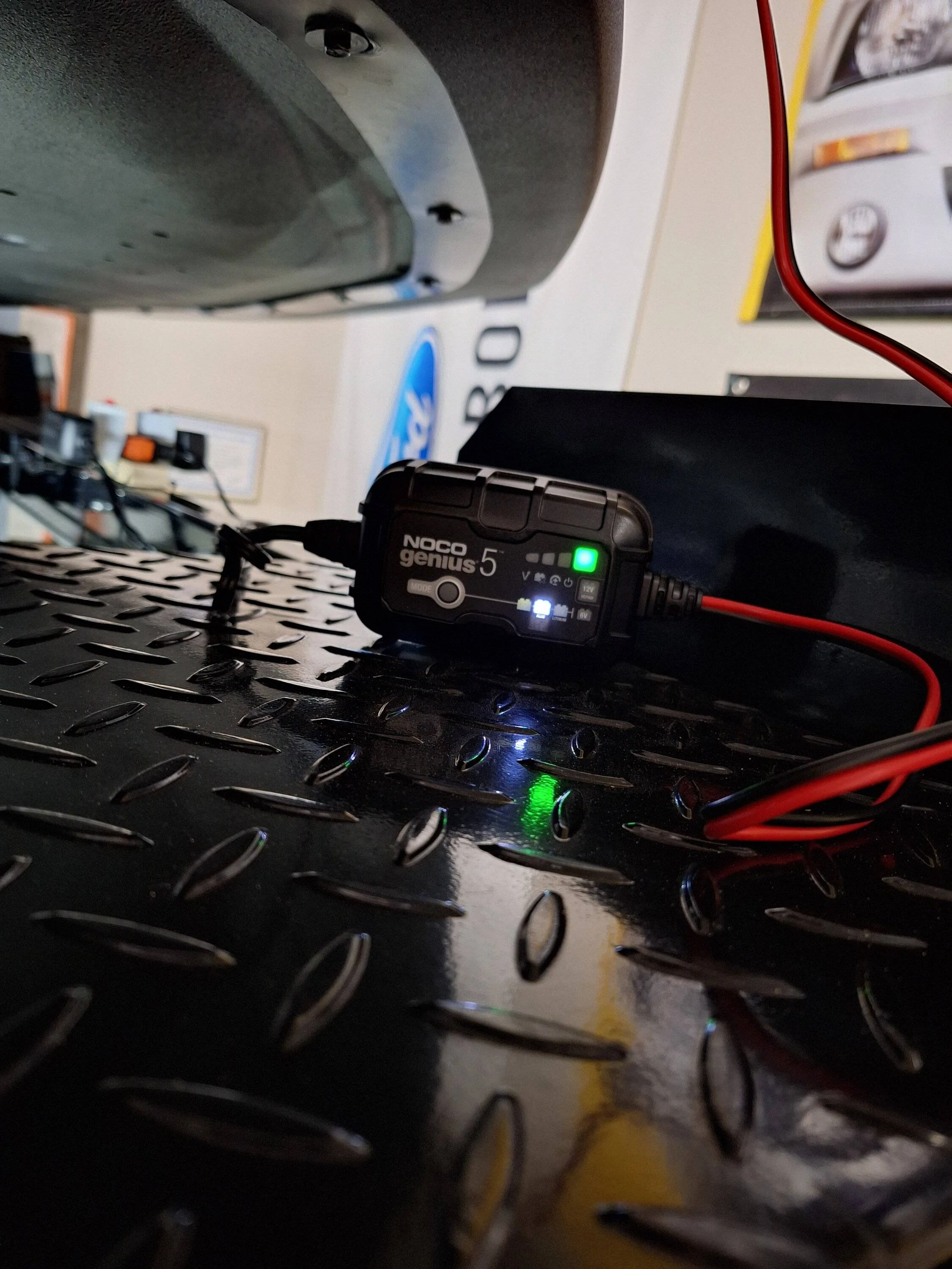

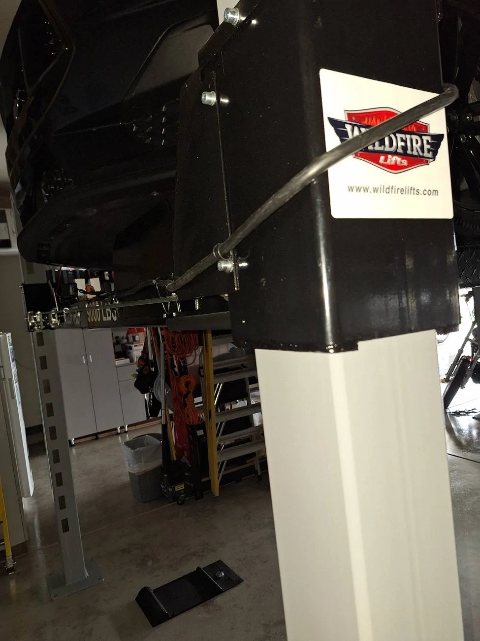

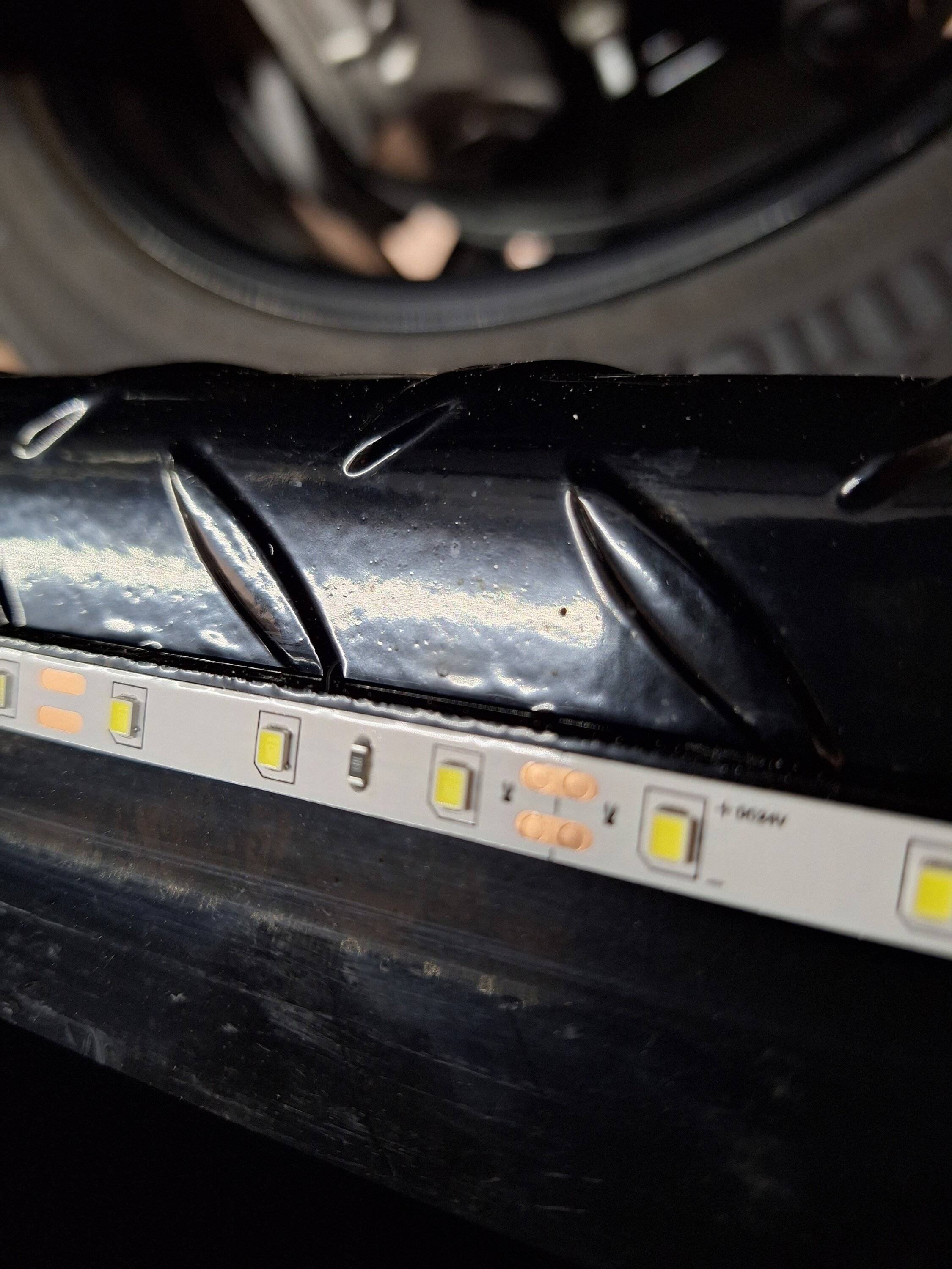

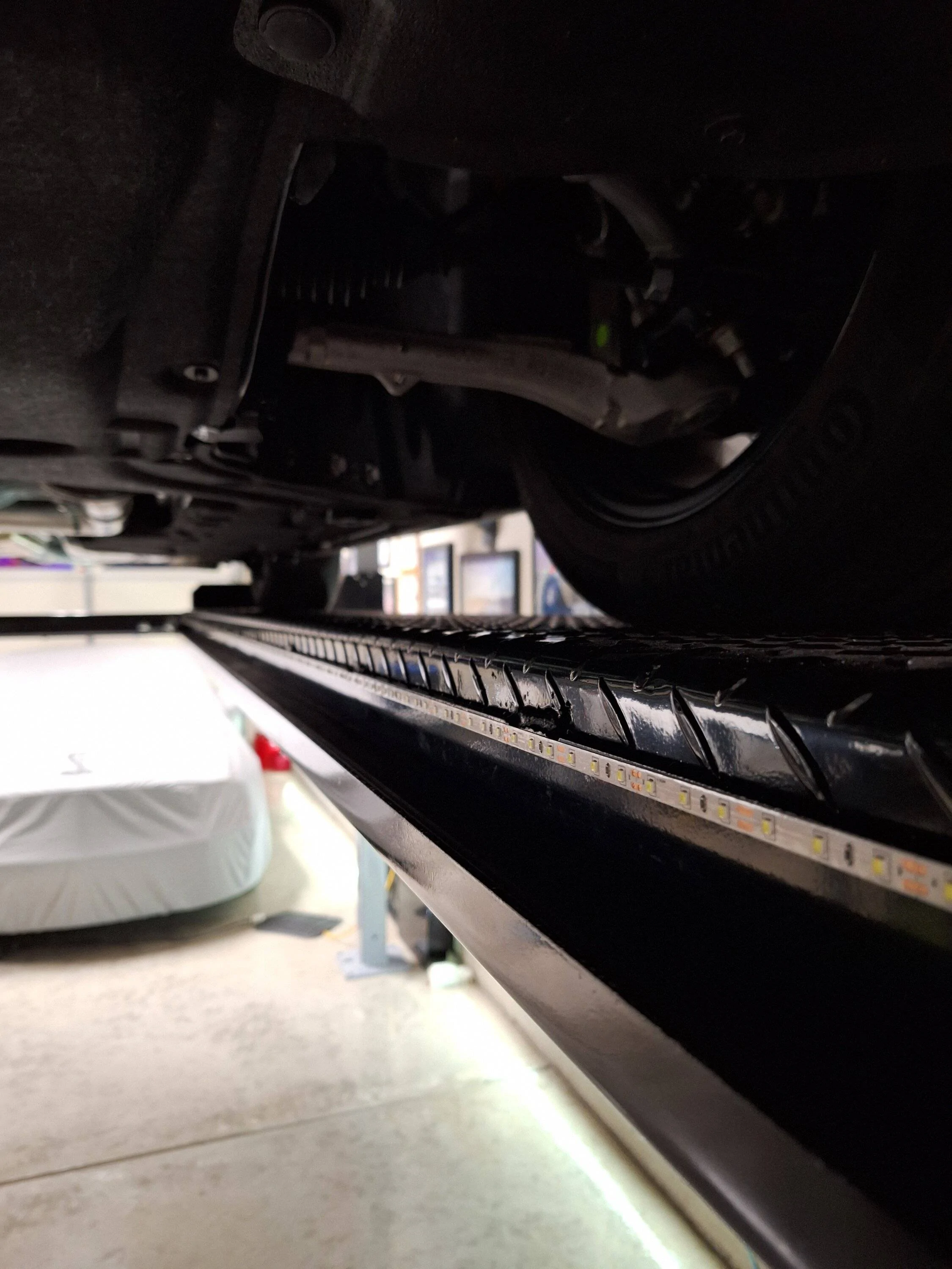

Installed two 14' long LED light strips on my Wildfire 4 post lift. Had to put the wires, electrical chord and switches in areas that can be permanent and user friendly. Also made an accommodation to plug my battery tender in when it's on the top of the lift. Amazon sells these lights in many different lengths. I paid $32 bucks for my 2) 16'-4" sections. They can be cut to fit your project with a sissor.
You Tube Video attached.

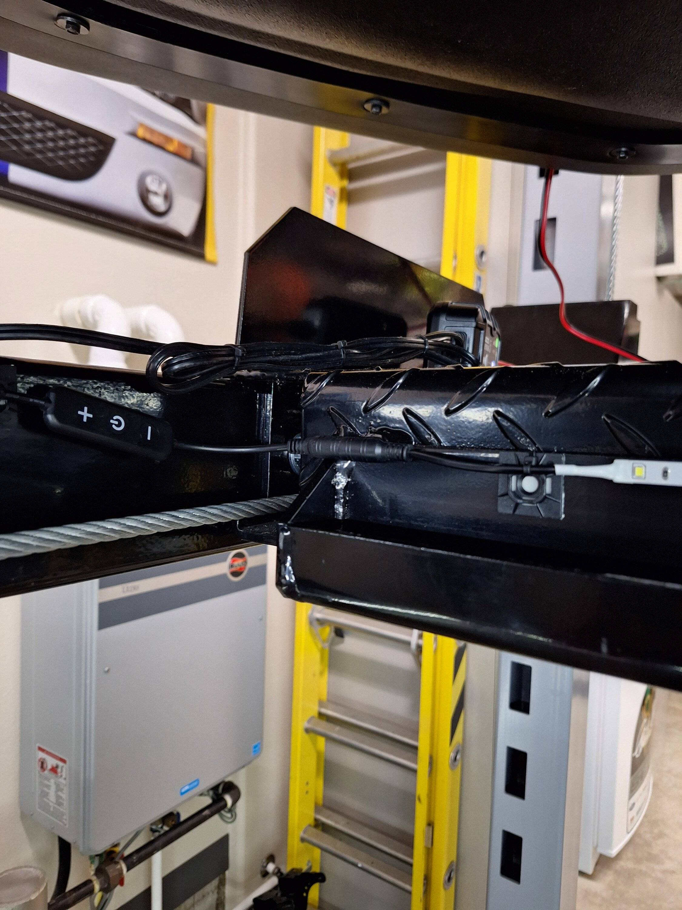

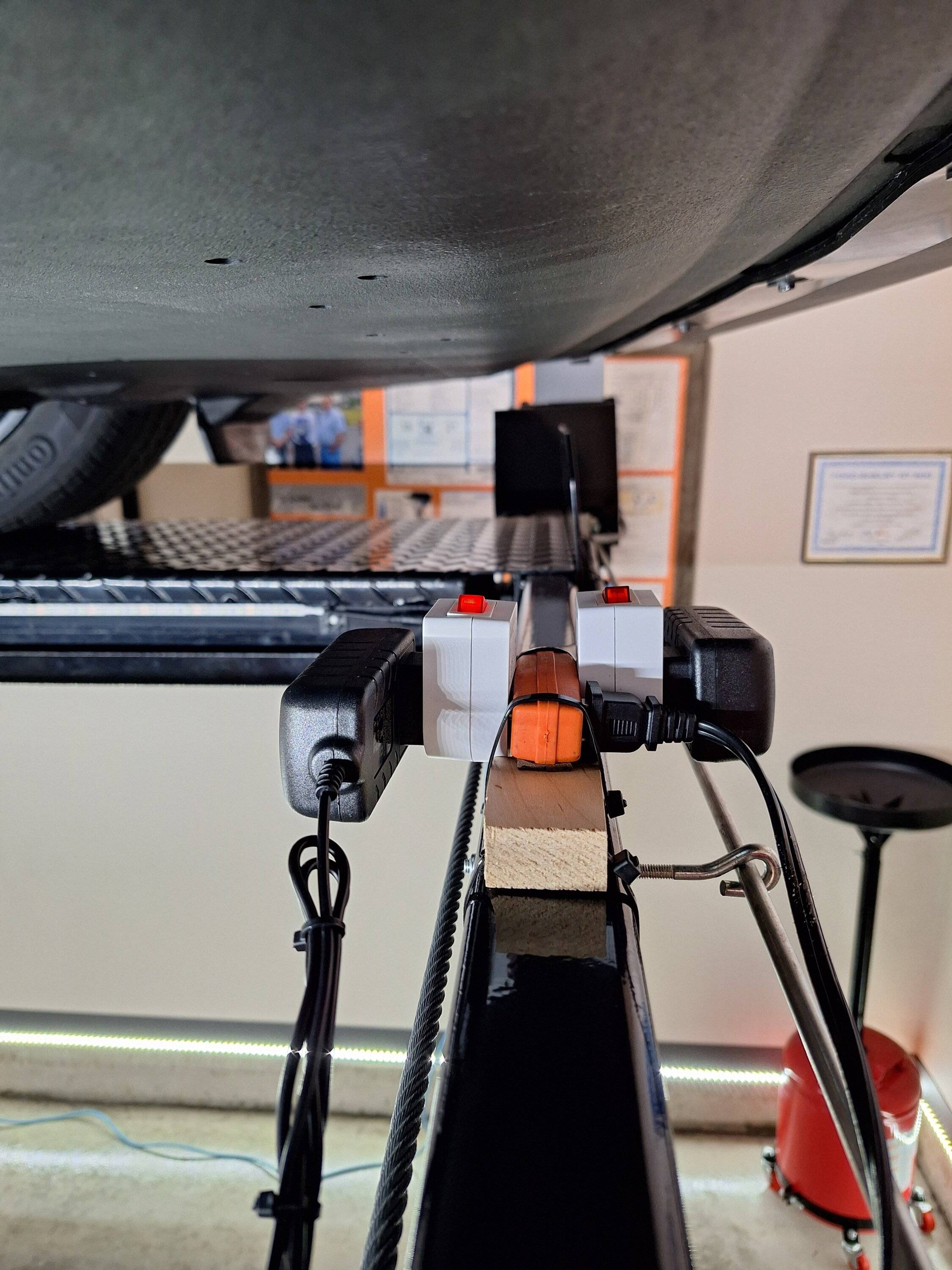

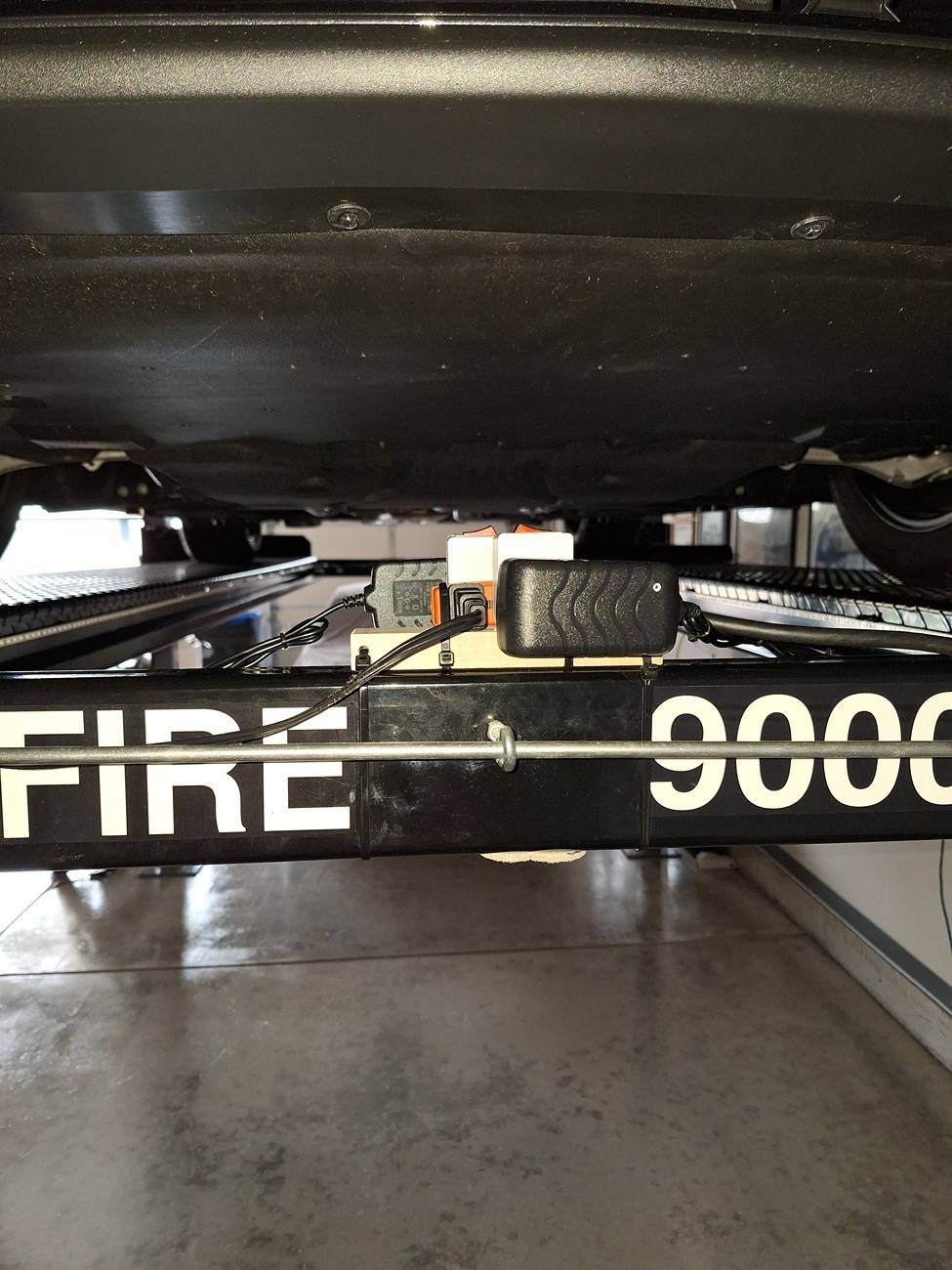

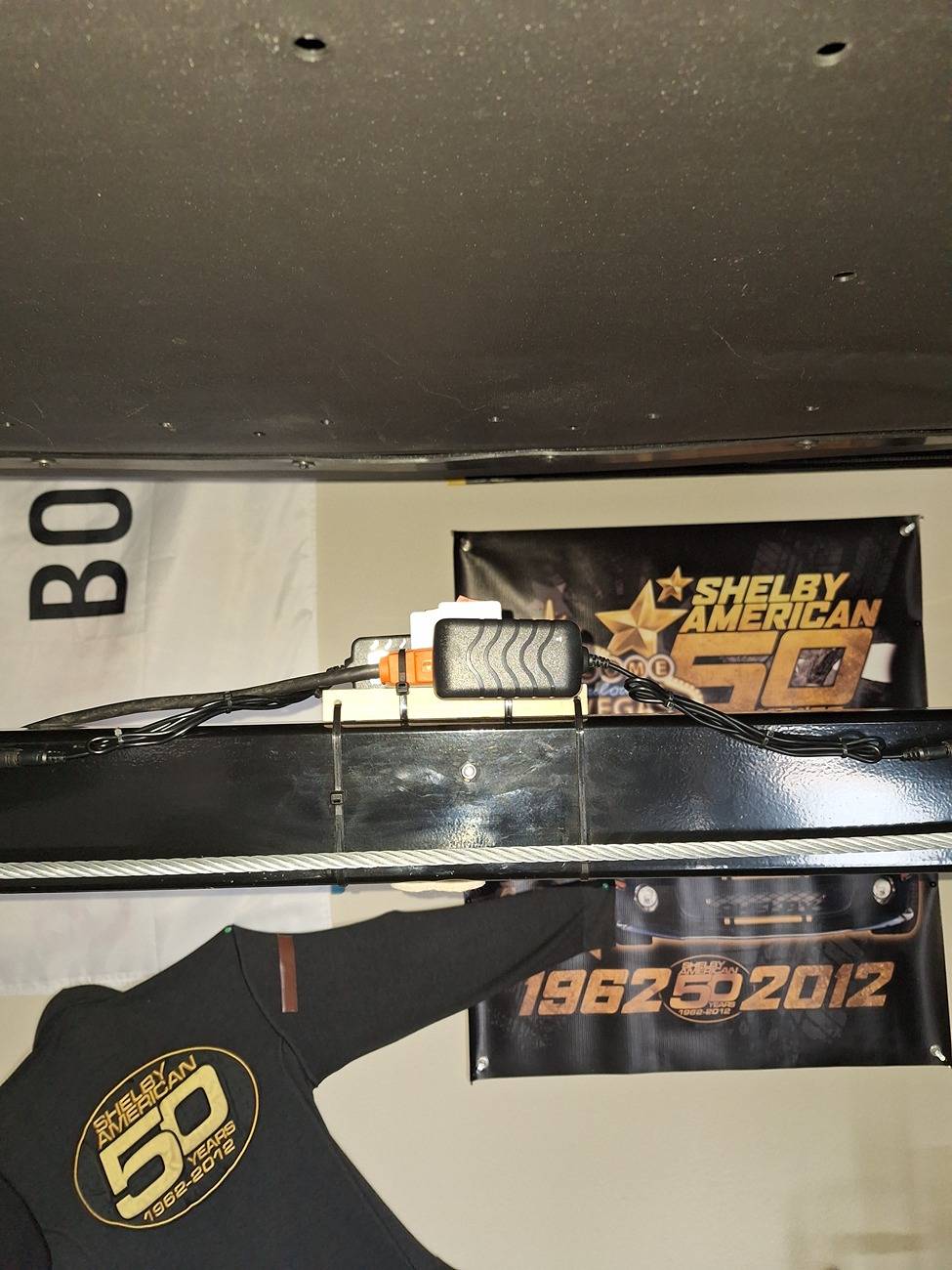

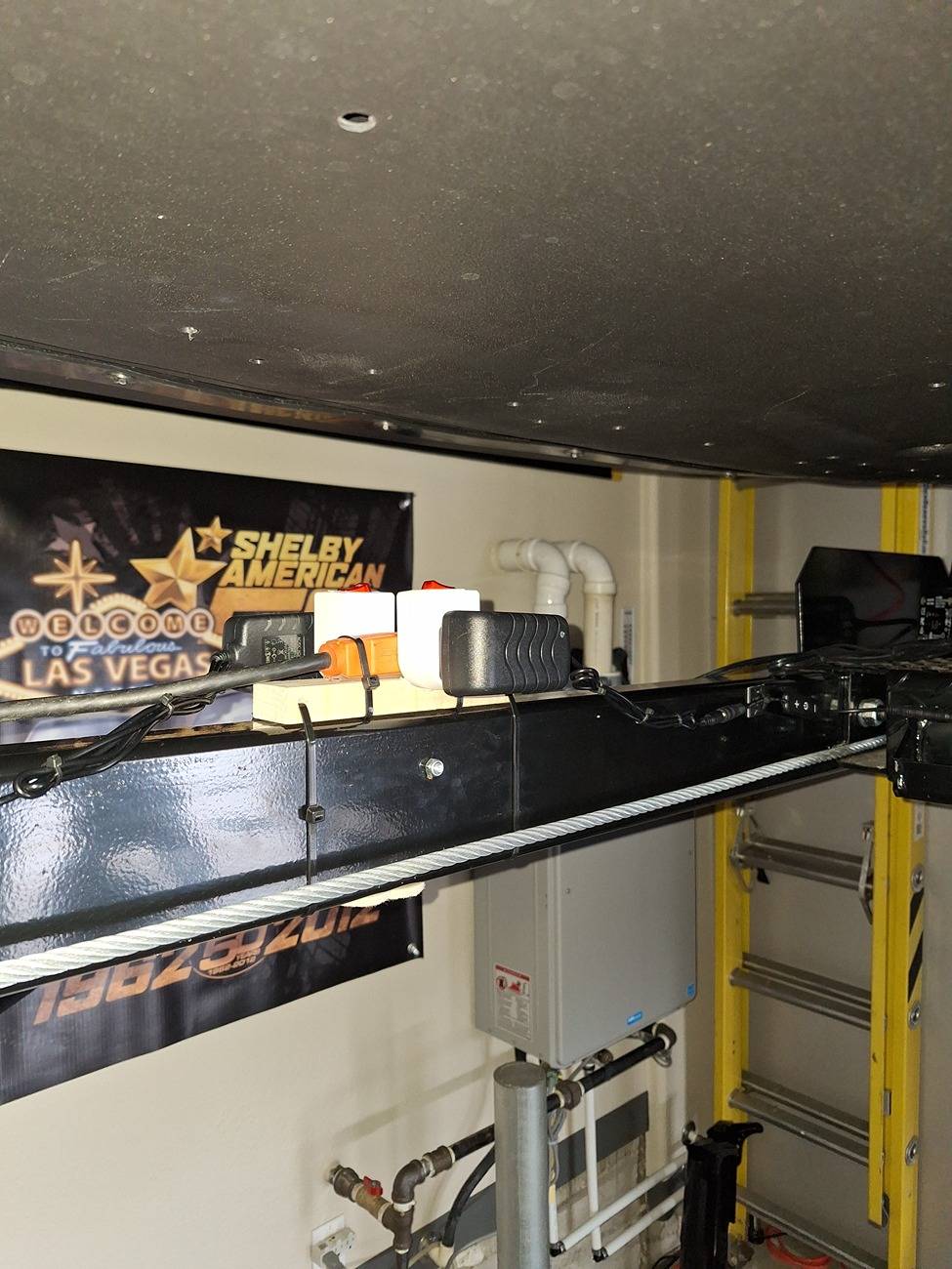

The challenging part of the install is to create an area that is user friendly to mount the switches. I had to secure a wood block with zip ties to shim the block up a little bit so the switches could be mounted to the 3 way that is mounted to the wood shim block. I even had to router out part of the wood block (1\4") to allow the switches to plug into the 4 way. A dremal worked good for this.

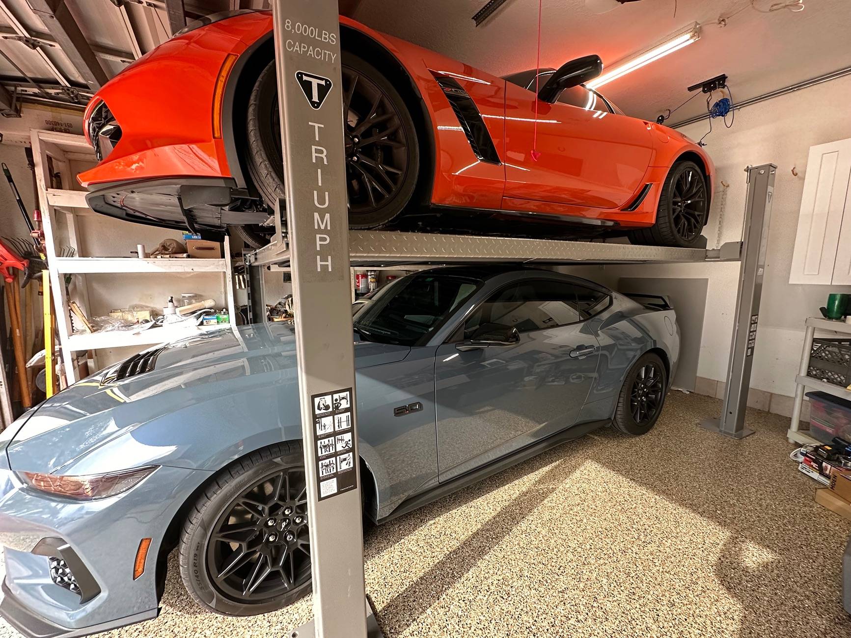

I have 9’6” and was able to squeeze one in but cars have to be low profile.

My ceiling hieght is 10 foot 7 inches which allows 6 inches from the top of the ceiling to the top of the 09 Shelby and 8 inches between the top of the 2024 GT thats under the Shelby.

Grabber, how are the lights holding up? Just had my lift installed and am looking for lights for it
Look for COB LED tape. The whole strip lights up, not individual diodes. 5000k is a clean white light. Much higher gets blue white.
