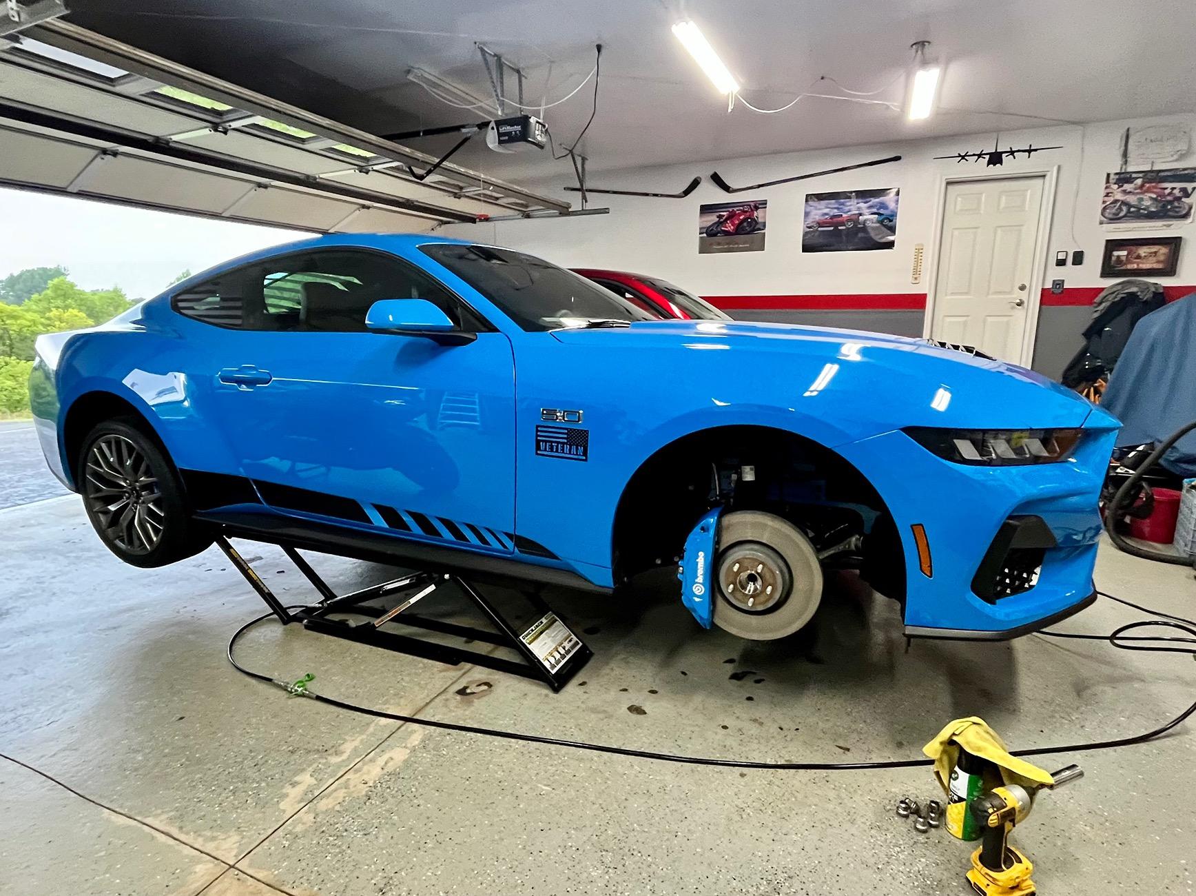

Just got a set of the 5000TL Quick Jacks from Home Depot. These things are awesome!!
I actually just ordered the 7000TL myself (I also have a 1 ton truck). Did you need the frame extenders for yours to lift the pony? I didn’t order them for mine, hoping I’ll be ok. Looking at your picture I don’t see the extender but hard to tell.

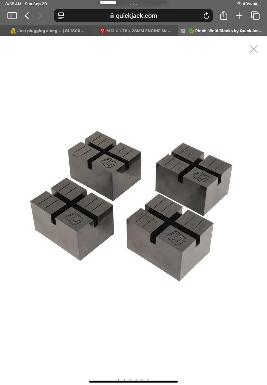

All I purchased for the mustang were the pinch weld blocks from quick jack. They have slots that fit perfectly under the mustang lift points. I ordered it all from Home Depot.
