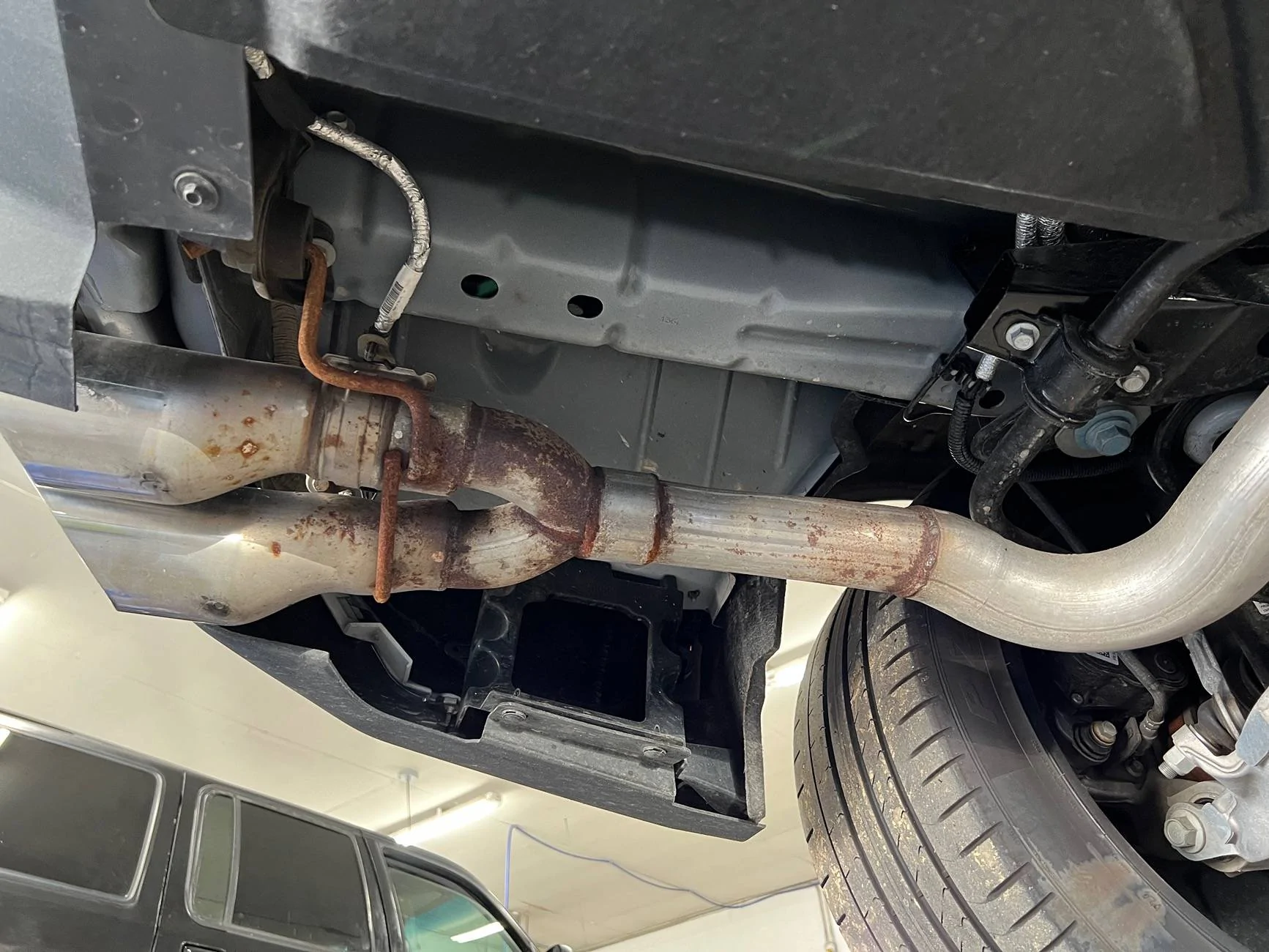

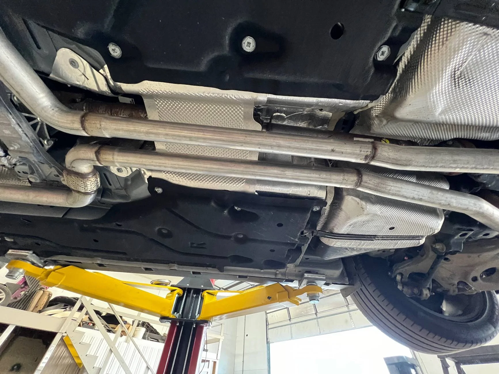

Was prepared to buy a 2024 White GT Premium, with PP, Magneride (they lied it didn't have magneride), active exhaust, 401a, with the red interior and nite pony package.
Got there, and it looked great. Started it up and it was INSANELY loud! It had active exhaust so I put it in quiet mode, and it didn't change a thing.
Had them put the car on the lift, and saw the previous owner replaced the resonator with two straight pipes, and deleted the mufflers. It was so loud I couldn't even hear my passenger.
Anyone have experience with this, curious how would this setup compare to a full cat back?
edit: Dealer tried to say it was normal. 🤣

I’d say that if changing the exhaust mode didn’t do anything, you’d have some work to do to make it livable. And, assuming it’s naturally aspirated it would likely have a pretty significant flat spot or dip in the power curve.

Just a crappy hack job that looks crappy, sounds crappy, and probably loses power w/o the crossover. Either buy a new cat-back and install or find someone selling their stock active setup (I'd give you my old if you were in the upstate SC area as I replaced mine with the Corsa setup). Either way, cutting/welding will likely be needed since they decided to cut/ weld the mid pipes. Looks like the active exhaust electronics are still there, so that's a positive.
