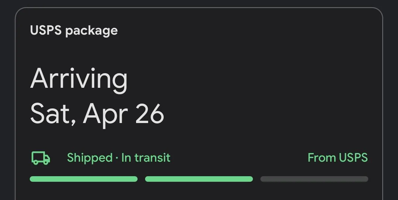

My new connectors will be here Saturday!
