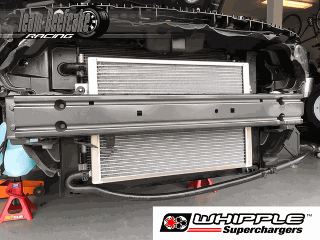

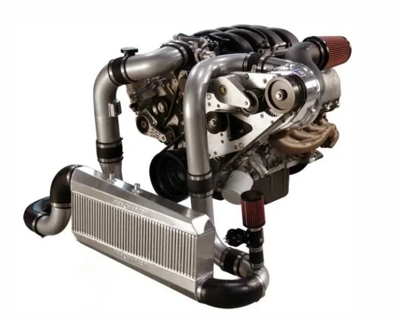

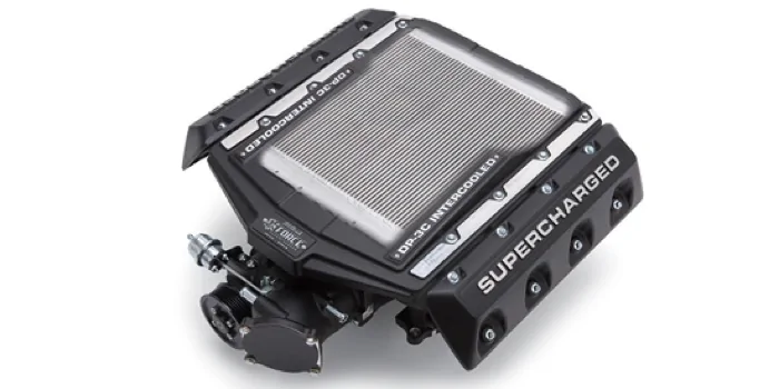

The intercooler is actually inside the supercharger on a positive displacement supercharger like the Whipple or Roush.
The heat exchanger (Roush calls it a low temp radiator, because the coolant never gets as hot as engine coolant) is the radiator-looking piece that goes on the front of the car.
Coolant gets pumped through the intercooler in the supercharger, into the heat exchanger where it is cooled off and then returned to the supercharger.
A front mount intercooler is the piece in the front of the car that the air from a centrifugal supercharger or turbo charger goes to cool off before entering the throttle body.

I live in the AZ desert and plan to install a Whipple. I don’t plan on racing it competitively but our summers do get hot! Is the HD HE necessary for street use?
I would not only get the big heat exchanger but I would also get an aftermarket radiator as well.
