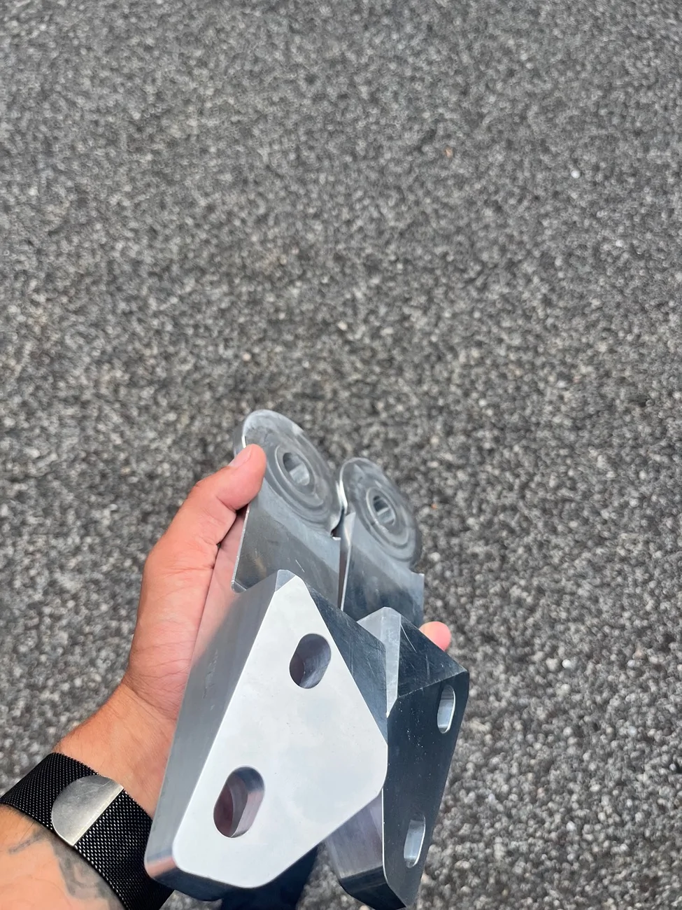

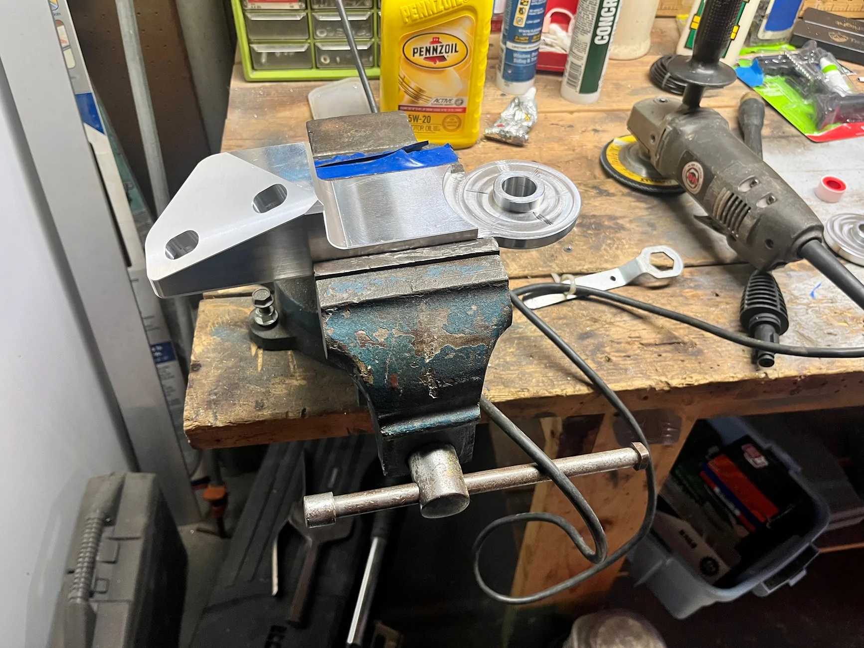

I ran into an issue last week. I have the BMR level 2 lock out kit. Great kit, although I found myself needing subframes bushings. No biggie, ordered the whiteline full replacements. Well the lock out kit won’t fit now. No problem, talked with UPR about their irs braces. “If the stock fit so will these” is the general statement I got. Well they in fact, do not fit. So I thought I’d share my experience and work around. I personally filed the pilots down to make them work.
